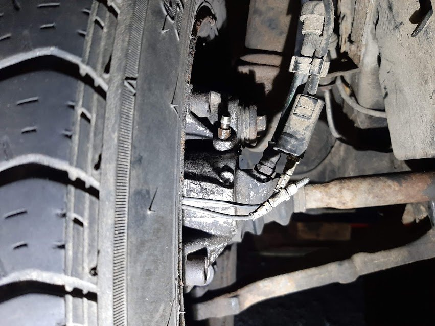

Today is auspicious... I finally got Daffodil's front bleed nipples moving without shearing them or otherwise damaging them 8-) :-D
Happy nipples
Happy nipples
Plus Gas and the same technique as I've used with great success in the past to undo Xantia rear brake caliper through-bolts worked :)
The technique is to use a big breaker bar on them and apply a lot of torque in a very controlled way... It sounds crazy to use a breaker bar on a bleed nipple but by gosh, it worked!

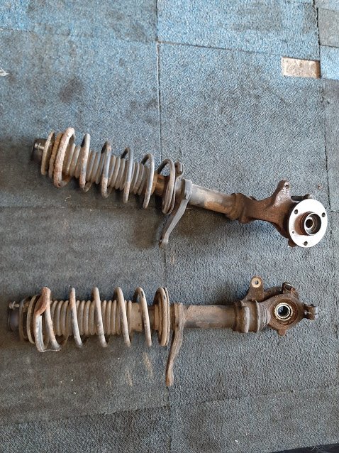

In no time at all both struts were out and ready for their bearing changes :D
Strutting their stuff...
Bearings aside, both struts are in remarkably good and clean condition... In so many areas Daffodil really does not look her age at all :D
The bearings are rough though...

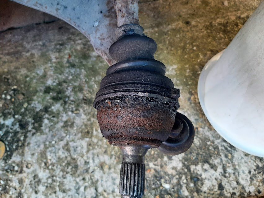

The RH driveshaft is very tired with a lot of play in the outer CV joint, no wonder there was a distinct clunk on taking up drive!
I guess the boot let go at some point and dirt and grit got in before a new boot was fitted...
Worn out...
Worn out...
I have a brand new driveshaft ready to fit...

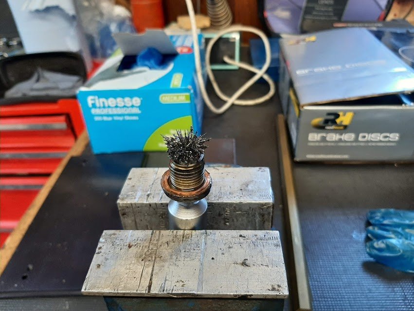

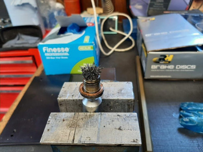

I drained the gearbox oil so that I could pull the driveshafts out and was pleased to see the oil looking clean and good :D
The drain plug has grown a very impressive 'hedgehog' :lol: Maybe it was Daffodil's pet ;)
Daffodil's pet hedgehog

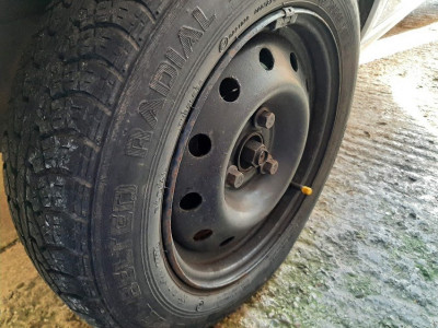

And here's Daffodil having to rough it outside tonight :( Poor girl, I'll have her back in her cosy garage as soon as I can...
Brrrrr...
Brrrrr...
