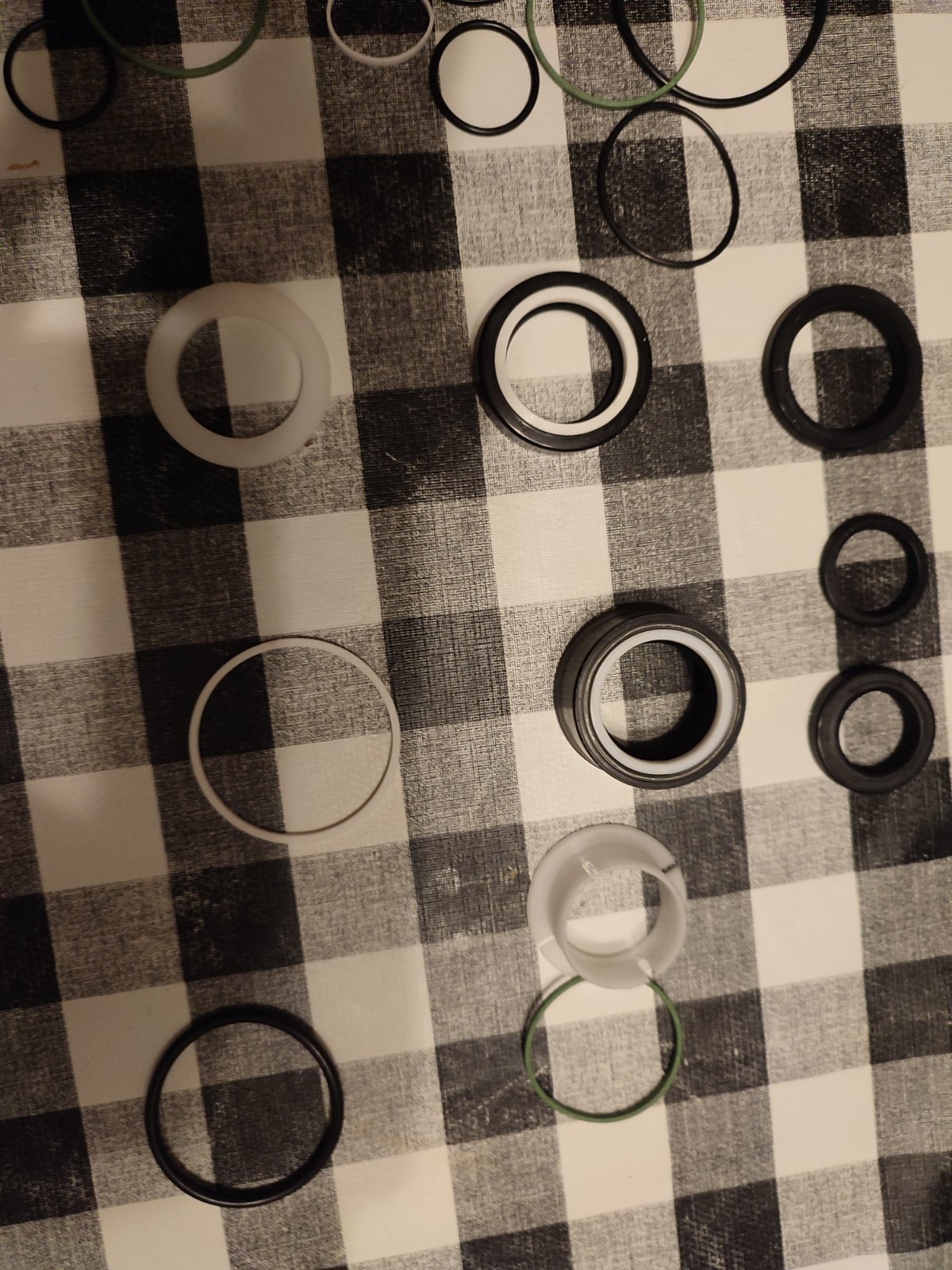

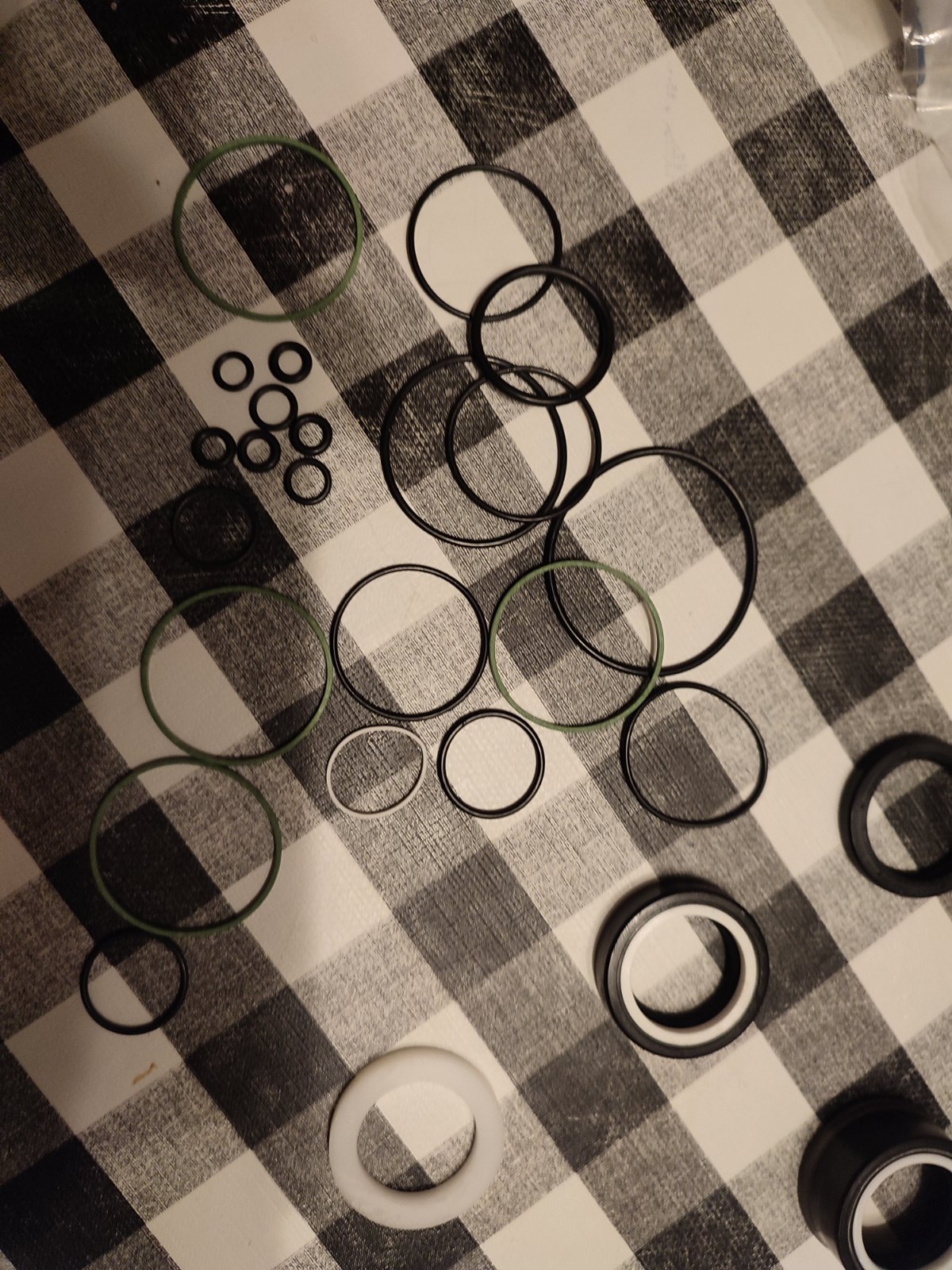

Seals arrived tonight so just need to take the rack apart again. The oil seals are all the right size so happy bunny.this is a kit for a 01 to 08 c5 for anyone who finds their x7 bleeding out via the rack.

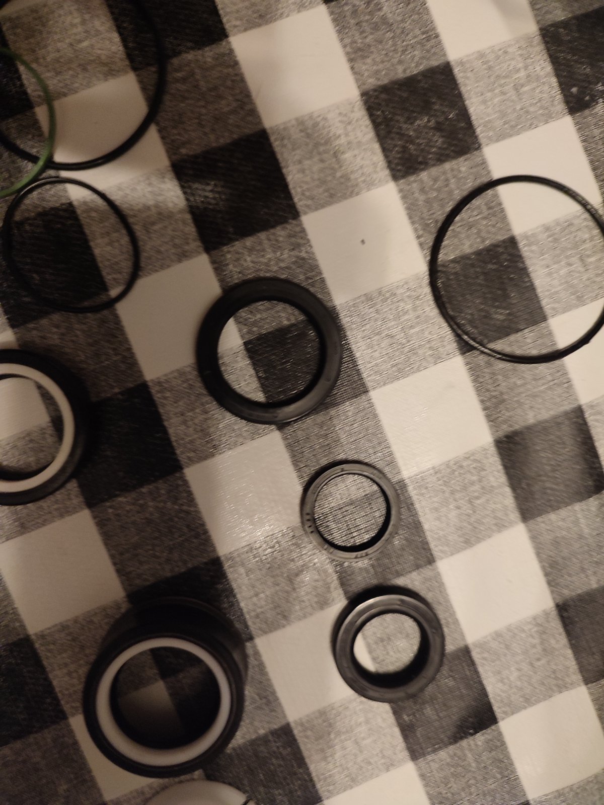

Ok lads tried to fit the seals the seal goes into the centre of the rack was too big by about .5 mm I got it it in but the shaft wouldn't slide in it. I think I can say that it's a fail 😭. I have decided to just buy another rack and hope it lasts a year or two with the mod to the pinion housing. I won't be wasting any more time or money on rebuilding a rack after this🍋. I'll drive her for a year or so and then sell on if anything goes wrong with it. I did however get the tailgate fixed so just tyres and a rack now.
