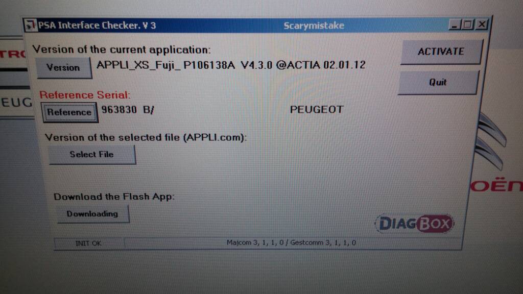

OK that's done.....I have
APPLI_XS_Fuji_P106138A V4.3.O @ACTIA 02.01.12
Ref Serial 963830 B/
x 6957
Re: Merged Lexia & Diagbox threads
Alasdair, just as well we checked - you have a revision B interface. This means it will not communicate with SOME vehicles, the 307 included (daft, as it can communicate with the X7, but it is very selective on which vehicles it will have dialogue with). Therefore I wouldn't advise upgrading the firmware until the unit has been flashed (if possible) to revision C. The unit may block come firmware upgrades until the EEPROM and MCU has been upgraded, so I wouldn't chance it until you decide if you are going to upgrade your kit or not. In order to use the stable version of Diagbox 7.57, it will need at least firmware version 4.3.2 and yours is 4.3.0.

Managed to get it up to v6.35 without any hitches. Not sure whether or not it needs internet connection for authentication but .... here's photo of my 'interface checker' output
Looks similar to mr sticky's version, yes?
