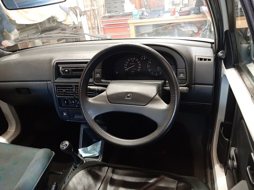

Speaking of Daffodil, I did plan to both reassemble her dash and make a spacer for her rocker box baffle on the lathe but the job of reassembling her dash turned out to take a LOT longer than planned
Reconnecting the speedo cable was a game but I now have it sussed
Here's Daffodil's dash all nicely back together
If I need to pull out her instruments again I'm not worried as I now know all the tricks and how to do it

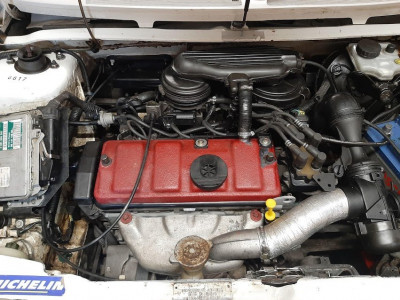

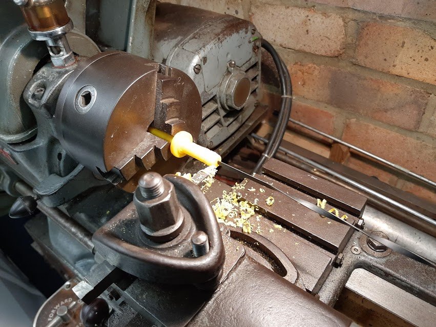

It's been a few days since I've had an opportunity to do a bit on Daffodil but this afternoon, after completing a lot of essential tasks to leave the weekend totally clear for a half marathon run tomorrow morning in Salcety Forest and a duathlon on Sunday (10K run followed by a 40K bike ride followed by a 5K run), I had a bit of spare time to devote to her

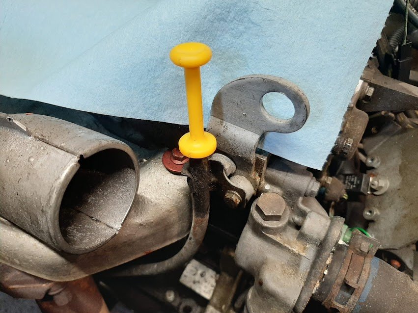

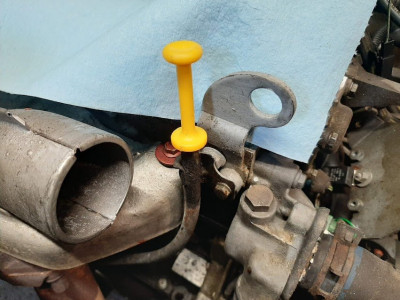

First up was her dipstick... Her old one had fallen to bits. I obtained a replacement for which I was assured was for an AX but on looking at it, the shank (yellow bit) was a bit too big... Maybe it was for a diesel AX...
No worries, I popped it in the lathe and made it right
Looks a proper job in the engine

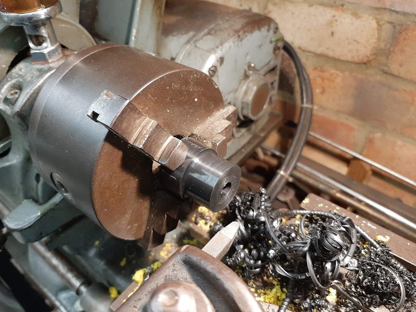

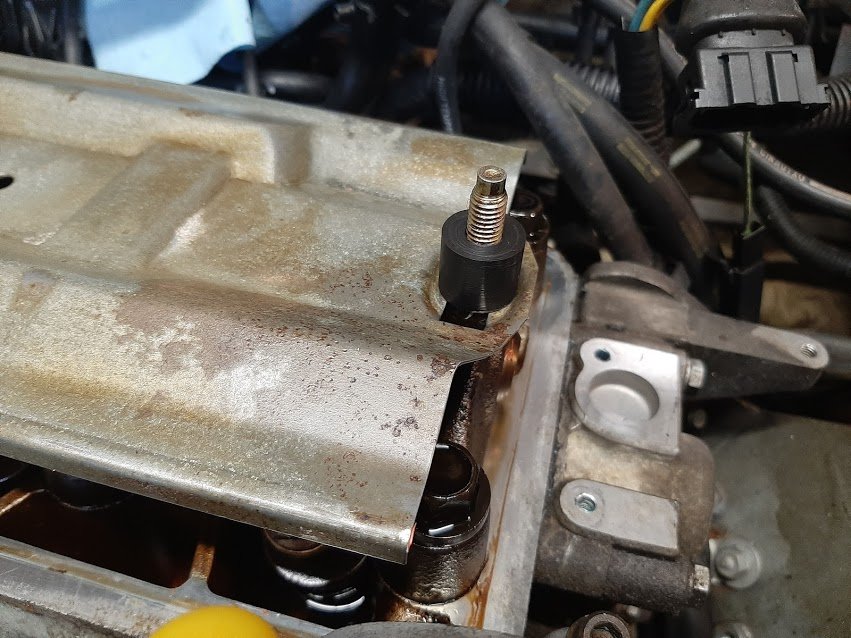

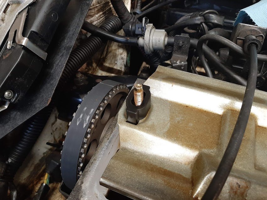

Next up was to make a substitute rocker baffle spacer..
Here it is in place. It looks different to the pukka one but it does the job...
I must check it's happy after a few long runs... It's made of Nylon66 so it should be OK...
Here's the proper one...

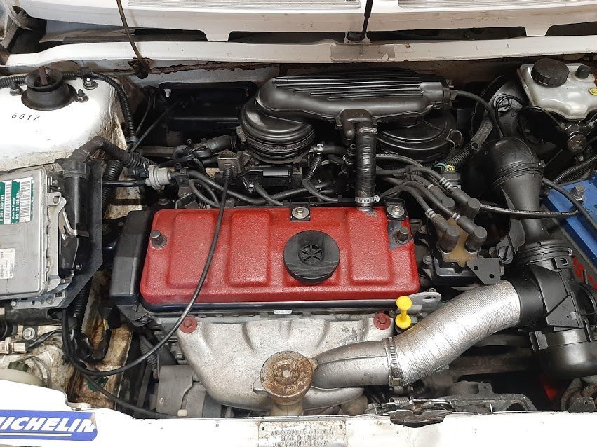

After checking the valve clearances, all OK, I reassembled with a new rocker box gasket...
I now have a nice quiet oil-tight engine

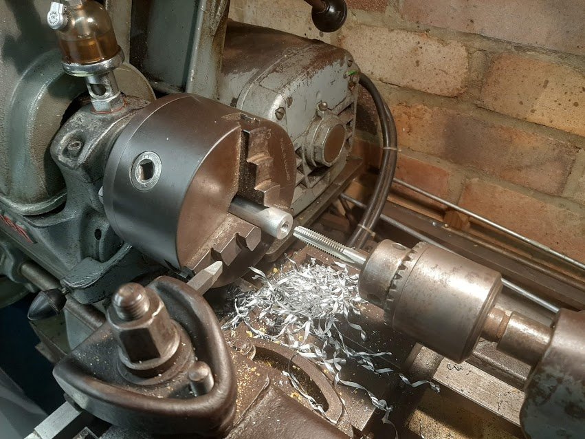

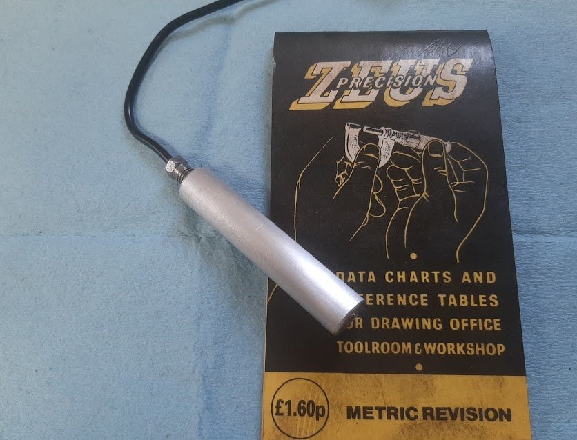

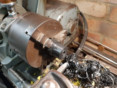

The next job was to make a pair of 3.5mm Citroen hydraulic pipe couplers to allow some new pipe to be spliced into a long corroded run on a friend's rather desirable Xantia 2.1TD Exclusive estate...
My lathe saw some action
To help produce this:
After making one I ran out of raw materials and need to procure some more... eBay will provide
A good day well spent

Re: Citrojim's AX, Saxo, Pixo, Running and Cycling Tales
Aluminium this is?
Xantiae's anti-sink and height correctors resemble some kind of aluminium casting compounds, so probably drawn, non-alloyed aluminium is ok for a coupler, but if I had a lathe like this I would use some kind of mild steel
Only himself the stupid makes wrong, many are being confused by the clever
- Posts: 55143
- x 8422
It was the material I had to hand! The aluminium, I know from previous work, will be fine, given the wall thickness and will last well. It will need proofing from electrolytic corrosion though... The owner of the car these couplers are destined for is well aware
I've also used brass in the past with equally pleasing results but for this application it's overkill...
Along with height correctors, hydractive electrovalves are made of quite thin-walled aluminium... As are rear suspension cylinders...
Aluminium is easier to machine too
