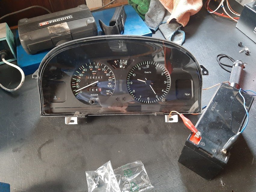

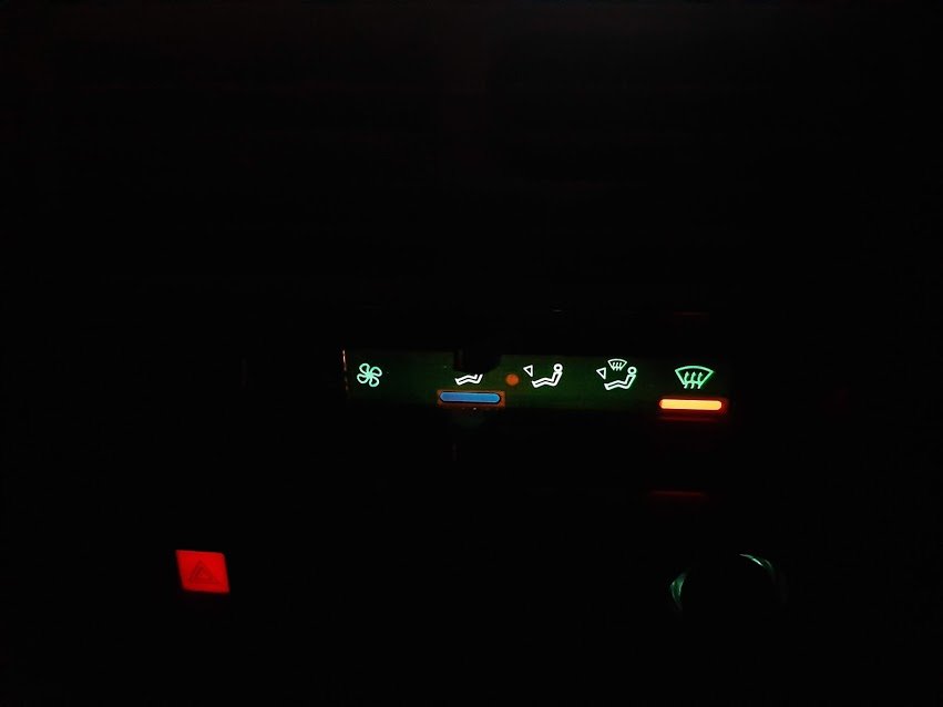

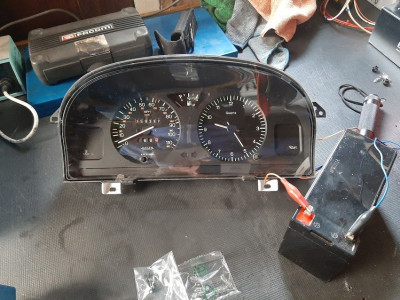

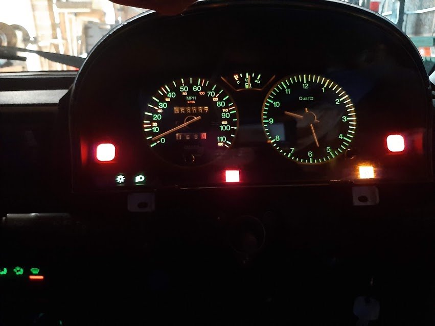

This afternoon I've been replacing blown bulbs in Daffodil's instrument pod and heater panel
As she's a Citroen, the job was not straightforward
I bench-tested the pod before letting it back near the car...
That looks good
Even better
And the heater panel is now nicely lit... It was previously totally dark...

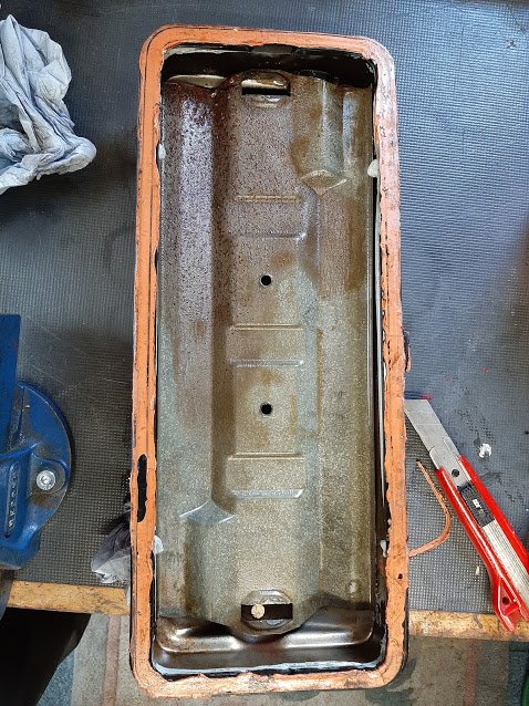

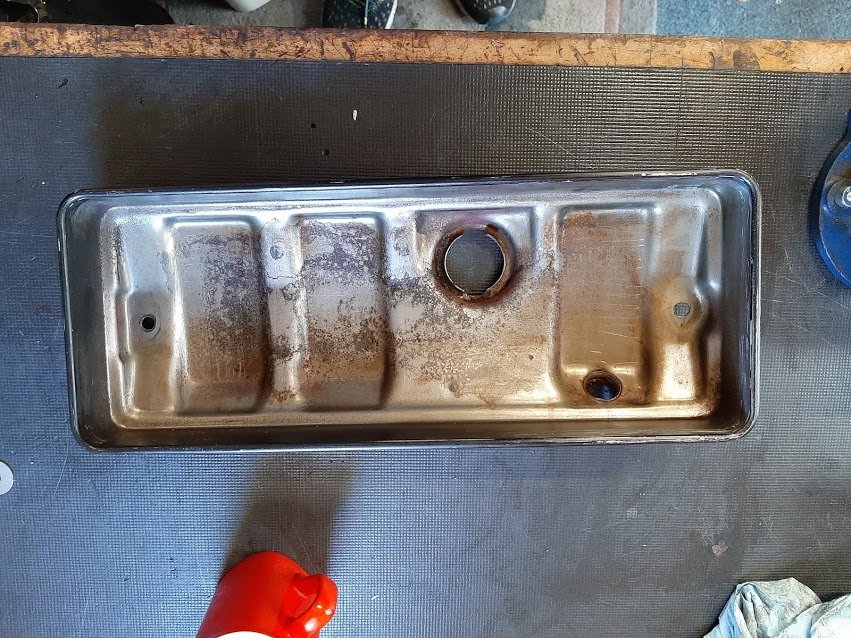

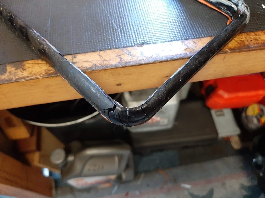

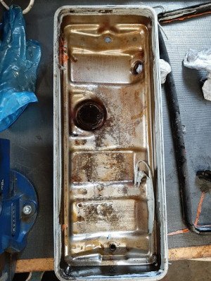

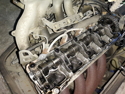

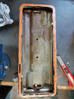

Today was rocker box gasket day for Daffodil
What a job!

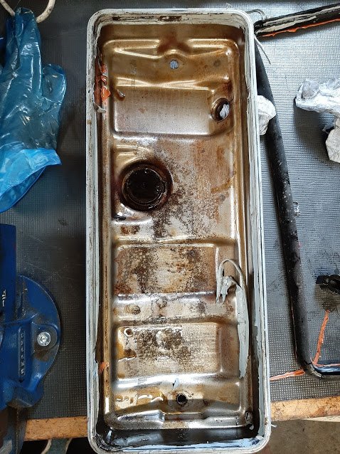

The old gasket had gone hard and was cracked...
To extend it's life a good deal of silicone sealant had been used on it in the past
It was top-quality stuff and it took me hours to remove it all
I then cleaned everything up, including the baffle and rocker box itself

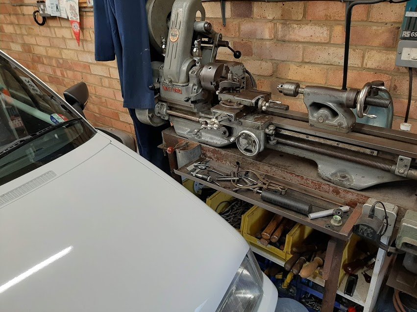

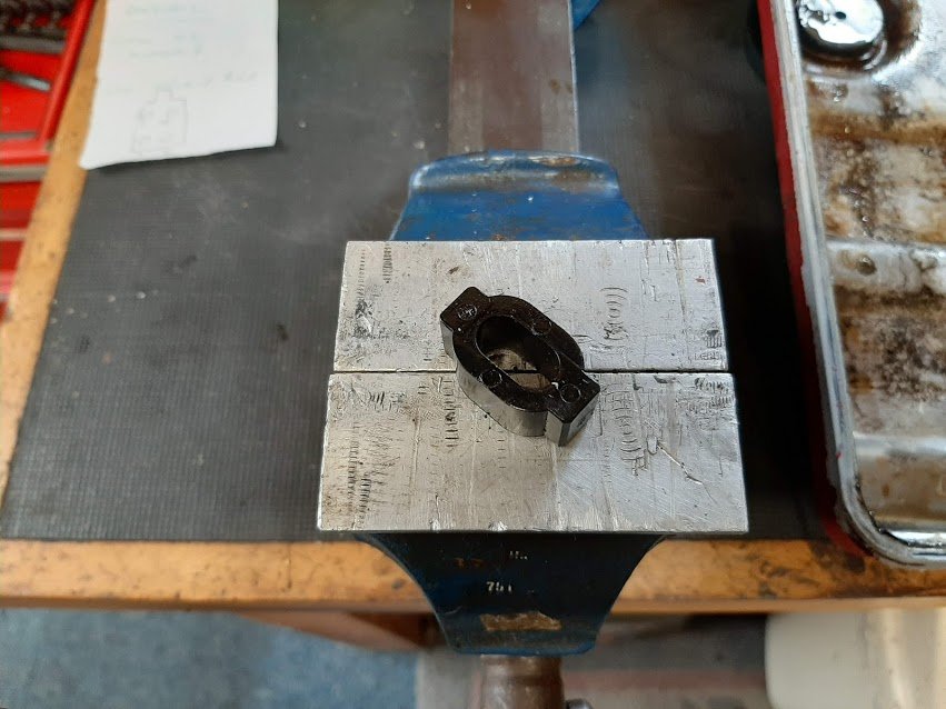

In the process I found a one of the spacers that hold the baffle tight was missing... This may account for the odd little rattle I have at slow idle...

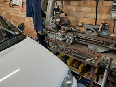

I will have to fabricate one on the lathe but that means pushing Daffodil out of the garage...

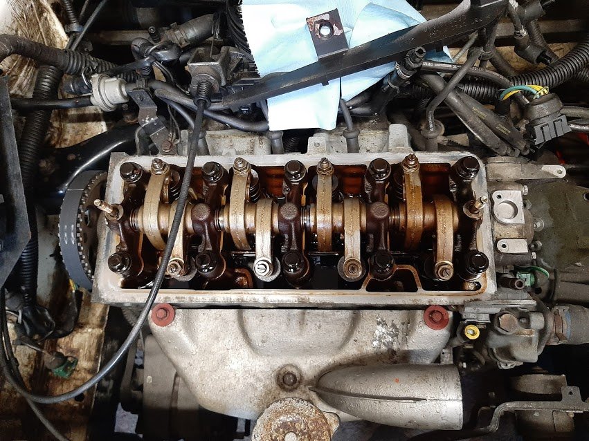

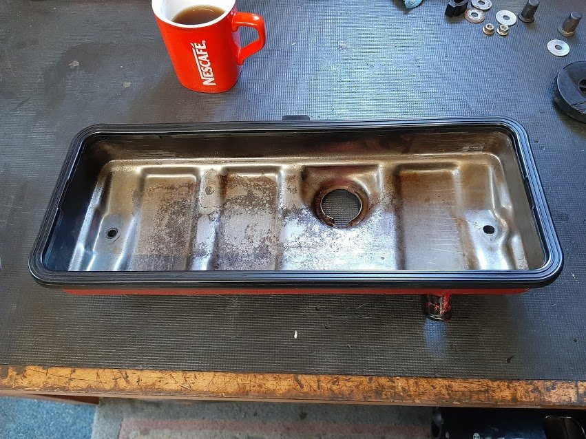

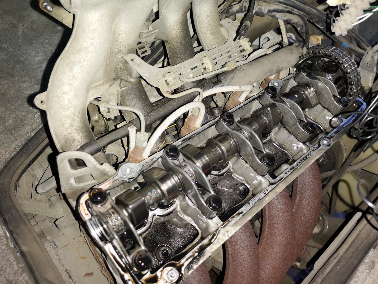

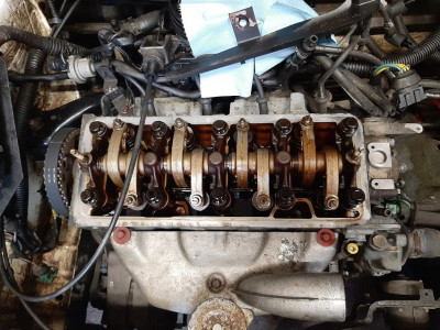

I was pleased to see the engine is nice and clean inside

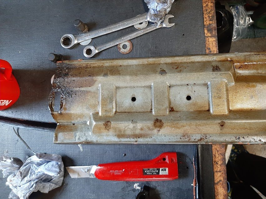

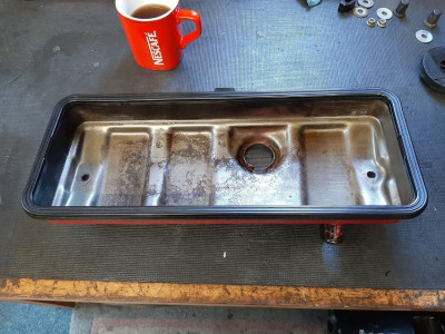

And here's the rocker box all clean and with a nice new gasket - all ready for refitting
As always... To be continued

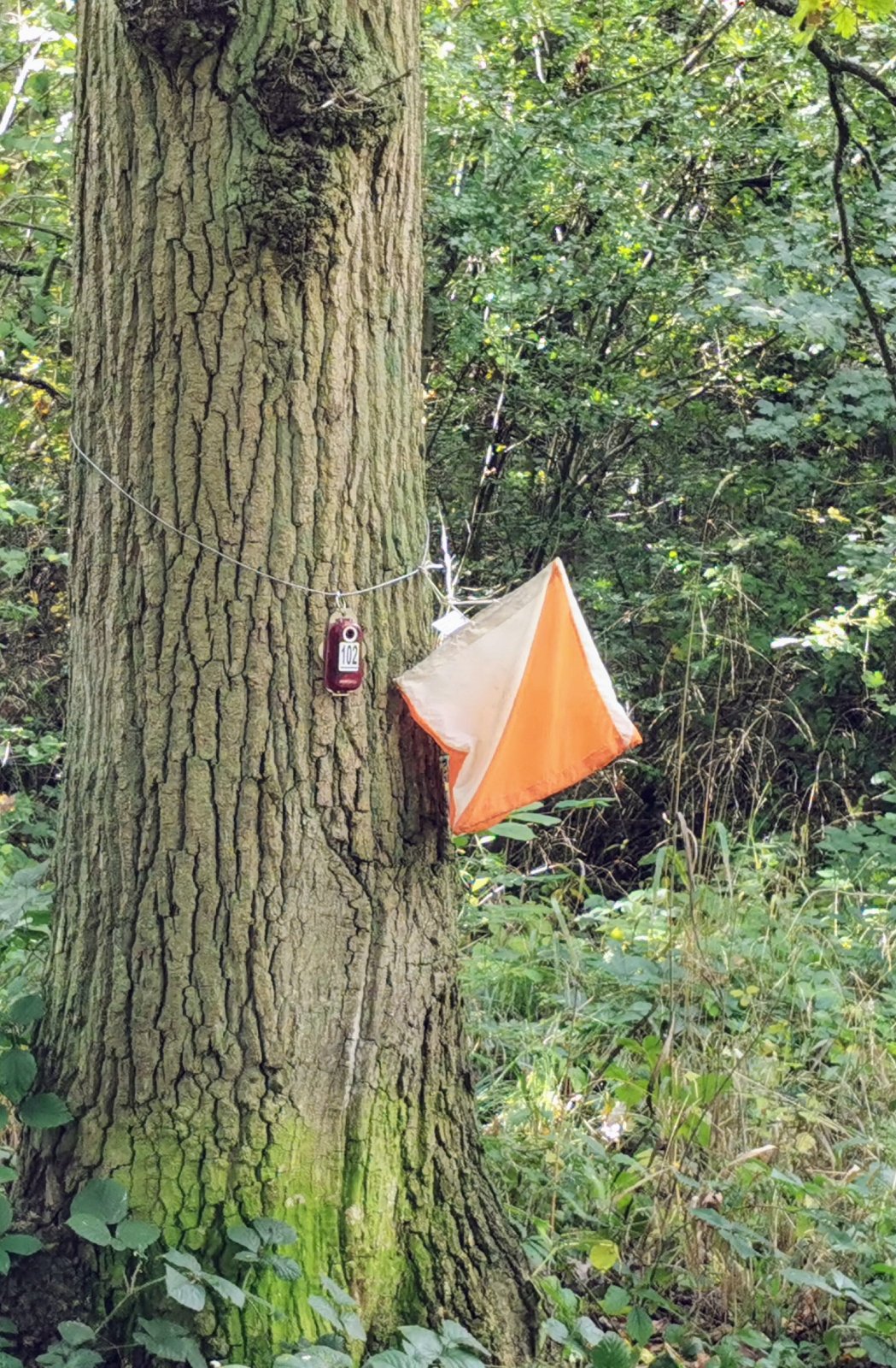

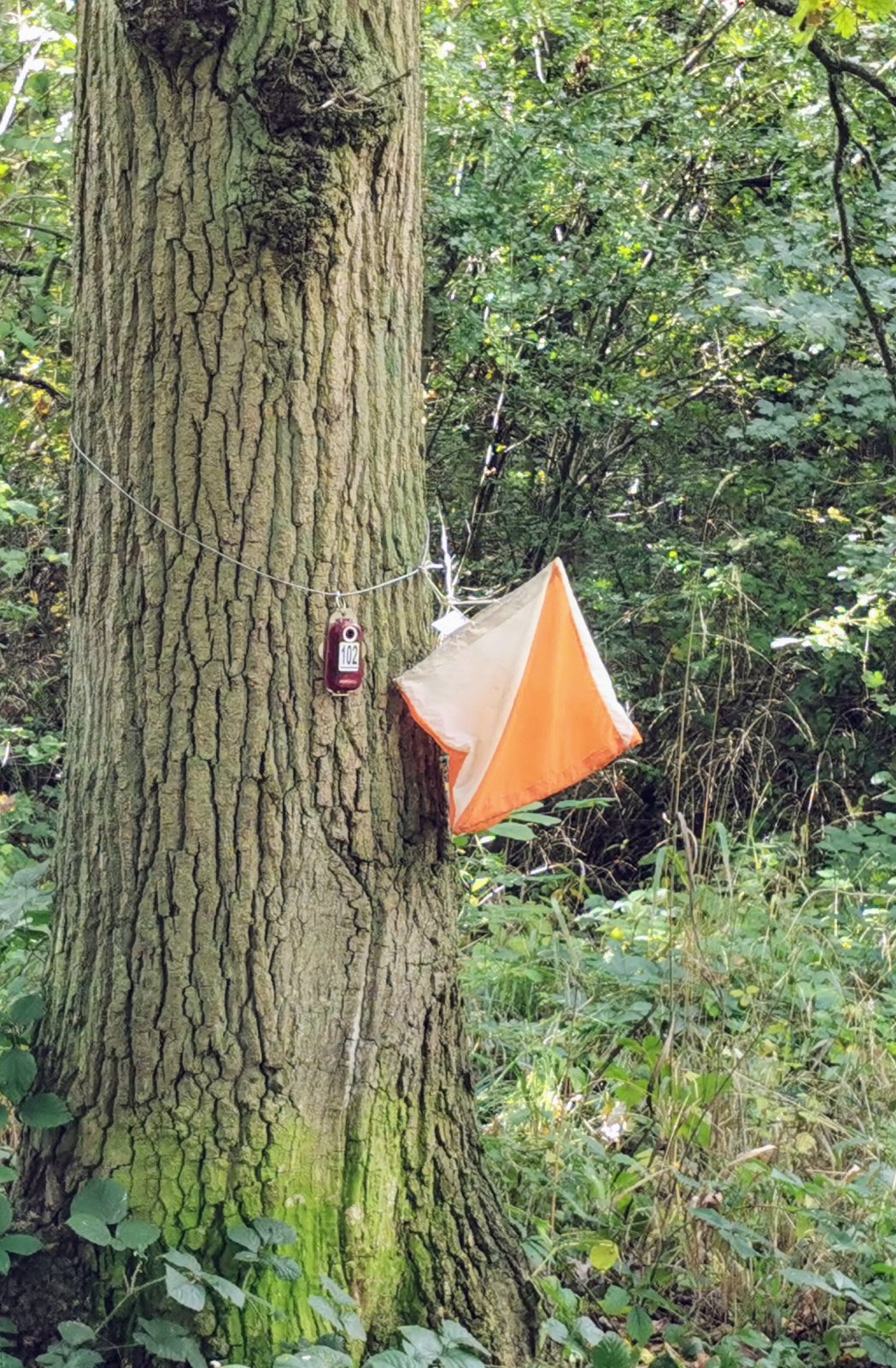

I'm assuming these things spotted dotted over Linford Wood at the weekend were something to do with one of the running events in the area? Figuring that if anyone would know you would, Jim!
Makes a change to find something new there other than abandoned electric scooters.

That's an orienteering marker, the thing hanging next to it is a punch that is used to mark the card to prove you have been there.

I can add a little bit more (yes we have weird Swedish sports in Australia as well as weird French cars!). I have set a number of orienteering courses, and although the course setter checks the control sites in advance, the flags are typically hung at the last moment, and pulled in again quickly after the event. This minimises the chance of flags disappearing, which rather spoils the fun. It also minimises the chance that competitors who might be training in that area could gain an advantage by learning where some of the flags are before the official competition.Zelandeth wrote: 12 Oct 2020, 10:36
The thing on the left is an SI (Sport Ident) unit, which replaces the punch and card mentioned by Richard (so last century!). The SI unit is programmed with the control number and the time and date. Instead of a punch card, the competitor carries a micro-chip encased in an elongated plastic stick. The competitor uses a map with all the flag locations marked on it to find each flag in turn. On finding the flag, he/she plunges the stick into the hole in the SI unit. Using the magic of very short distance wireless data transfer, the control number, time and date are "stamped" onto the microchip stick.
At the finish, the contents of the stick are downloaded onto a computer. The winner is the one who visits all controls in the right order and in the quickest time. The SI system makes cheating virtually impossible - not that orienteers would cheat, as they are all jolly good chaps
