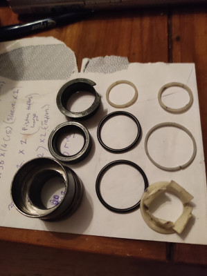

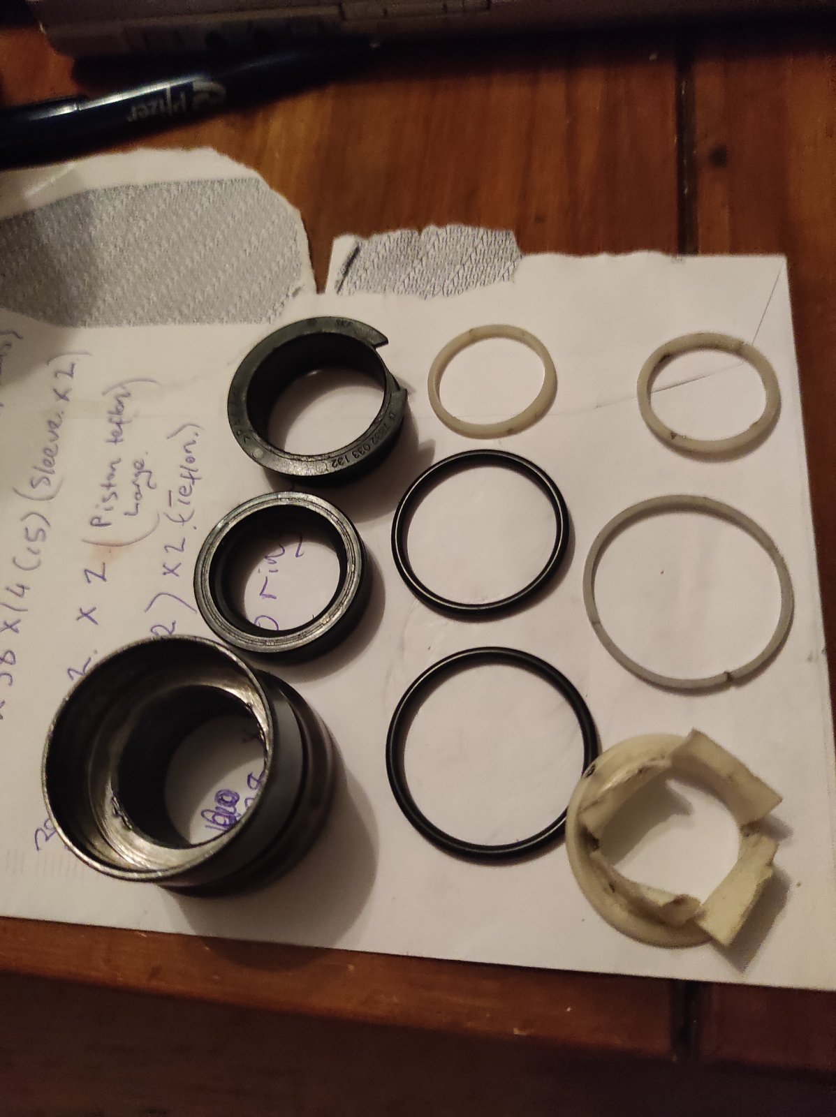

Right I pulled the rack again and the pinion seals held perfectly the main body of the rack was full of grease and lds soup very appealing not. I didn't take pictures because I didn't want to destroy my phone to be honest. There is a plastic sleeve bearing with an oil seal on it in the centre of the rack the usual teflon seal on the piston and a second sleeve bearing and seal in the end bushing which is pig to remove. I destroyed it last night and set fire to it with the map torch the end bush is steel so it should have expanded enough and the cooled naturally for me to remove when I get home without affecting the metal too much. I tried drifting it and pullng with picks all the usual stuff but to no avail I will get measurements later and source the bits to rebuild it.

I have all the seals out and I now have seal sizes.I will get correct measurements tomorrow I need to do up a drawing for the sleeves I came across a chap that can make up the two sleeves for about 40€ delivered to Ireland. I just need to find a st of teflon and reciprocating seals and I should be good.

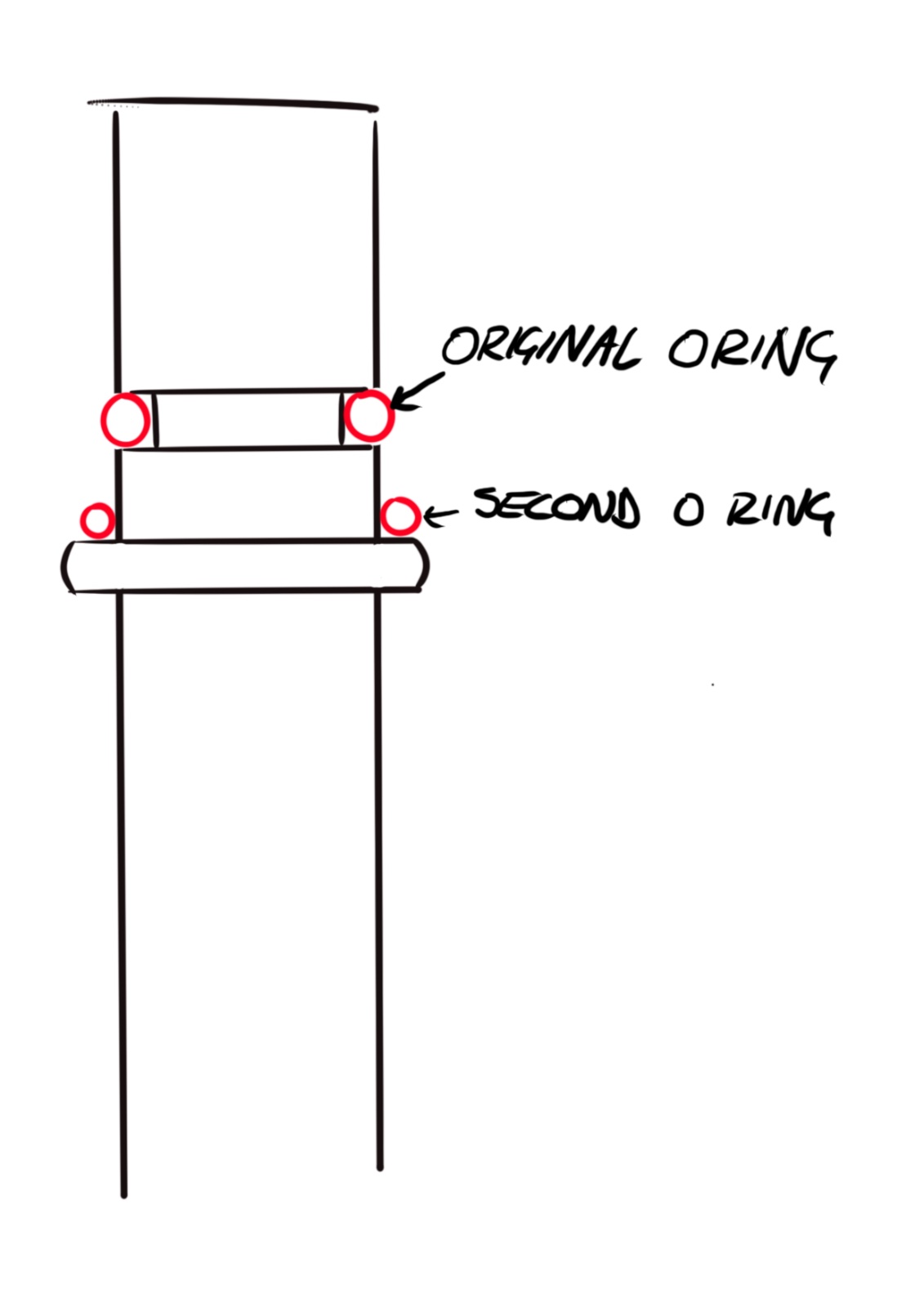

I’m also considering introducing a second o ring on both pipes, diagram included. What’s anyone’s thoughts on this?

Seems to be two routes for leakage from these pipes:
O-ring
Solution seems a slightly "fatter" section O-ring than standard (sat in original groove)
Pitting type corrosion to the pipe itself leading to pin holes
Commonly leaking after pipes disturbed, the stress of yanking the pipe out of the rack sufficient to initiate leaks from the weakened pipe. (Solution: new pipe)
Berlingo? Pipes have been mentioned but I agree with you, if they are the correct dimensions then should be suitable. The joint to rest of the pipe will be the question to answer.

Fatter o ring I’ve tried, seems ok to start with but is soon back to leaking
The aluminium pipe seems to be the main culprit and (unless someone wants to correct me) that’s the low pressure one, so I’d assume that if a berlingo one fits you could just chop it down and use some oil/fuel line and a good jubilee clip from there on.

The pipe could blow even though it's low pressure side it's still high enough to blow off a jubilee clip I would imagine. I would look at flaring the ends and putting in proper threaded fittings if I was cutting the pipe. You risk dumping a litre or so of lds all over a public road by just using a jubilee clip and losing power steering aswell and possibly burn out the pump which could cause a danger to others. believe me I understand your frustration but I always consider safety first with these kind of mods.

It IS a low pressure return, BUT it will be a high (localised) pressure as it pulses volume out of the rack hence it can blow the joint/loose a lot of LDS from that joint area.

Well…… my second o ring idea didn’t work
I have found a decent condition pair of second hand pipes on fleabay, I’ll try those in the meantime which also means I’ll have a pair spare to play with. I might give them to a high tech engineer friend of mine and get him to manufacture a pair of the ends and maybe change them a little, might get two o ring recesses cut in each, possibly make the recess a little shallower for a tighter o ring fit and get the aluminium one made out of steel. Then I’ll get pirtek to manufacture the rest of the pipe.

You might get away with it but I would be wary, normally hydraulic to rubber hoses are crimped for safety reasons and because clips don't normally hold in those kinds of applications.
If you know someone who can make up hoses you might be better off going that route instead.
Given where you put the second o ring I think it was pushing the pipe back from its seating position resulting in a leak unfortunately.i wish I had a quick solution for you but I think the rack and pipework on these needs to be altered to threaded fittings.
