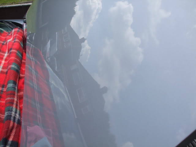

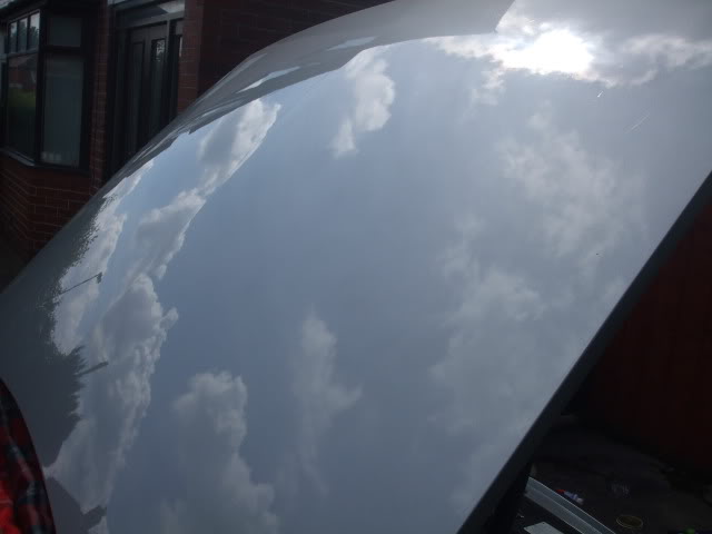

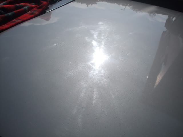

Well here are the pictures i took from this morning....not very exciting per say but Mark you wanted pics :)
How the bonnet looked in the sun this morning after washing and drying.....
The laquer was surprisingly hard and therefore needed some pretty hard action even with the rotary polisher. After a couple of passes with a hard compound and pad combo i managed a 95% correction which i then refined back with the DA polisher and a finishing combo pad and polish. Topped it off with Collinite wax.....
After rotary polishing

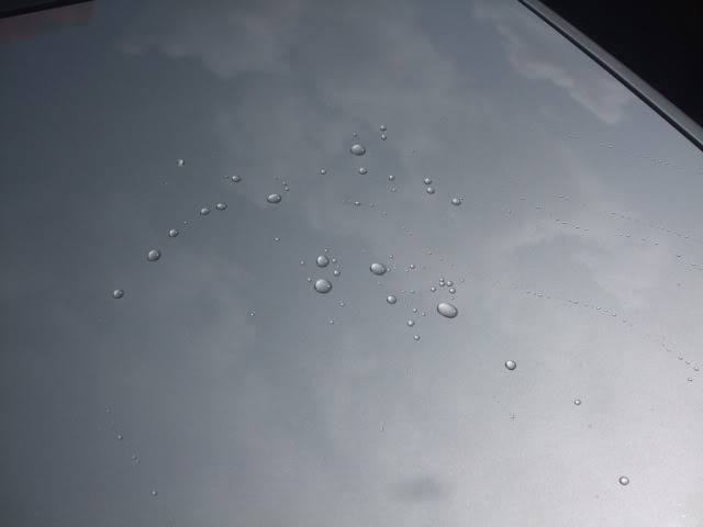

And waxing to seal in the finish until the next machine session to correct the final 5% that needs doing before the CXM :wink:

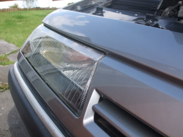

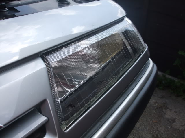

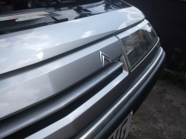

I then flatted and polished the headlamps and nosecone area.....it looked pretty good at the end i thought

That is looking excellent Vince 8-) Though headlights do look brand new! It'll be like a new XM for CXM :lol:

Thanks guys, but trust me until some body issues get sorted further down the road, it will look shiny, but will still have a dent in the rear quarter and scuffed wheel trims that need a refurb :wink:
Chris, the headlights i sanded very lightly with 2500 wet and dry paper, but with the paper dry! I then compounded them and finished them back up. I wish you could feel pictures.....i couldnt stop touching the glass :lol: it is as smooth and clear as a new headlamp :)
