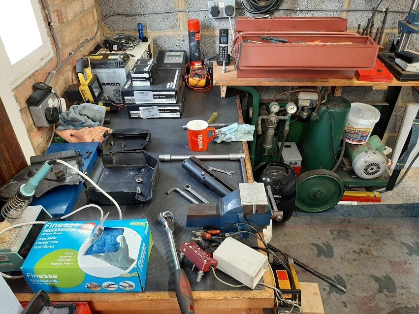

Been busy with Daffodil
Still loving getting the spanners out and absolutely loving having a project car with a few issues that need resolving

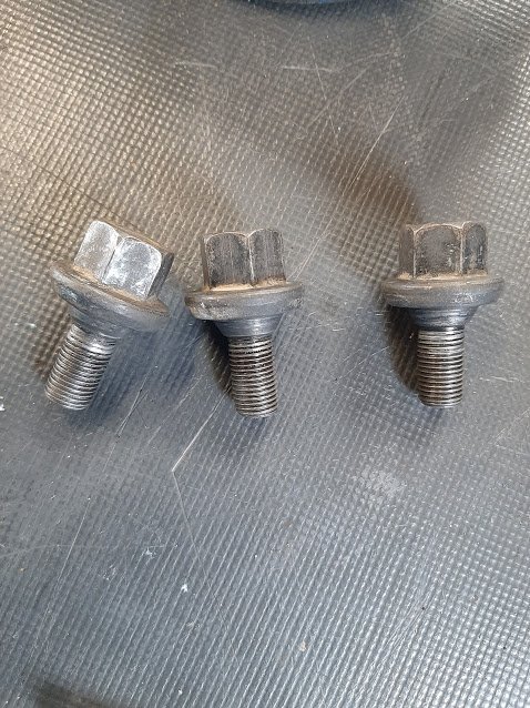

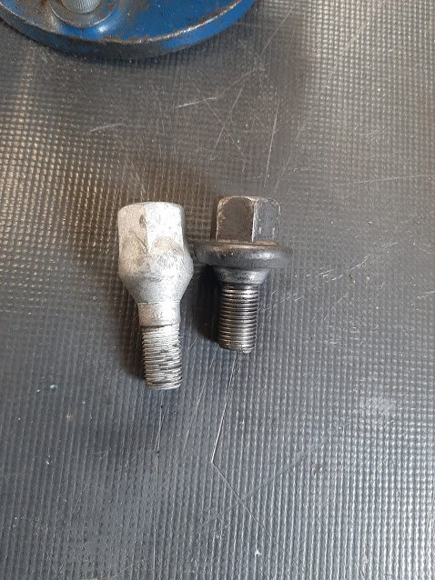

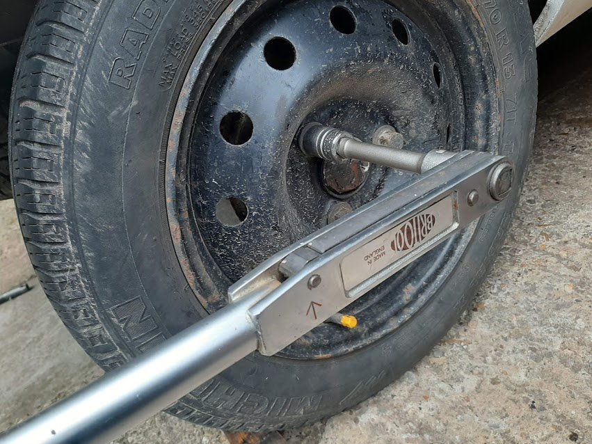

Just after her last MoT her rear LH wheel came adrift. It made both Alasdair and I a bit cautious when driving her and on my way home with her I checked the tightness of the wheel studs several times!
Yesterday I looked into it and found the studs reassuringly tight but upon removal some thread damage right at the end by the taper was evident...
This suggests that the studs worked loose at some point and the wheel rattled against the threads as they got looser and looser...
This also slightly damaged the threads in the brake drums too but a 'clean up' with a tap and a die on the studs and drum threads have made them more or less serviceable...
I did get some new studs but they're not suitable as they have a shoulder before the taper... I guess they're for a kind of alloy wheel. No worries, they only cost pennies... I now need to source some specifically for steelies...
Happily, there's no rush to replace the drum and the studs as they've torqued up fine and are unlikely to come loose again. I will keep a frequent check on them though
This does underline the need to check these thing regularly, especially on a three-stud setup! There's no understanding how they came loose as not long before the car had been given an extended time on the MoT brake tester getting a clean pass on her rear brakes!
Just one of those things I guess... But as said, a good object lesson in the need for regular checks.
I checked the RH rear wheel and happily, no problem there at all

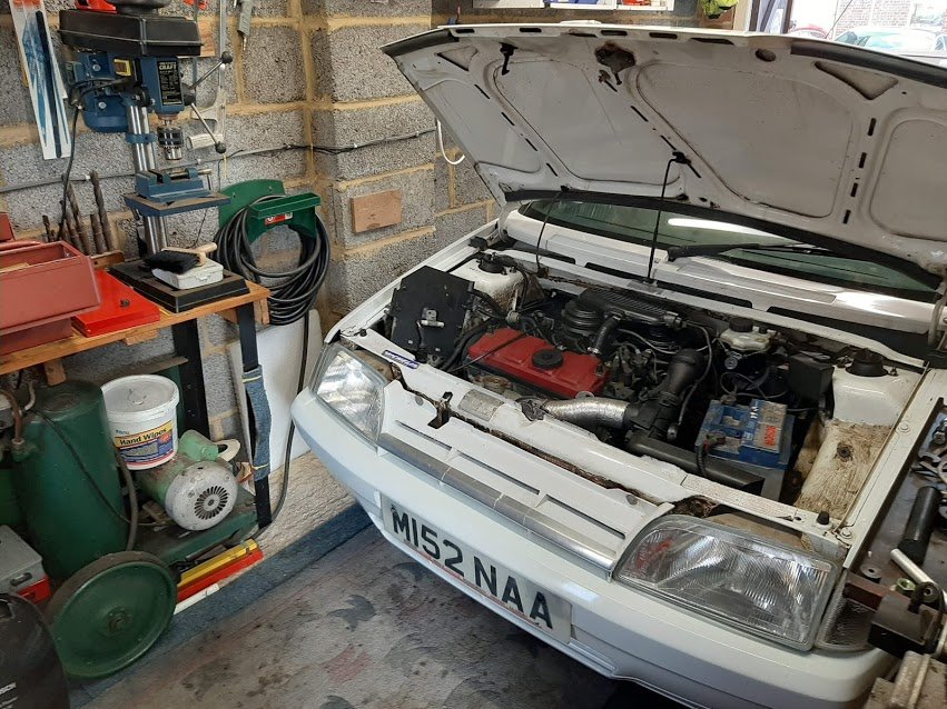

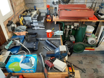

Following the change of cambelt the other week, I started noticing a tiny rumbly noise on low idle. The noise is such that even the smallest increase in revs causes it to disappear. As it might have been cambelt tension related I checked that today, fearing I may have over-tensioned the belt...
What a joy it was to be able to work on Daffodil indoors
And in a carpeted workshop too! Sharp eyes may notice I've moved the compressor a bit to give just a little more room... I have two inches of clearance on the bumper corner rather than the half inch previously
And a bench right behind me!
It's not the cambelt tension... So that's a bit of a relief... I now suspect it may be an alternator bearing...
More work needed... Just as it should be on a project car

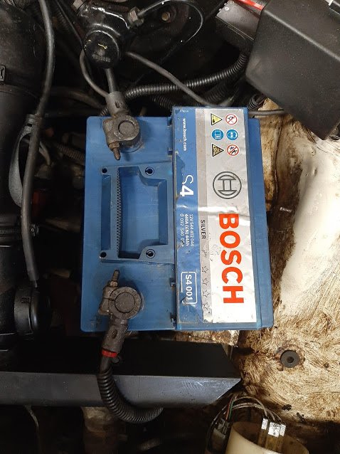

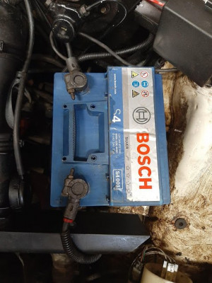

One thing that was annoying me was the filthy state of the battery... I gave it a good clean and it's now much better
I later learned it was used to power an electric fence for a while
I did wonder why it had some straw around it!

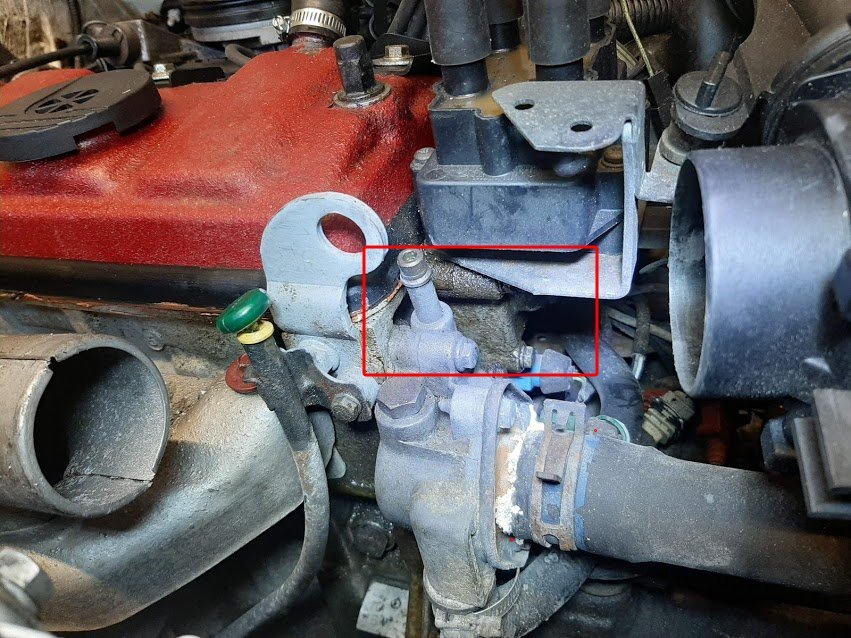

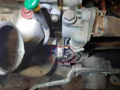

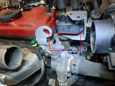

I then discovered I had a small oil leak... Wet oil spotted down on the bellhousing web...
And wet oil high up by the rocker box gasket...
It looks like the rocker box was leaking due to the right hand securing nut being quite loose...
I've given it a little tweak and hopefully now all will be good... If not, I'll replace the rubber rocker box gasket.... After all these years I'm sure it's not as soft and pliant as it once was!
At least it's not the head gasket leaking

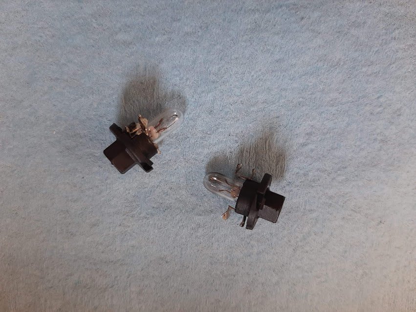

It's been a bit damp down here today and one lovely thing about Daffodil being in a nice warm garage is that I can do little jobs on her whatever the weather

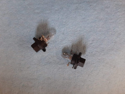

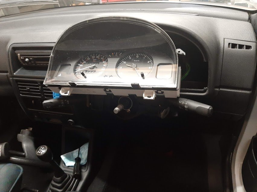

So, today seemed the ideal day to replace some blown bulbs in her instrument pod... An improperly lit pod really does niggle me
How hard can it be? Daffodil's a little AX and not complicated...
The job of replacing the heater illumination bulbs was easy
That's a good start!

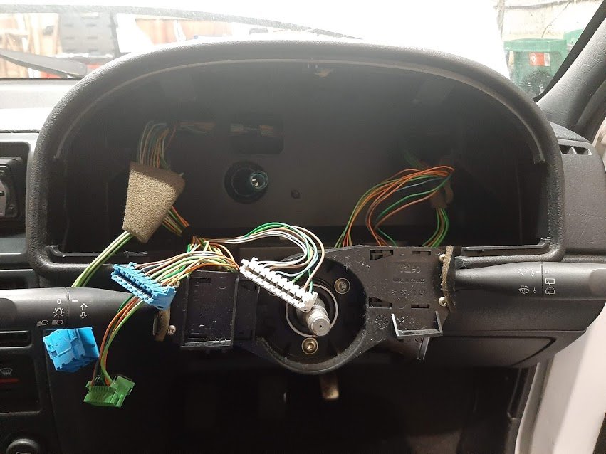

This first picture gives a clue as what needs to be removed even before you can start to remove the instrument pod
Yep, just as in an S1 Xantia... Steering wheel and cowls along with a number of barely accessible screws
The steering wheel put up a fight!

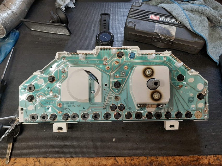

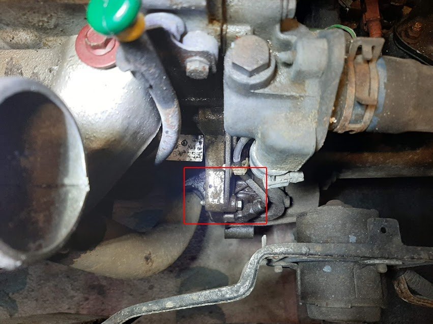

Then it should be easy but.... Daffodil has a mechanical speedo so she has a speedo cable... It's so tight that it will not allow the pod to move more than an inch and there's no obvious way to get behind it to disconnect it...
Consult the Internet. 'Disconnect the cable at gearbox end and feed a few inches in to allow the pod to come forward...' Yea, right... That might work on a left-hooker but no way on an RHD car... I have 'form' when I once tried to replace an XM speedo cable and nearly scrapped the car it was such a pain to 'feed a few inches in'
Consult the BoL even though my BoL is for an S1... 'Reach up behind the instrument pod and disconnect the speedo cable...'

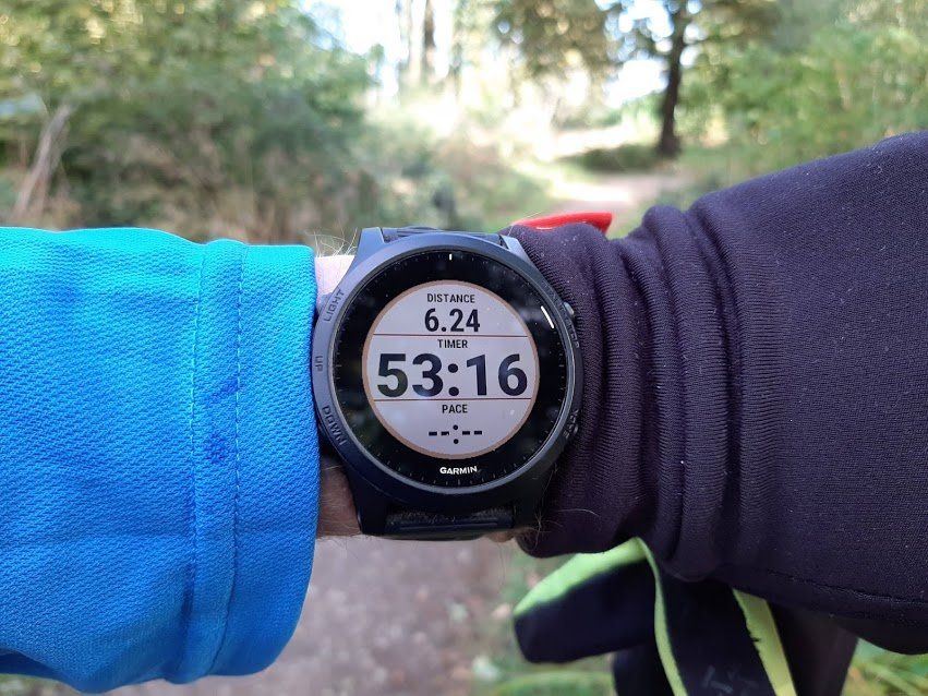

I did remove my Garmin before putting my hand up there

Then, when I look, I find two different types of bulb and a very fragile PCB that looks like it will break with the least provocation
One type of bulb I don't have in stock but it looks a lot like a Xantia heater panel bulb... Can anyone identify the type of bulb this is please?
As much use as a chocolate teapot
I found it was indeed possible to get one of my girly hands up behind the pod by going in from underneath... I could feel the cable but could not feel how to disconnect it... I assumed it was clipped on a cone so gave the whole pod a determined pull forward... Success! The cable popped off
The speedo cable end can be seen here:
What a bloody job... Literally... Look at my arm where I went in to feel for the cable
To be fair, I have very thin skin and these harmless, but nasty looking, blood blisters happen very easily to me...
Needless to say, there's not much room to get your hand up behind the pod and I'll have to do so again to reconnect the speedo...
Oh what fun it was... It just goes to prove an AX is a genuine real Citroen full of Frenchness just like her bigger sisters
It's a good job I love her

They look the same as BX panel bulbs as well, I think they pull out of the holder, sometimes damaging the 2 filament wires that make the connection.
