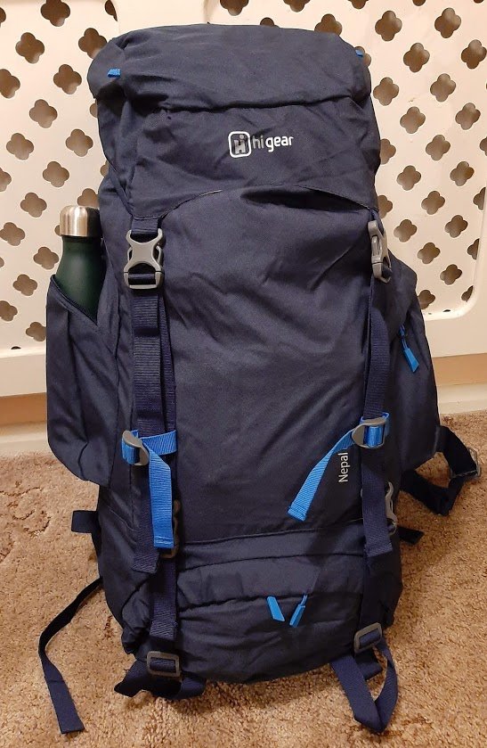

All packed and ready for adventure...

Neil, I'm going for a few days and need to be self-sufficient 🙂 Rucksack contains some car bits as well as my human needs 😉 I'm also giving this rucksack a good test with an eye to more daring adventures in tne future 😉

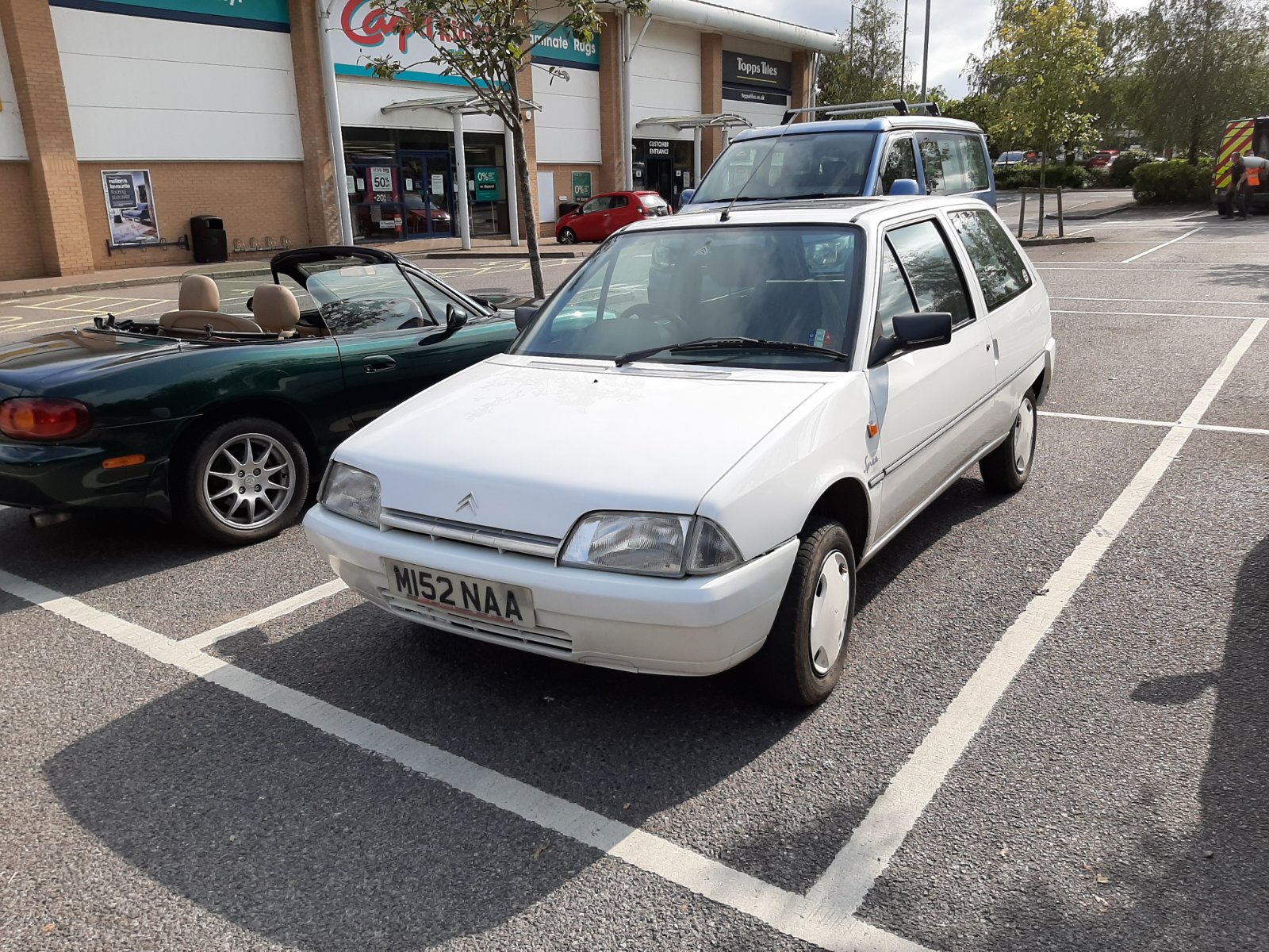

Daffodil visits Frome...

CitroJim wrote: 11 Sep 2020, 19:39 Image
Daffodil Visits Frome
Daffodil certainly chose to the "this could be anywhere" quarter of Frome. Anonymous carpark, Carpetright and Topps tiles!
I'm sure she could have squeezed down Cheap Street for a photoshoot :-D

NewcastleFalcon wrote: 12 Sep 2020, 18:01 Daffodil certainly chose to the "this could be anywhere" quarter of Frome. Anonymous carpark, Carpetright and Topps tiles!
I was on an errand Neil, procuring supplies and time was of the essence :) Parked nearby was an interesting vehicle, the picture of which I'll post elsewhere when I can ;)

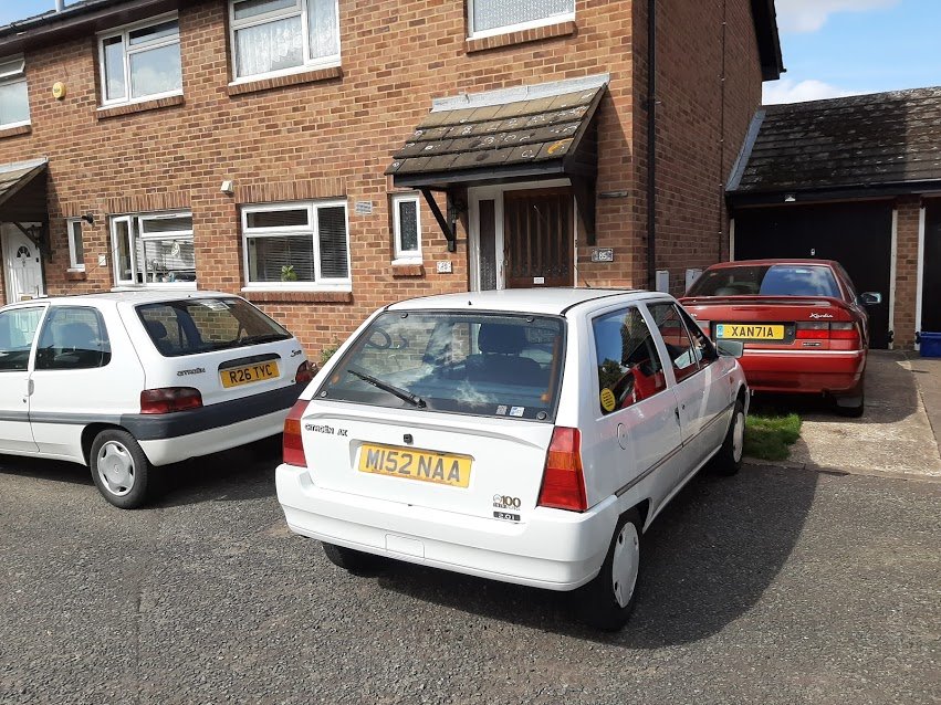

Just to prove she is home now...
She's home!
She's home!
I'm too tired to document the whole adventure now but watch this space ;)

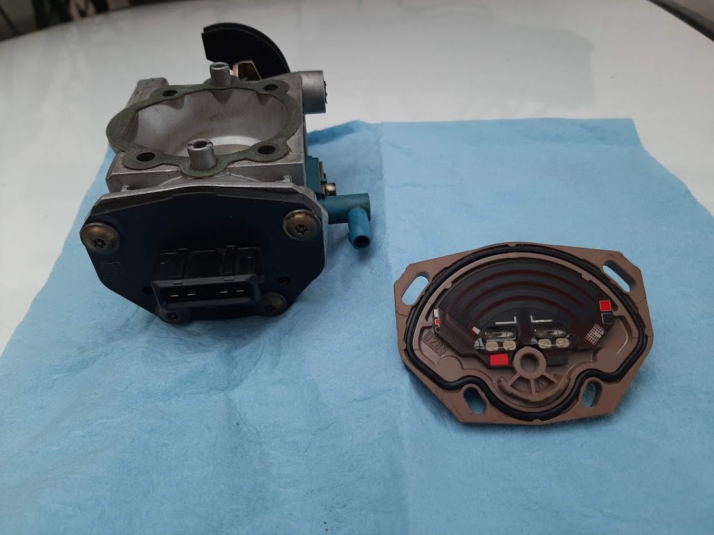

After settling in, we looked into the cause of a strange misfire on Daffodil. Like a random loss of power that quickly recovered but with no real pattern or frequency. Having had a similar problem in the past on both Daffodil and Sally - they share the same Bosch Monopoint injection - we had a look a the throttle pot. Luckily Alasdair had procured a replacement and fitting it has entirely cured the issue.
The throttle pot is odd on the Bosch Monopoint as it's part of the throttle body and not strictly renewable. The correct course if it fails is to replace the entire throttle body!
This is the offending part - car and engine removed for clarity!
Bosch Monopoint Throttle Pot

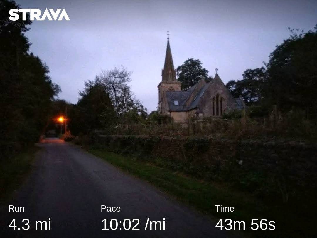

I love this picture of All Hallows church I got on my early morning run yesterday... Atmospheric :D
All Hallows Church, East Cranmore

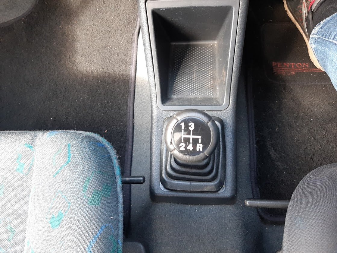

However hard I look I just cannot find 5th gear... It's even disappeared from the gear stick knob!
Where's fifth?
Where's fifth?

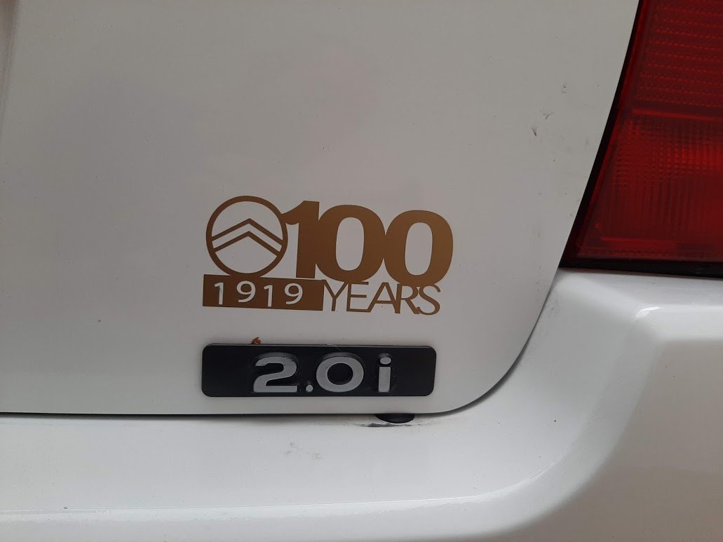

One big unexpected bonus is that it's had quite an engine upgrade ;)
Big Engine for an AX!

Sounds like an excellent couple of days, best thing being proof of your recovery Jim, now you have things to do for Daffodil you will just have to stay fit!! As regards the fifth gear have you looked in the glove box? :wink: :-D

mickthemaverick wrote: 13 Sep 2020, 06:56 As regards the fifth gear have you looked in the glove box? :wink: :-D
Good thinking sir :wink: :lol: I did look under the front seats - the normal hiding place for lost things - but it wasn't there so glovebox next :)
