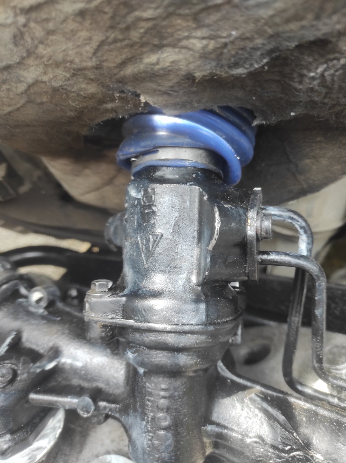

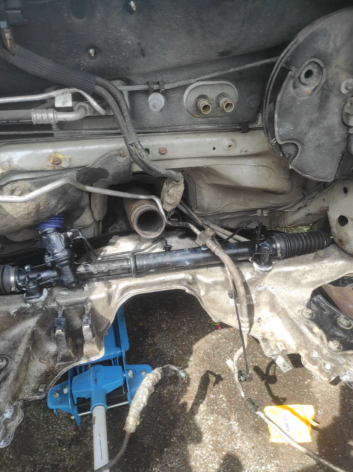

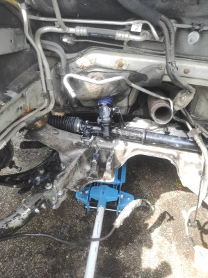

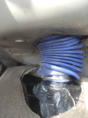

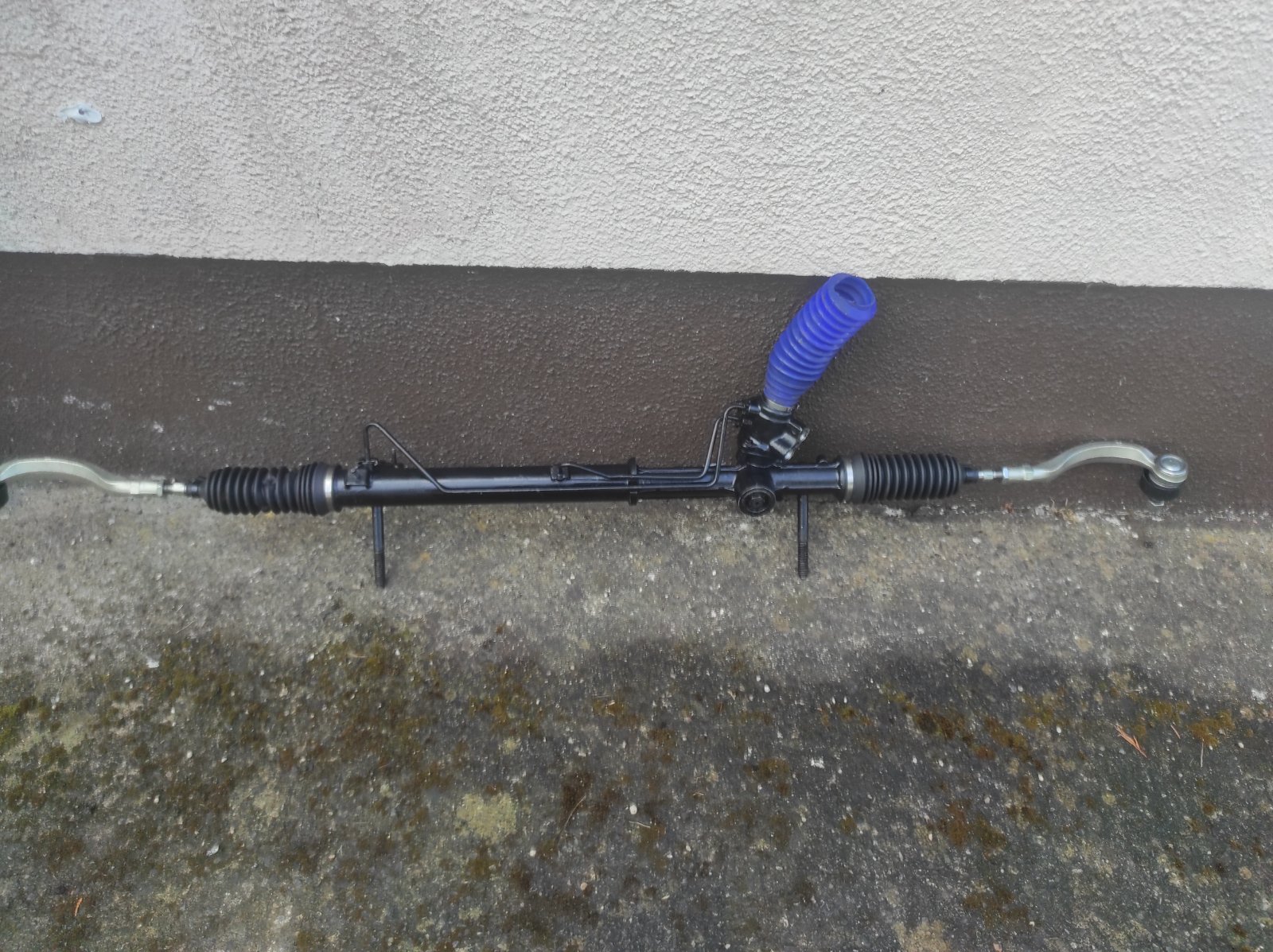

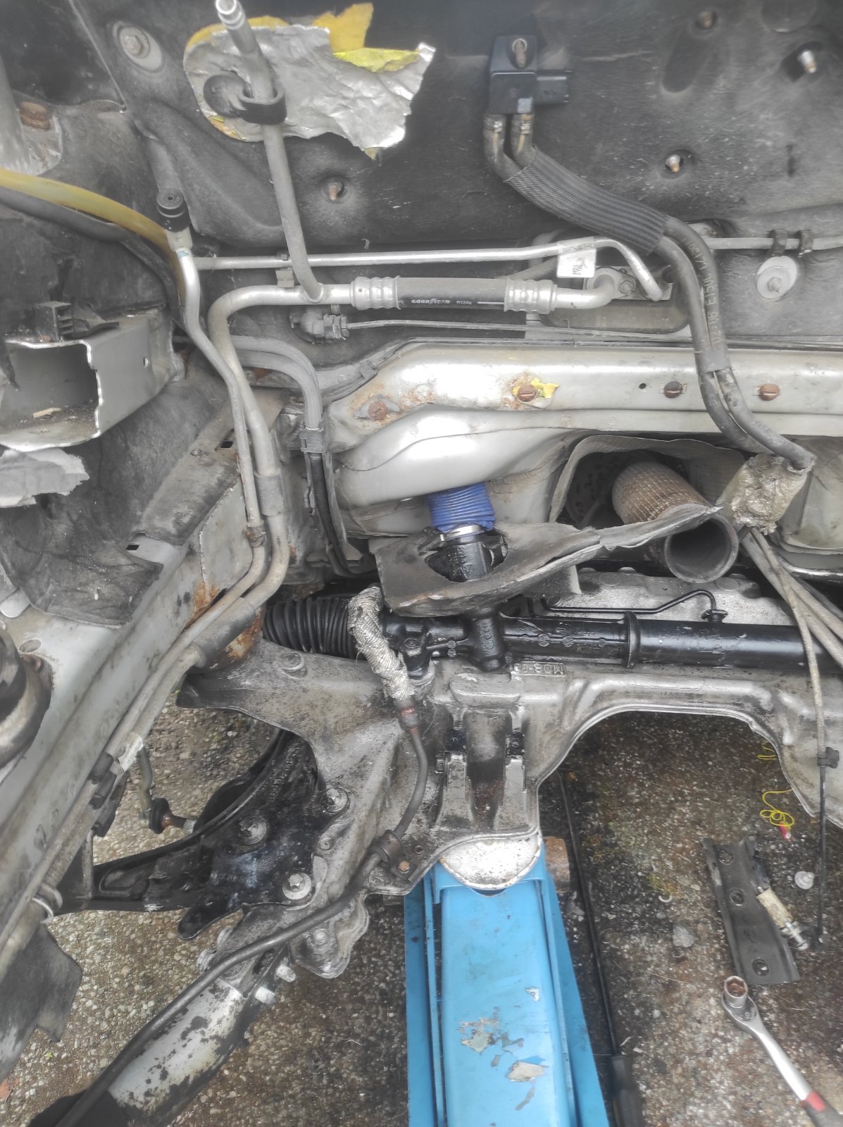

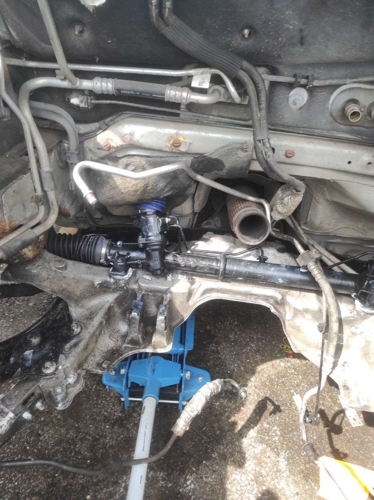

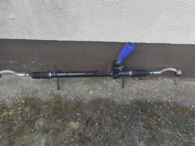

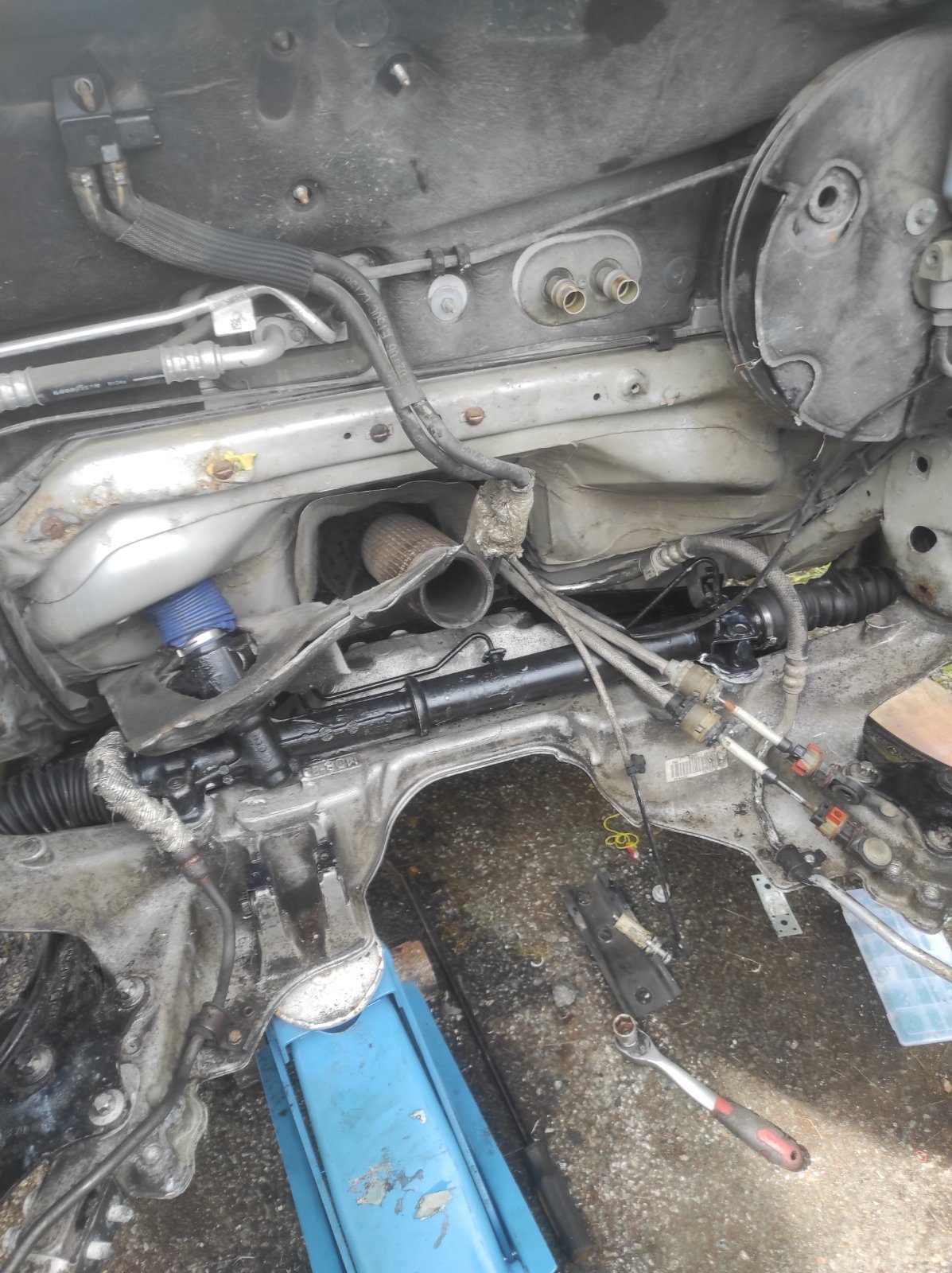

Hi lads just a picture of the steering rack I rebuilt it's now in the car still a few bits to do but on the home stretch now.I am not able to get a clip onto the top of the boot just no room. I have it connected to the steering column which was a bit of a pain trying to get the bolt in but I think everything is lined up correctly now. I won't know until I have the engine in. There is a mark on the steering column, angle sensor and steering wheel to line up but the steering wheel won't go on any other way so I think it's fool proof as long as the rack is centered.

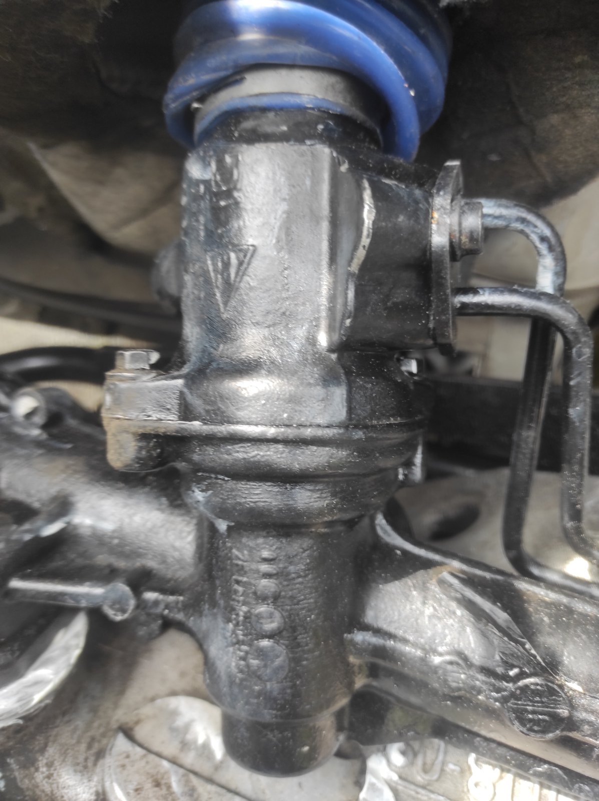

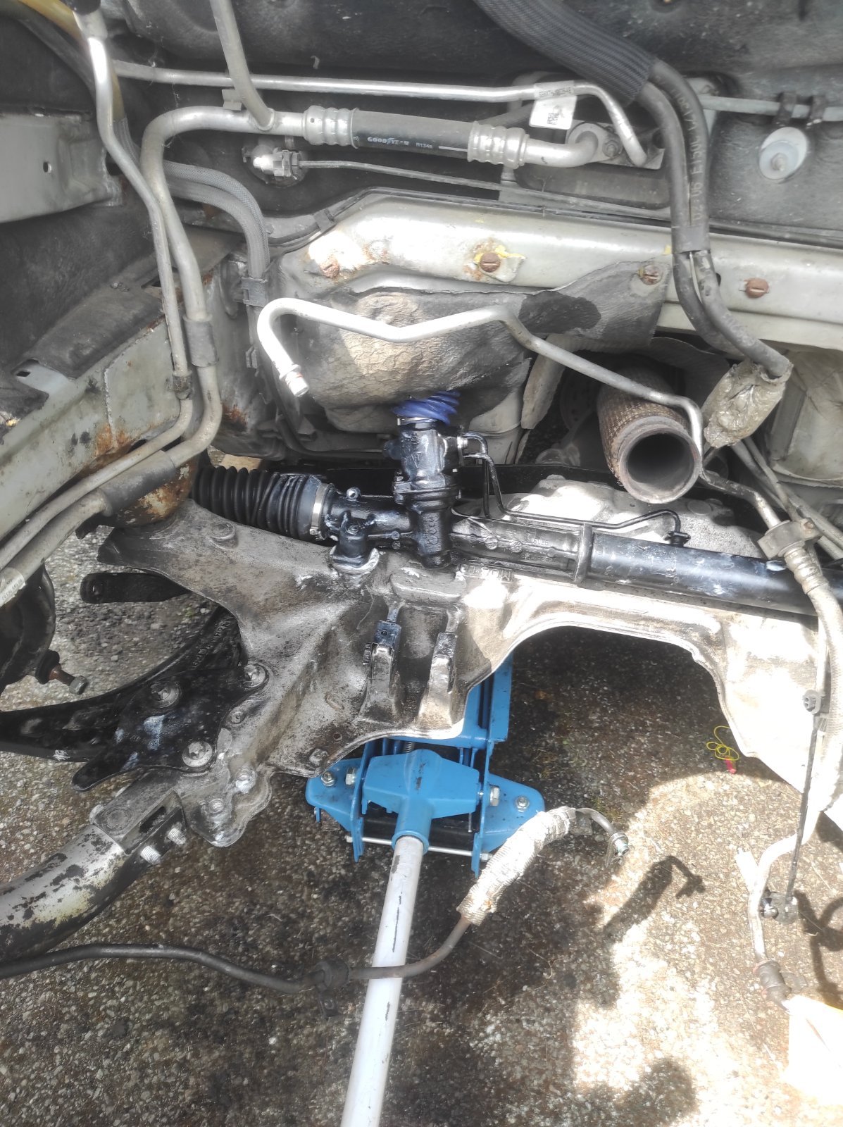

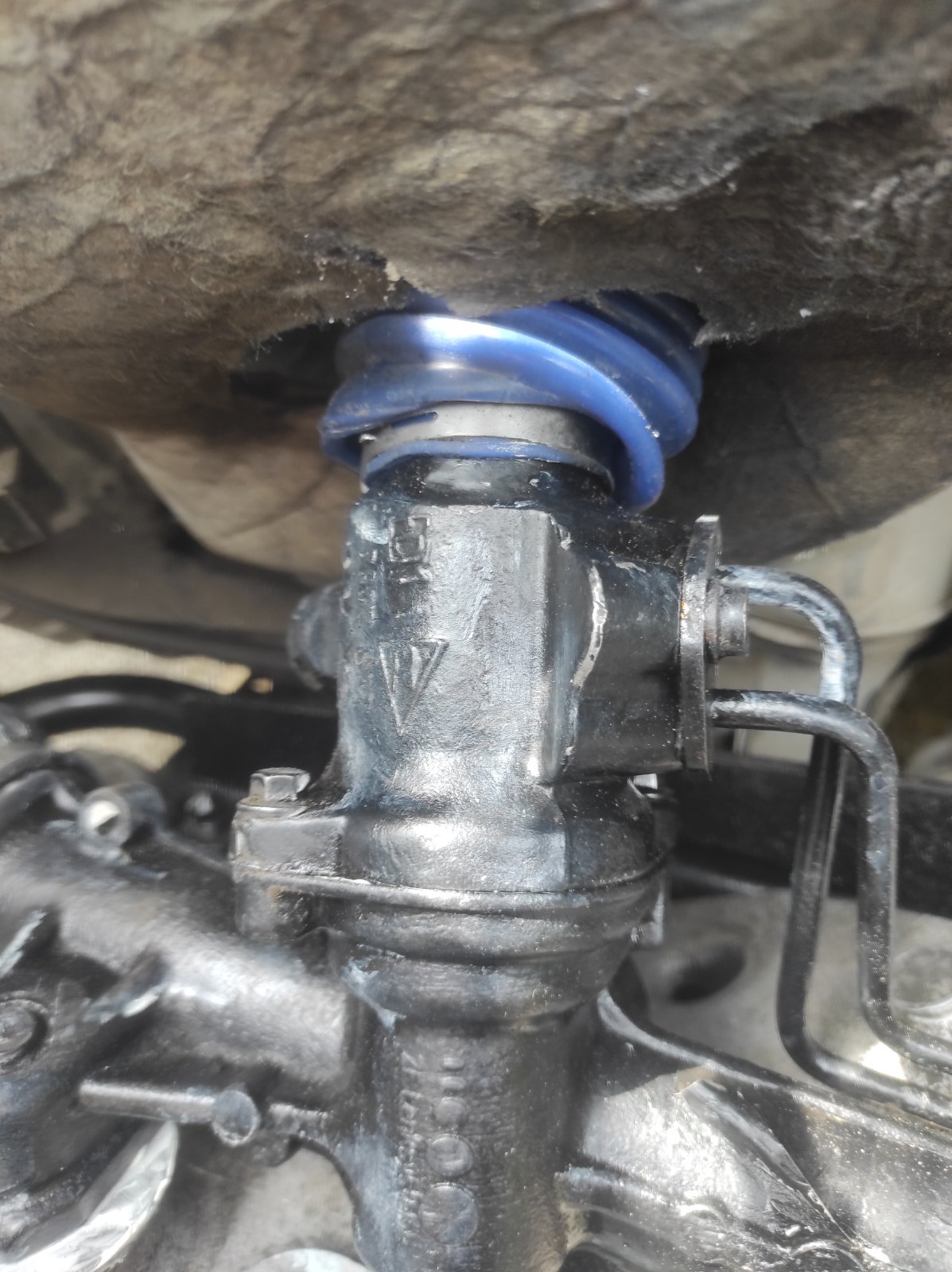

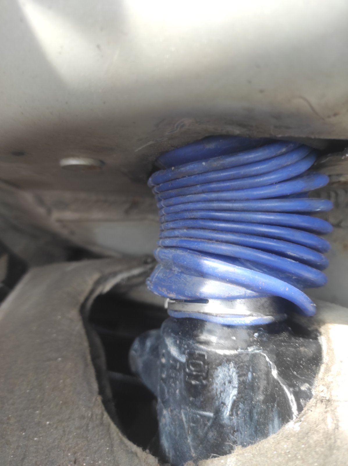

Re: C5 X7 Steering Rack - Again!
Hi lads and ladies, a few pics for you.
