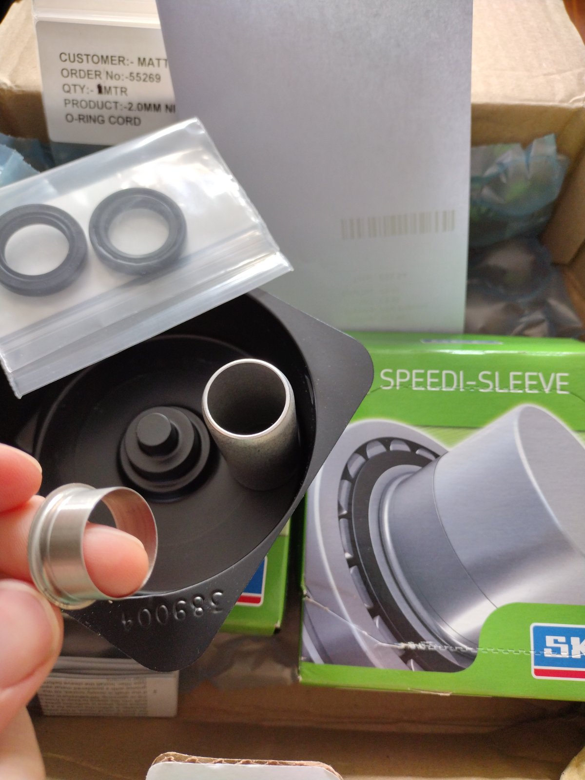

MattBLancs wrote: 17 Mar 2023, 14:33 Oh, my box of goodies has arrived! :) Image
Hi, my steering racket is making some noise. I've already change all the rods.
But now is making noise the racket itself in the right side. Is this part to rebuild it?

You need to figure out why it is noisy, that is part of the fix for a leaking rack that part goes on the pinion to give a smooth surface for the new seals. You might want to watch some of the videos further back in this thread to get a feel for what is involved. It's a lot of work and not for the faint hearted. I would start by figuring out what is causing the noise if it's rattling and you changed the tie rods it's probably a suspension issue rather than steering. Work through it methodically and most importantly safely.

That bit only serves to make a nice smooth surface for a new lip seal to run against= would think it unlikely any significant noise originated from there.

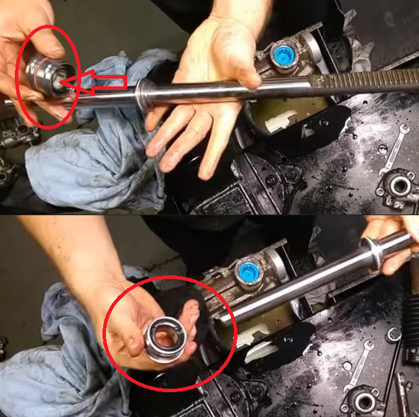

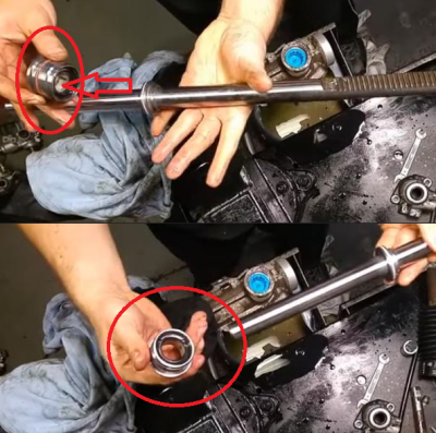

I took some picture from a video, inside the bearing marked in red there is a white plastic. I guess that's the worn piece
I changed that plastic on my ex-C3 once ago, I found the replacement on the internet and I trying to find that piece for the C5 also.

I didn't go that deep into mine as it didn't need it. I don't think anyone on here has gone that far in and posted on it.The main problem is there is no parts list available for these racks so you have to take it apart to find what you are looking for. I have just finished putting what I took off back together.

Interesting that would fail, would think a chunk of nylon / PTFE? In oil and hidden from muck by the external gaiter would last forever! Sadly not!
Is that a lip seal incorporated into it too? Complex to recreate and not sure where to look to source them (other than a rack specialist who might be reluctant to sell but Vs a full rack I'd guess)
