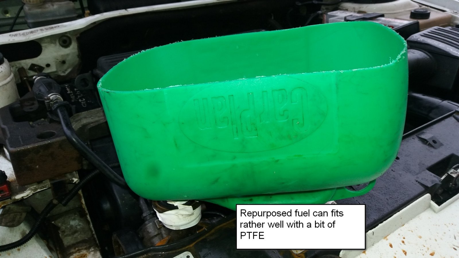

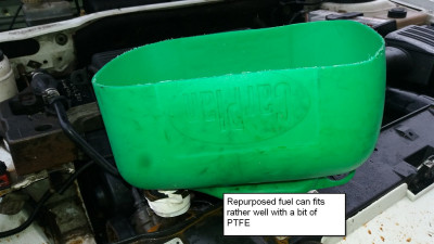

Thanks for the info about ‘Gaskets for Classics’, which it was very recently looking like I’d be actually needing (suspect HG) but thankfully appears that my rad repeatedly only getting hot on the bottom half was nothing more than inadequate bleeding…. which I thought I was doing really well, actually
…. front end a good foot up in the air on axle stands
…big header tank (see pic)
…initially bleeding it off the old Bypass Hose (cable tied 4ft up to the open bonnet, not connected to rad – only replaced coz the bleed was seized – of course)
…then re-fitting the new ‘proper’ Bypass Hose at the stat end as it should be, with the Bleed open and bleeding through there
…then once all that was satisfied, opening the bleed on the top of the rad
…checking everything’s getting hot as it should, including the Heater
and being happy
…but seems, no, not enough. Any hints?

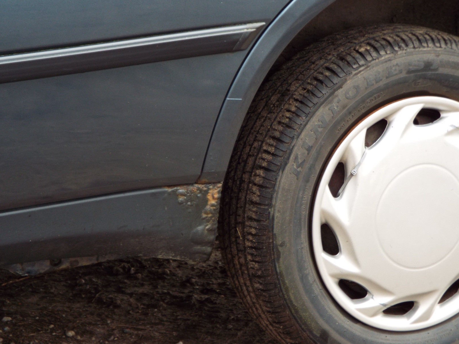

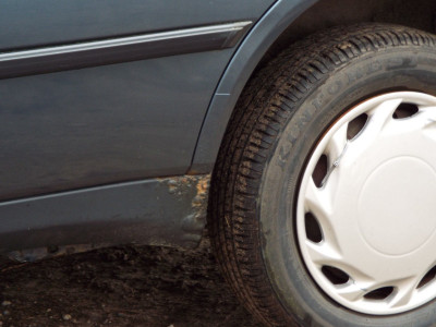

The Mi-16: a look at the trailing edges of the sills (pic, if they look like this you've really got a problem - this pic is from a rot-box I saw advertised for sale) and (if you’re able) the bottom edges of the front inner wings, close to where they meet the front cross-member will give you some indication of the state of crustiness of its underside. From what I’ve seen, if there’s Bubbles and/or Holes poke-able in either of these locations it suggests the over-all will be poor. They also rust on the inner wing tops, visible from the engine bay (think ZX’s tend to be better know for this, but also afflicts the 405), but less readily than the previous stated locations. Even if it’s a hopeless case though, its probably still worth pulling out of the field as a spares or track car and while none of them are worth peanuts now, note that if you're lucky enough to have found a Le Mans or a 4WD Mi , its worth even more

I shall not miss local offices for the very reasons stated, i.e. having to move vehicles to be identified. Does leave the door somewhat open for dodgy business but then again I'm sure their officers are well versed in checking digital photo's properties for any tampering/date stamps etc.
The poor car is sunk down so low & has sideskirts so can't ascertain if it's rotten or not, although the floorpan does hold water (not normally a good thing, but in this case, proves the floor is at least there or thereabouts!) and under the bonnet doesn't look Godawful save for surface corrosion on pulleys etc & lots of spider webs.

"The poor car is sunk down so low & has sideskirts so" the the sills are almost certainly suspect - & not just at the back!
