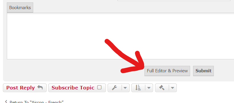

Please don't use third party image hosting sites - it makes it very difficult to keep flicking back and forwards. Just upload them direct to the forum in future please.

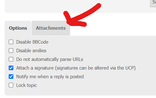

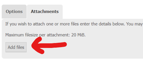

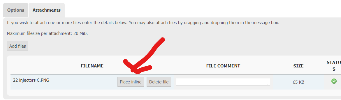

Instructions:
That assumes that the calculations are correct of course, because it is only estimated (and than nobody has reset it without topping it up previously).
Instructions:
| 1) Use Full Editor & Preview Button | 2) Click Attachments Button |
| Click Add Button to Browse PC or Phone for Images and Upload | Click Place to put the Images in Your Post |
