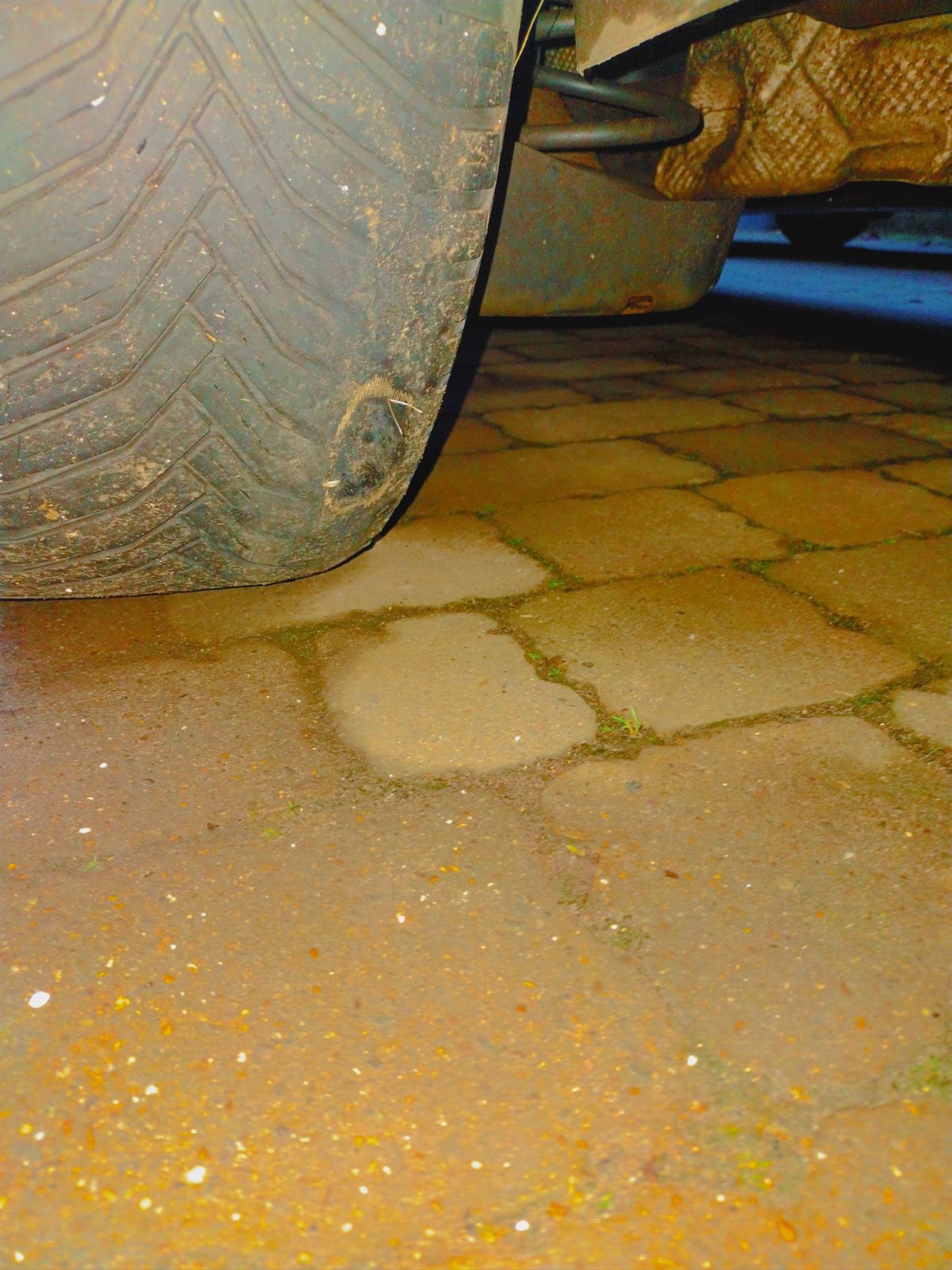

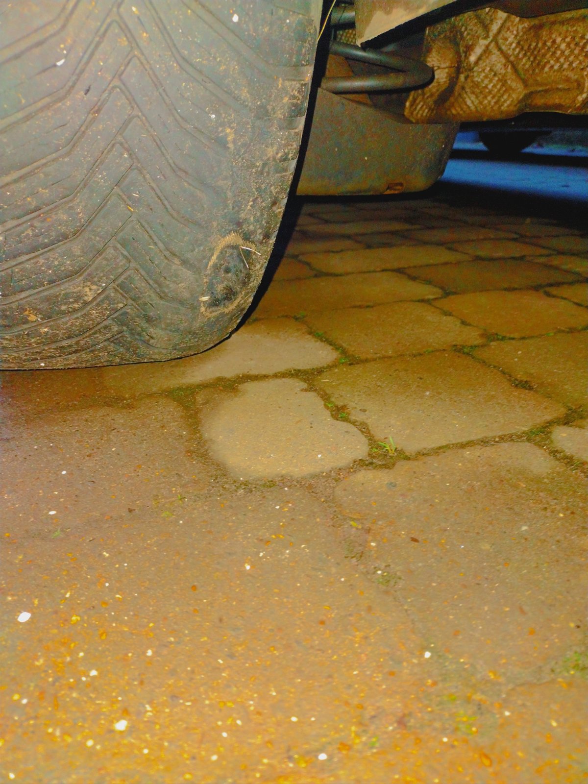

Picasso has developed a rear vibration over the last few weeks - a quick look yesterday showed this:
Ah, that'll do it then! Bit annoying, it's still got 4mm left - not had that happen on a Michelin before.
