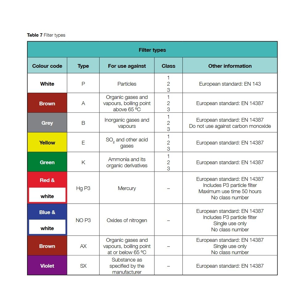

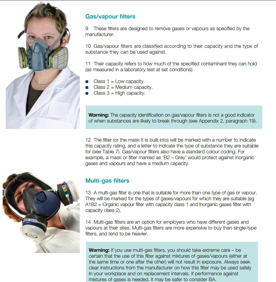

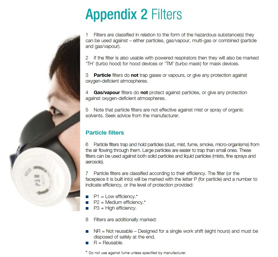

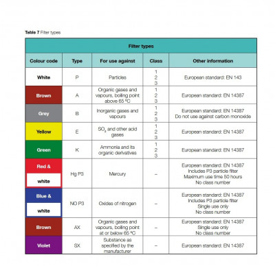

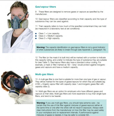

Welcome back from your short absence, Jim.
Chapter and verse on correct masks and filters can be found here:
http://www.hse.gov.uk/pUbns/priced/hsg53.pdf
Unfortunately, there's no simple answer to your question as it depends on exactly what you are doing. The ultimate protection and comfort would be provided by an air fed respirator.

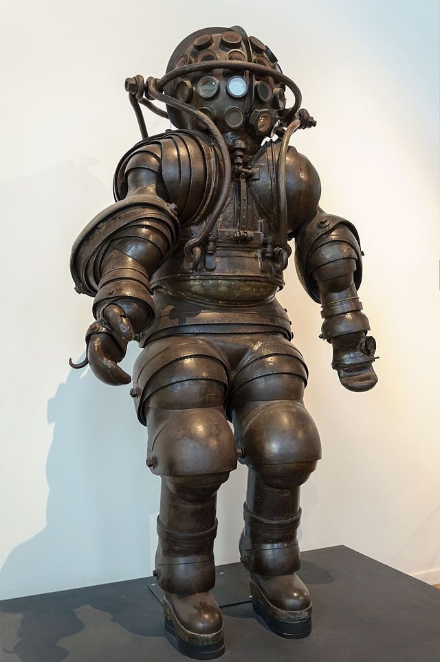

Re: Citrojim's Pixo, Saxo and Cycling Tales
No point in half measures !

Thanks all for the warm words
Awww... you all make me blush!!!
Thanks too for the respirator advice
I shall study carefully... yes, the S10 is overkill but looking at your charts Bobins, I reckon a brown one might do me given it seems I'm most affected by organic stuff...
I shall now see what I can obtain...
