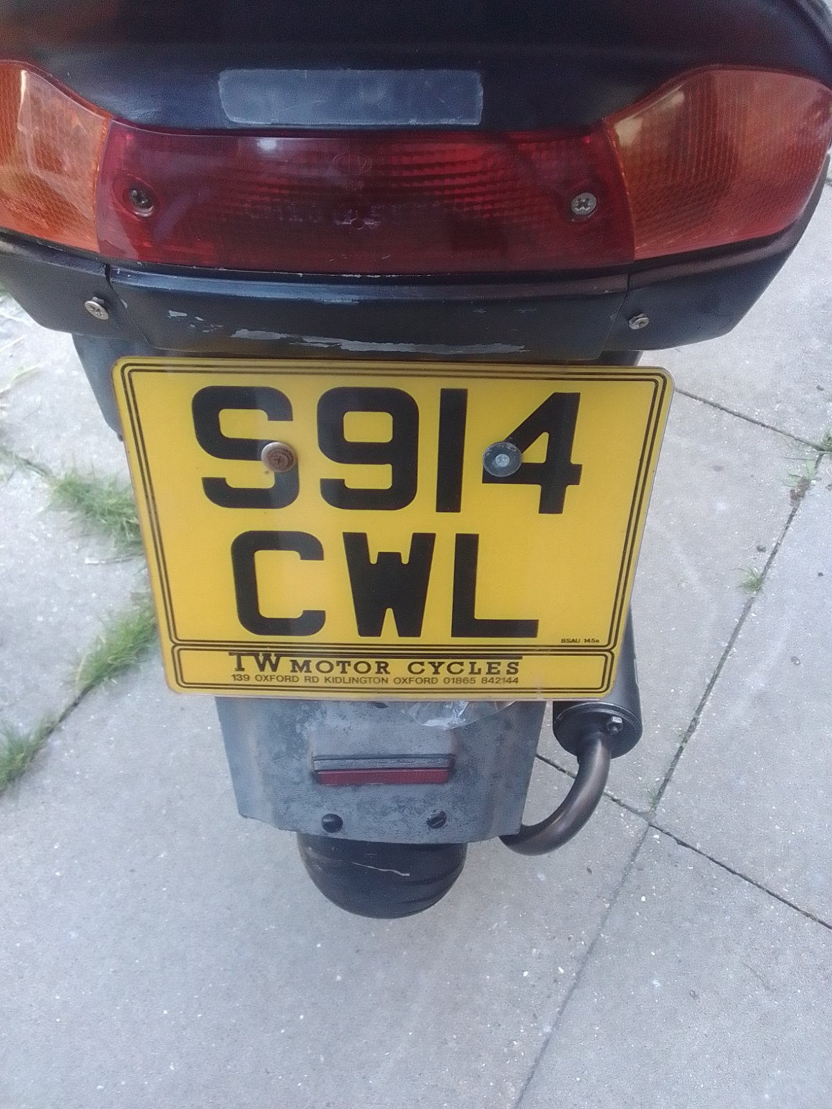

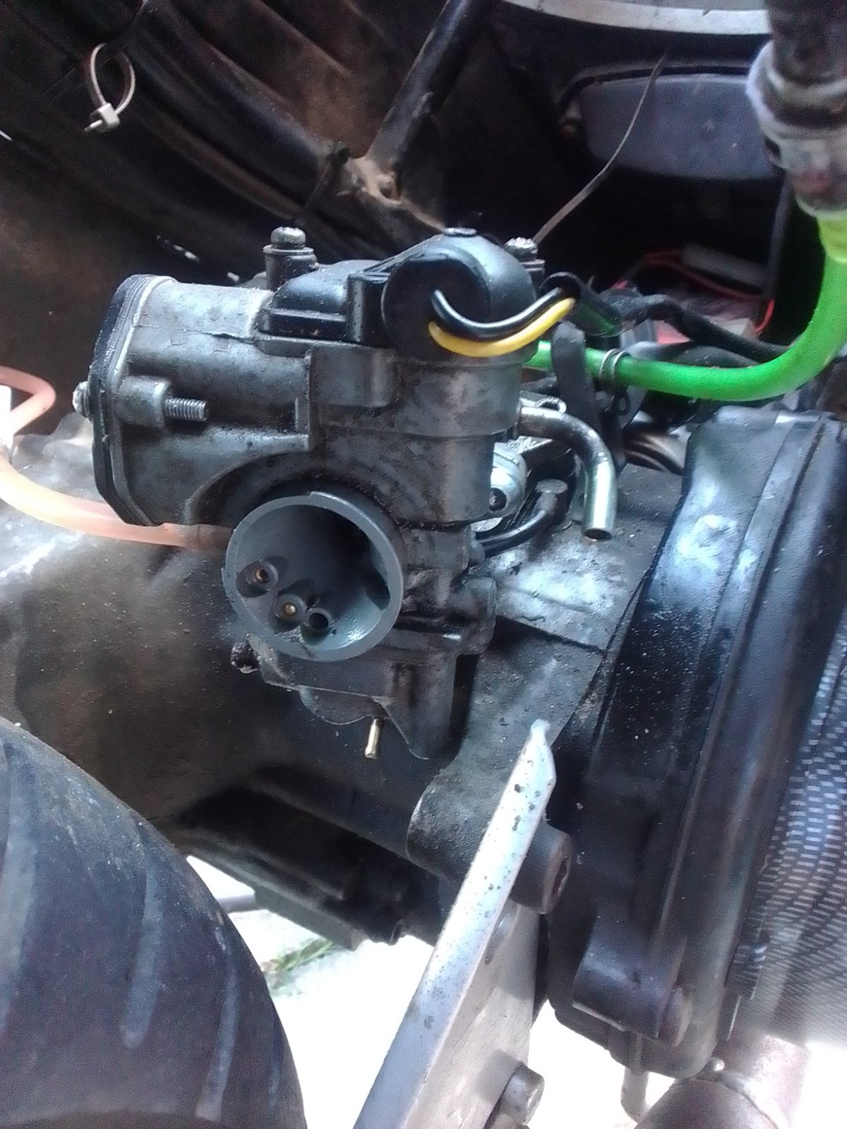

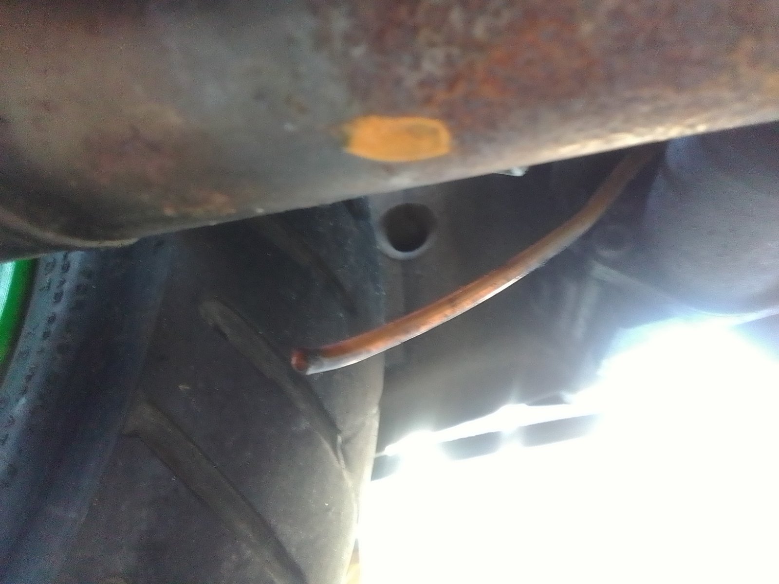

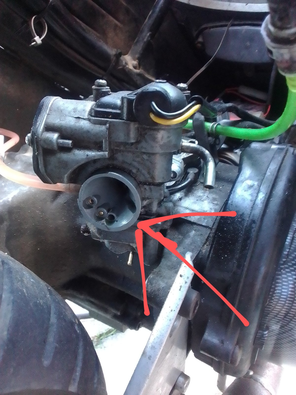

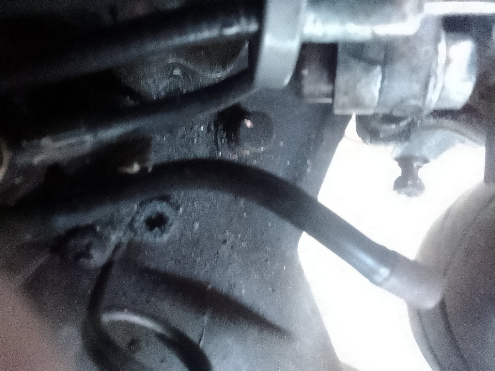

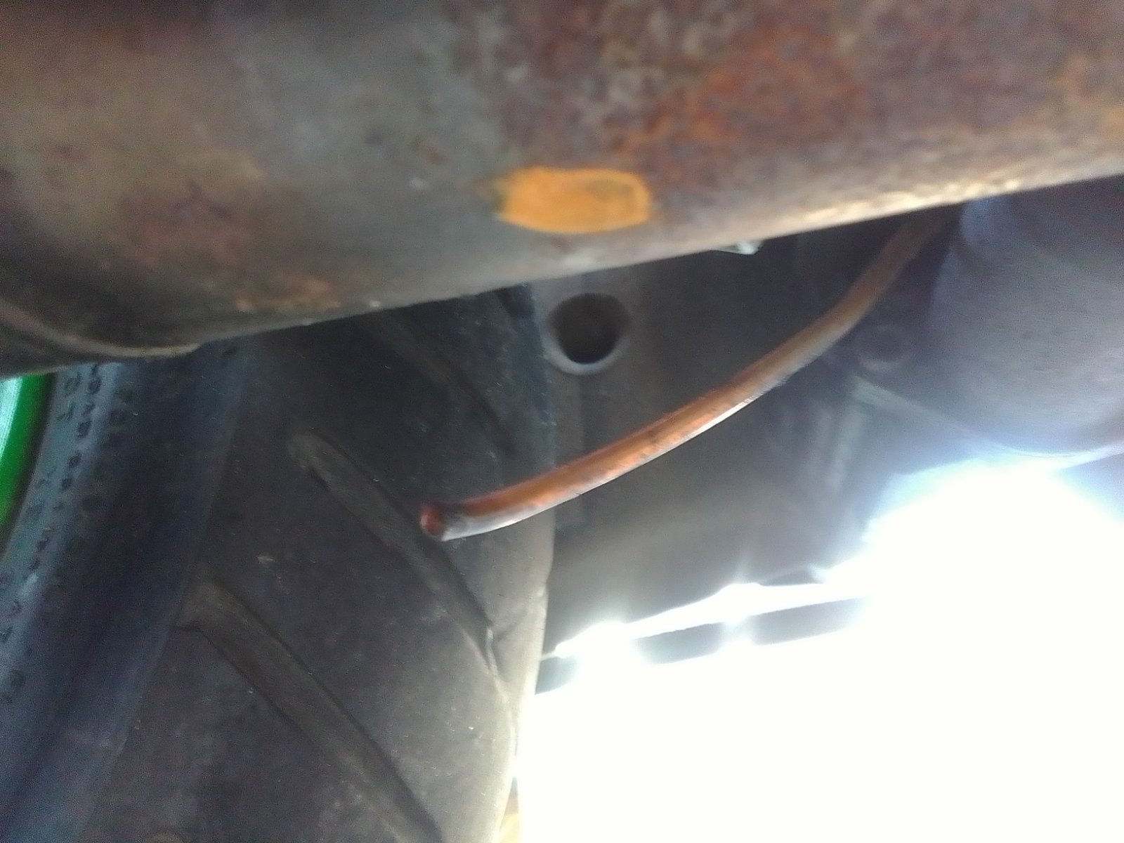

Really struggling now on this moped. Here are a few picks, help, found loose spark plug, dodgy fuse and still won't start!!! Fuel is good, it's not flooded.

Have you got compression? Are the jets clean?

Yes, and spark

Is the plug getting wet when you turn it over?

Not now it's been tightened, up was finger loose before.

So a sum up, with the plug out it has a spark, when back in you have compression but no firing, fuel is new and engine not flooding, sounds like the fuel is not getting into the cylinder to me, ie a blocked carb jet. Whip the carb off and clean it through with carb cleaner and blow it dry then reassemble and try again. You do have to get it up on the stand and pedal quite a bit to get them running.

Am I supposed to be able to see in here, I haven't taken anything off it.
