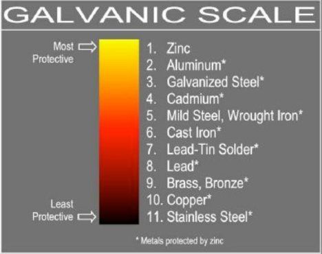

DONT DO IT!!!darbuck wrote: 01 Jun 2023, 12:28 Thanks Jay, I am thinking on trying an annealed copper washer on the hydraulic pipes. I can't see how I could access thread in the housing with the rack in place if I was to tap it. I will just have to change seals and hope the copper does the trick. What do you think.
Pinion housing is Aluminium, putting copper anywhere near anything aluminium results in a world of galvanically corrosive hurt.
I thought you knew better than that, having access to the ansys system? Anyways, here's a diagram showing how far apart Copper and Aluminium are on the galvanic table, and the further apart they are, the more they will interact with and eat each other.

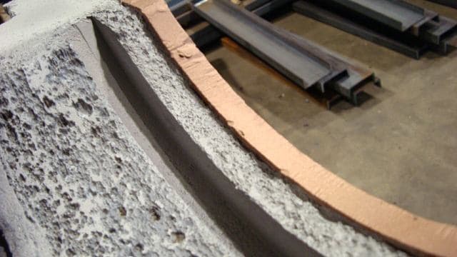

In this case, the copper would be effectively eating the aluminium, as the washer would cause the aluminium pinion housing to do all sorts of self immolating reactions, sort of like this:

Hi Jay, never checked it and assumed using copper like we do for injector seals in aluminium head was good practice. I appreciate you pulling me on this, I haven't had a chance to look at the Ansys and I seem to be forgetting useful information in place of other junk lately. It's very interesting to see that behaviour. So I would be better using a polymer/fibre washer if as Matt suggests a beefier o-ring doesn't work?
