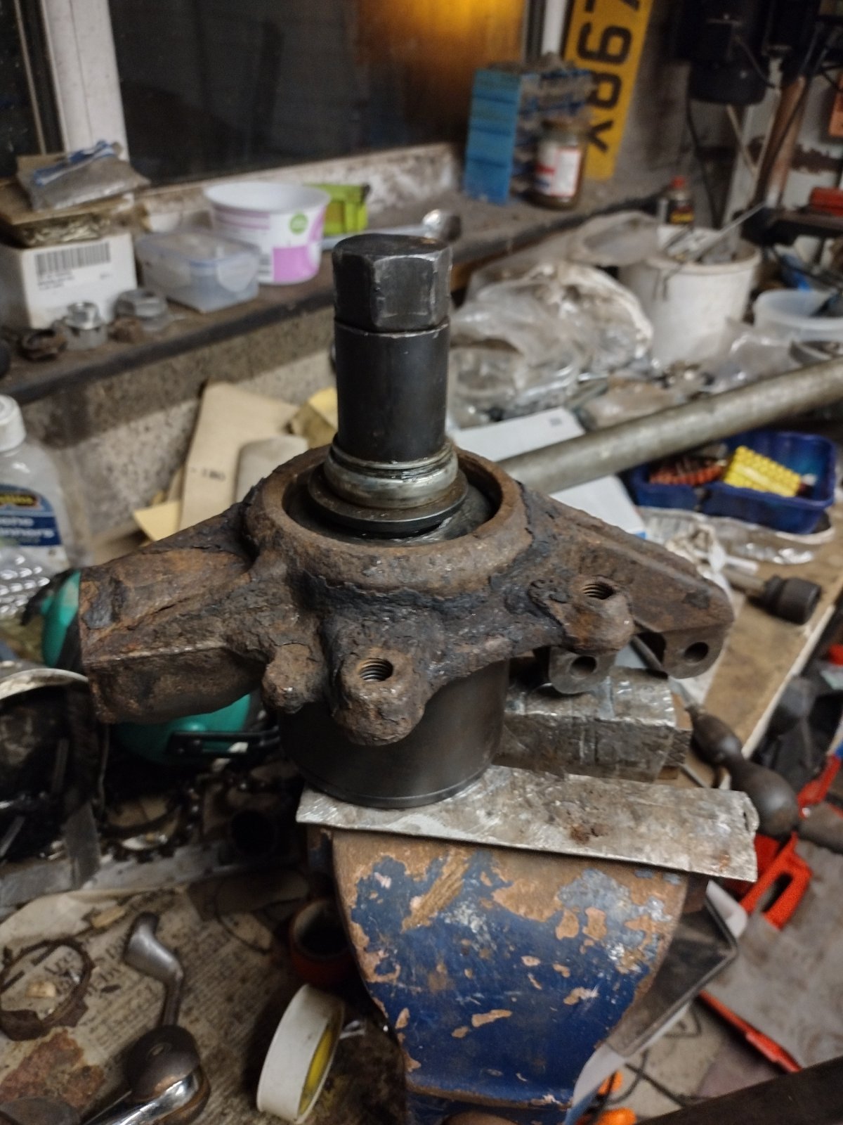

Fun with bearings.... The shell of this one is resolutely refusing to be wrested from its 13 year home
Tension on the puller, heat it up (admittedly only a butane torch), whack it with a sledge hammer....not even a hint of movement. Hmmmm. Left it to 'soak' overnight with the tension on. I think some porous welding required in the morning (run out of gas

Gosh Yes, they can get very at home over the years Richard... I once recall doing this job on an XM. Made my hydraulic press really struggle and the gauge went past the end-stop and bent the needle before the bearings finally let go with a big bang...
Let's hope the bearings decide to cooperate after a good overnight soak

MIG for the win and the bearing is out. I've pulled the new bearing in, but then tried to fit the new bottom ball joint - to find that in either removing the old one, or the bashing, the thread is damaged and the new one won't start
The old one came out a bit hard, and the thread on it looks pretty 'flat' so that's probably the cause - I've ordered a repair file to see if I can recover it; otherwise I guess it's a new hub; it appears to be M38 which is not really an off the shelf size of thread / tap!

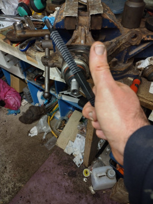

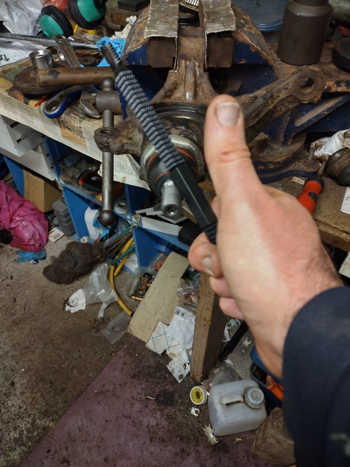

I change the ball joints if I have the hub off, as they've usually got play in them, and they're cheap and easy to change when the hub is already in the vice. In this case, no play was evident, and it's not proving easy, and not really cheap (already £30 for the thread file, could be a new hub and another wheel bearing at worst case
- Posts: 12598
- x 1490
Re: Confessions of a Citroholic
Thread file for the win
Only took about 30 mins, it's still a bit stiff, but screwed home, just got to torque it up.

That is one of those anomaly type tools, great to have in the tool box but hope you don't have to use it!!
- Posts: 12598
- x 1490
I probably didn't know it existed before, but saw a video by Cutting Edge Engineering the other week where he fixed a damaged internal thread with one. Pains me, but Amazon delivered one the next day.... I also bought a set of 4 large circlip pliers to put the bearing circlip in, only needed the one pair, but didn't seem to be a way of buying just one! Not sure I will have any other use for them, but it sure made it easier to put the clip in, rather than fighting with screwdrivers and the like.
