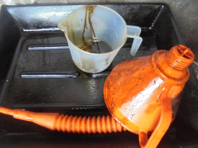

For the 666th reply on the thread, an appropriate picture of an evil substance...used engine oil, disgorged from millions of sumps every day collected and poured into temporary tanks, at best, for someone else to take away and deal with leaving behind contaminated hands, clothes, rags. The latter went into the goods which cant be recycled and the evil black liquid into the tank at the recycling centre. Hideous process but a bit of an annual reward for the 6-bottles-of-wine Clio passing another MOT.

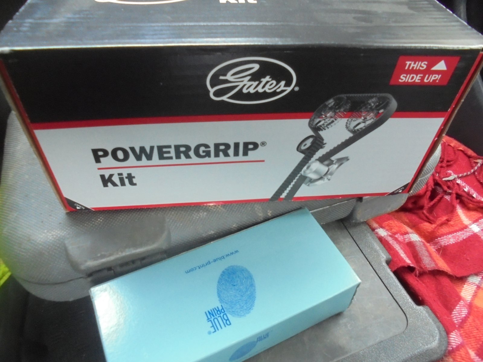

I have no evidence of whether a new timing belt has ever been fitted to the Clio. One thing i do know is the previous owner would not have fitted one himself. In 2017 when we acquired it it had done 38,000 miles and was 14 years old, and had stood surplus to requirements for a number of years. I don't think the previous owner would have been pro-active in ensuring that a new timing belt was fitted and Renaults recommended change is at 72,000 miles or 5 years whichever comes sooner.
The time is now ish so I have got this gates belt/tensioner/water pump kit... The job is well within my skill and toolset having done many such jobs before but may well get someone just to do it. Mobile mechanic maybe, or just put it in a garage. One garage highly recommended quoted £200 with me supplying the parts. If that sort of price is the norm it's at the bit too much scale of value for saving the hassle of doing it myself. Last Saturday's of working in a muddy puddle escapade colours my judgement though.

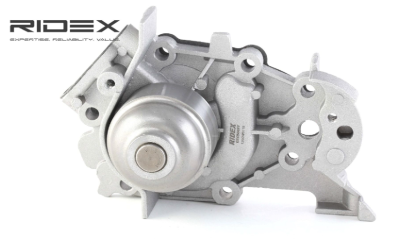

More decent assistance.

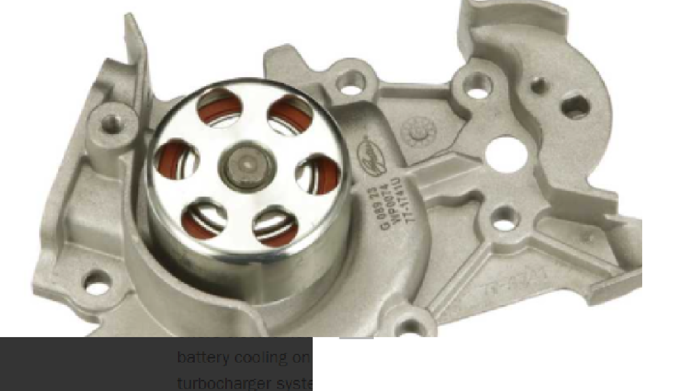

Having booked the mobile mechanic and got the timing belt/tensioner/water pump kit, i have begun to have doubts that this water pump with the Gates kit is the right one.

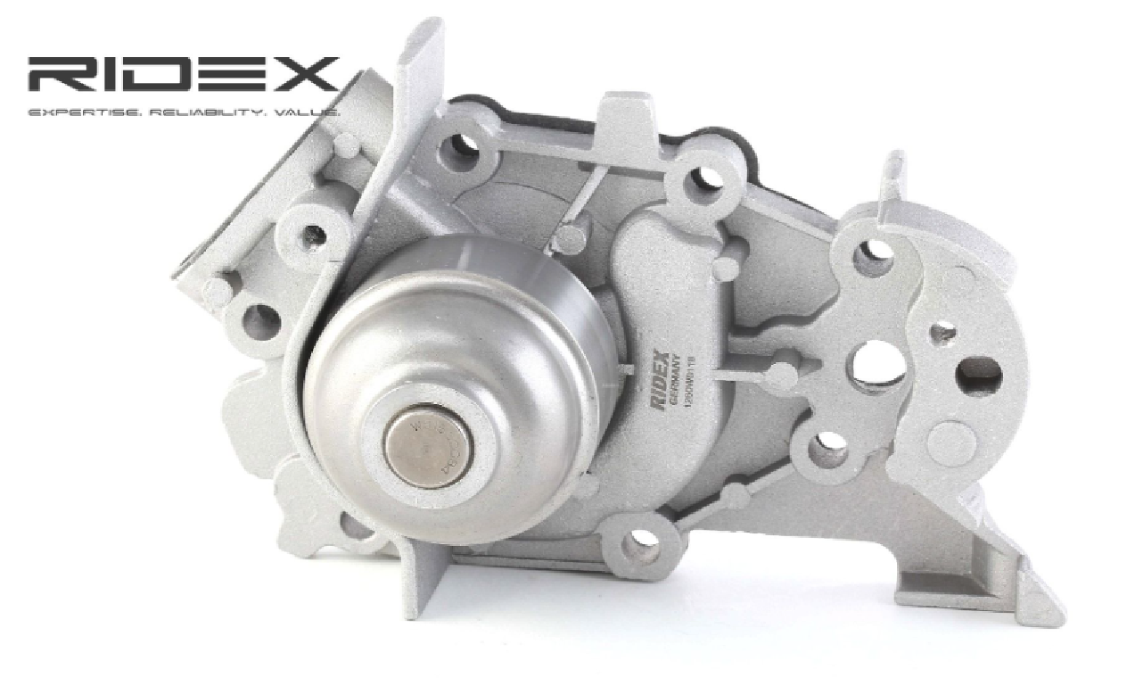

That's because videos of stripdown/ timing belt change of the D4F712 engine (as per the BB clio) always show a water pump with a "cone" end. Like this
Used the old fashioned method and phoned Lookers Renault in Newcastle, and got the official part no by giving the VIN to a helpful chap in the parts section, 210101832R valuable piece of info.
Had a look at Autodoc and shoved the official Renault Part No. in the search, and up came examples of both the "Cone" and the "Telephone dial" water pump from various manufacturers listing compatibility with the Renault number.
Belt and braces phoned BG Motors at Broadstairs the independent Renault specialist I had got the side-impact sensors from a couple of weeks ago, and just asked the question about compatibility of the two types. A friendly exchange and another confirmation of compatibility.
I think I have done all I can apart from buying a cone water pump just in case.
If I was doing the job myself it wouldn't matter, but when someone is booked to do the job, they need the right parts to fit there and then
