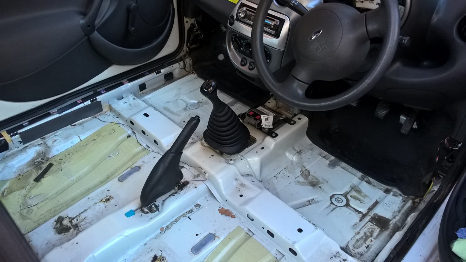

Back to the Ka... This is the state of the interior now:
Own Work
Own Work

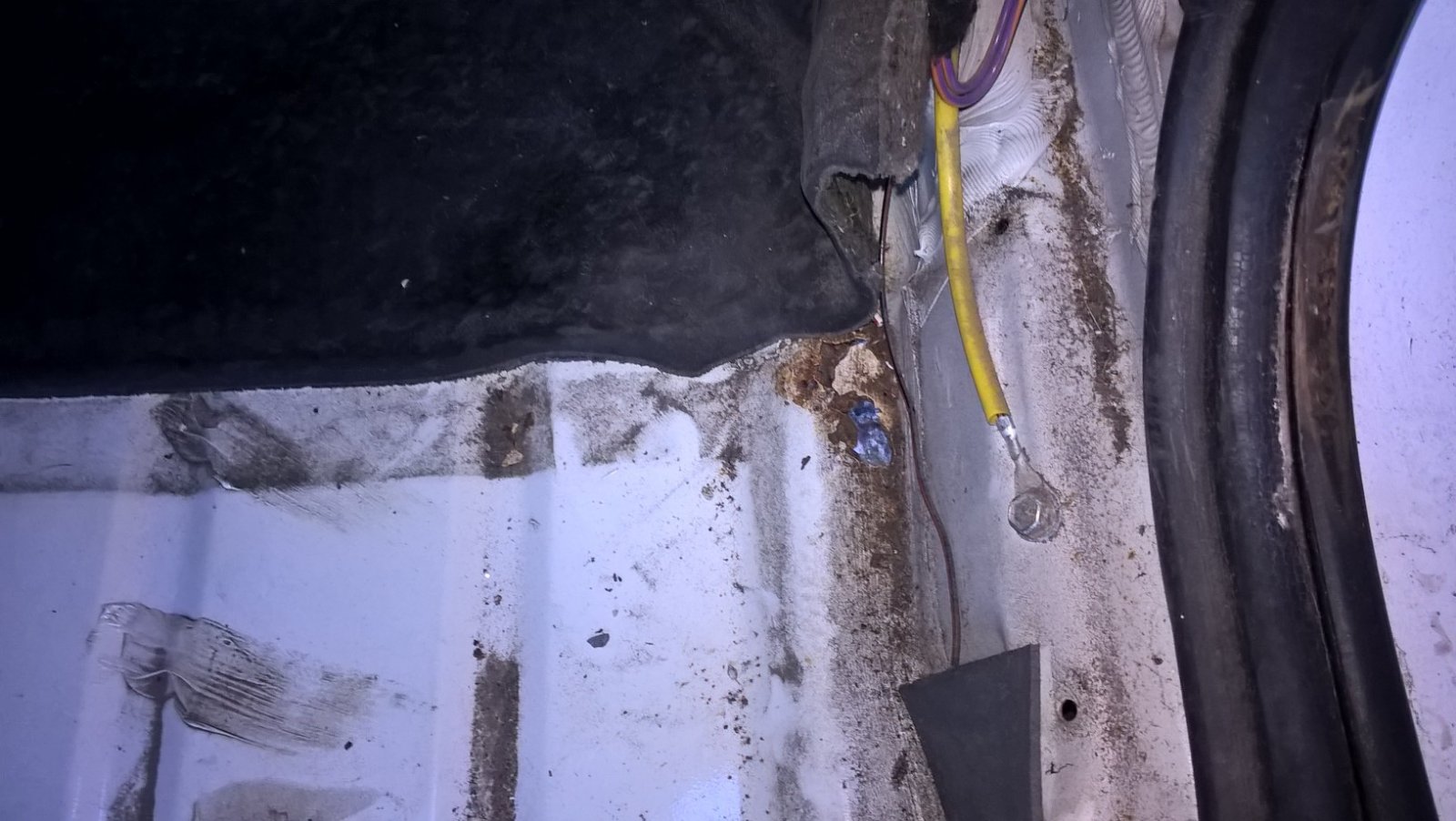

This is a typical example of the rust affecting the front floorpans:
Own work
Own work
The opposite side is almost identical...

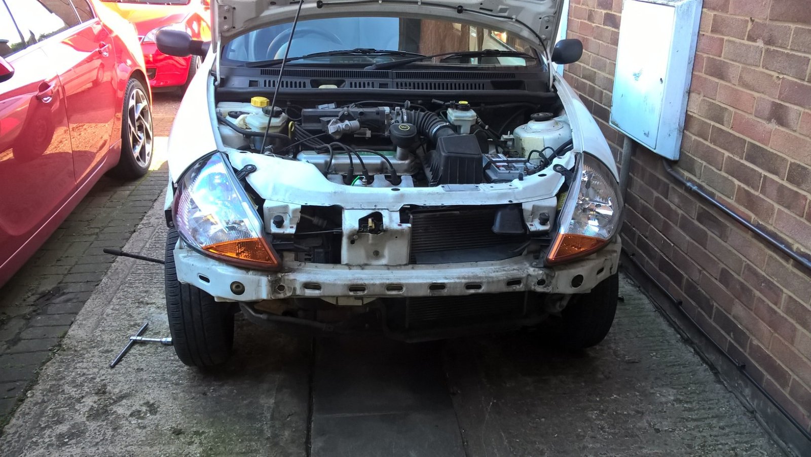

The front bumper is so easy to remove it's unbelievable...
Jodie now looks like this:
Own Work
Own Work
Not too dissimilar to the picture posted earlier of the pile of scrap :lol:
Sharp eyes may spot the Vauxhall Insignia too...
I've now just got to do a bit of grinding back, pop the driver's seat back in temporarily and she's ready... With any luck she'll have a new MoT by the end of next week :)
Then, before she goes back together I'll get busy with the rust-proofing and giving the interior a good spruce-up... I know if I don 't then it'll be the same game again next year... I can see why the Ka dissolves like a 70s Fiat - they have very little rust-proofing applied to them :( No wonder you see so few left now...
