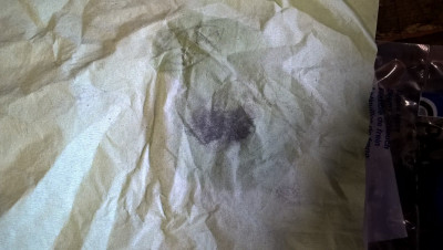

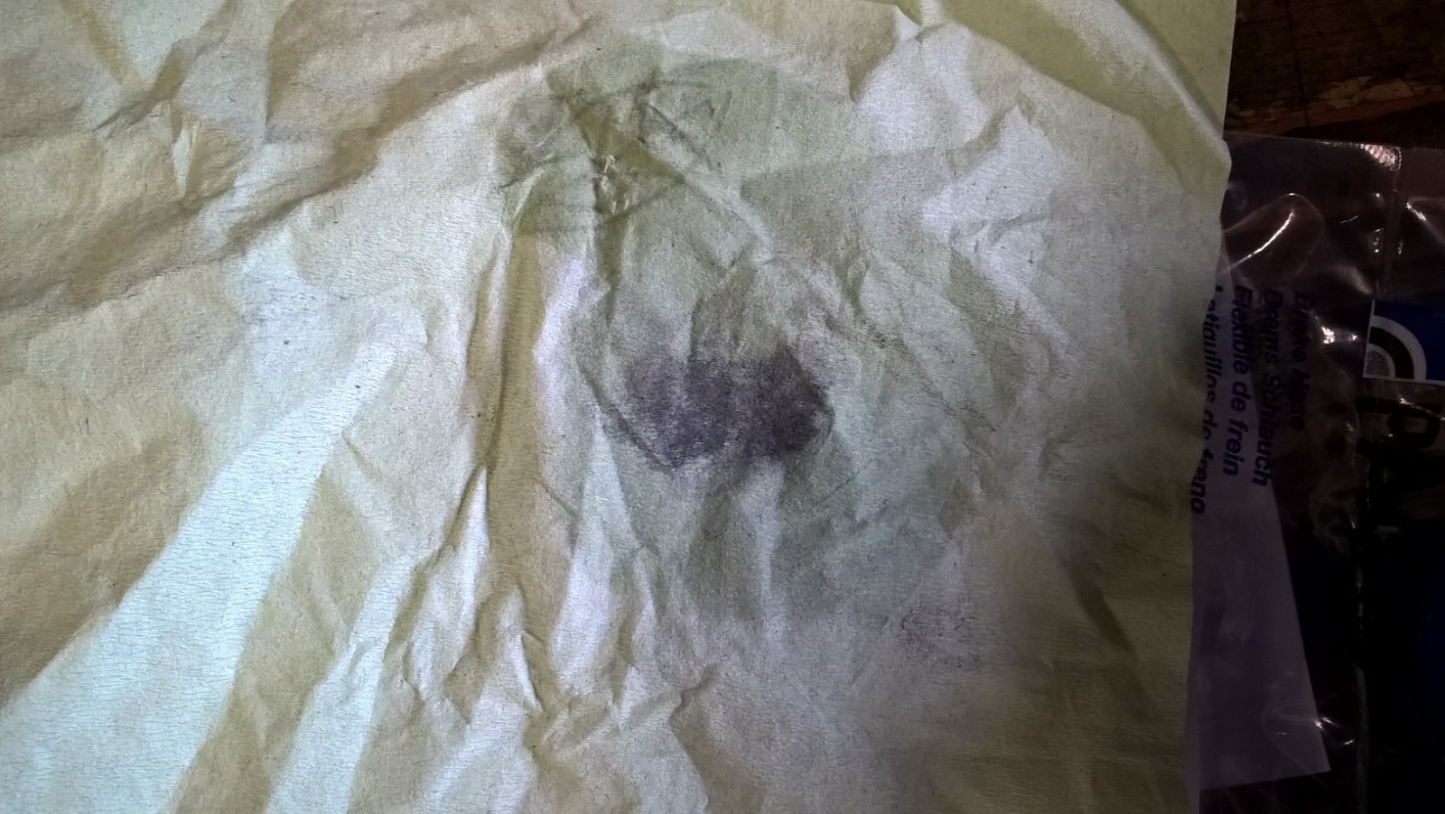

I may just have fixed Sally the Saxo today... Time will tell :roll:
I swapped her throttle pot for the one from the replacement throttle body but not before giving the pot tracks a really good clean...
This was how much muck I pulled from the tracks :o I used a bit of soft lint-free rag and some iso-alcohol on it...
Own Work
Own Work

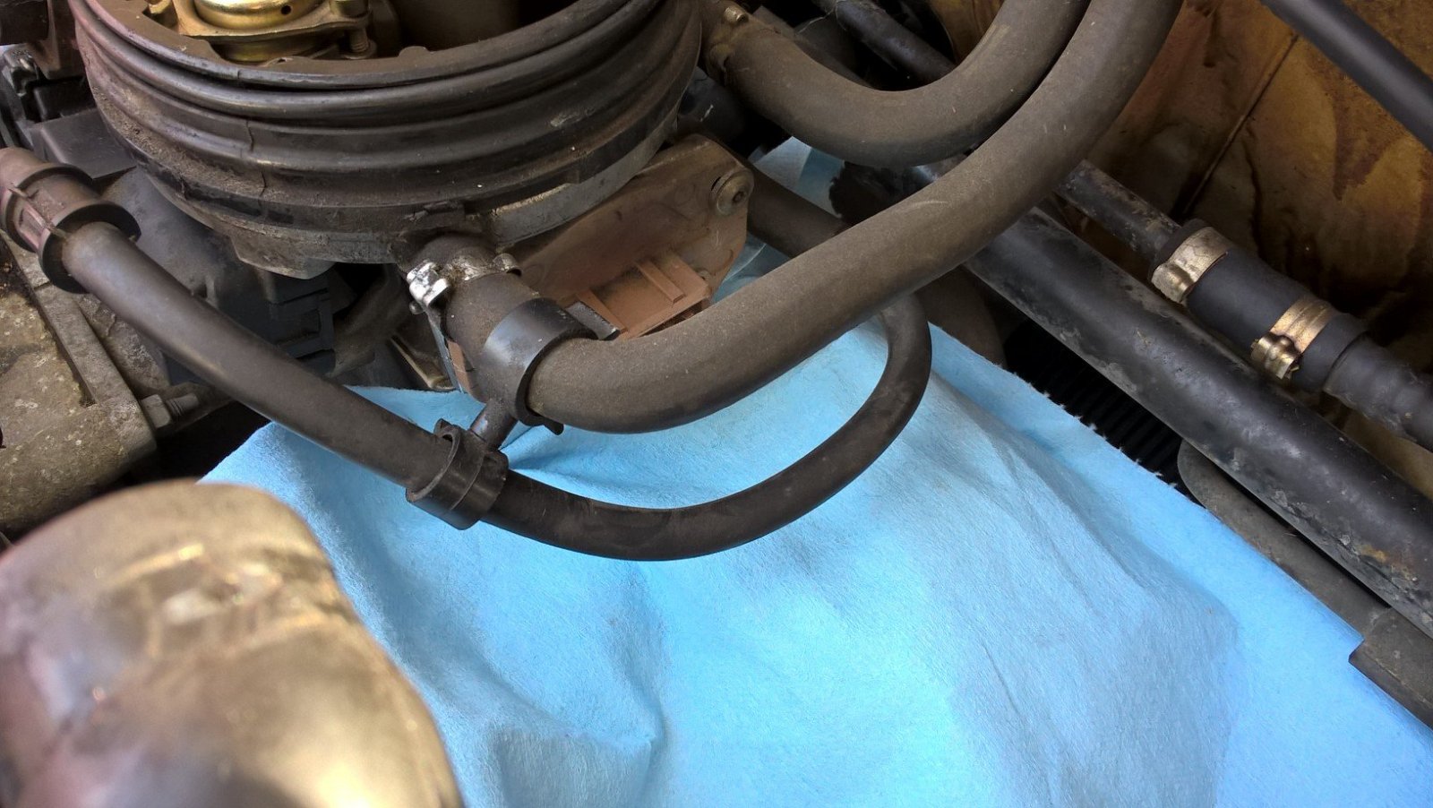

With the airbox out of the way access was good..
Own Work
Own Work
The blue rag is there to catch any falling screws! Happily not needed...

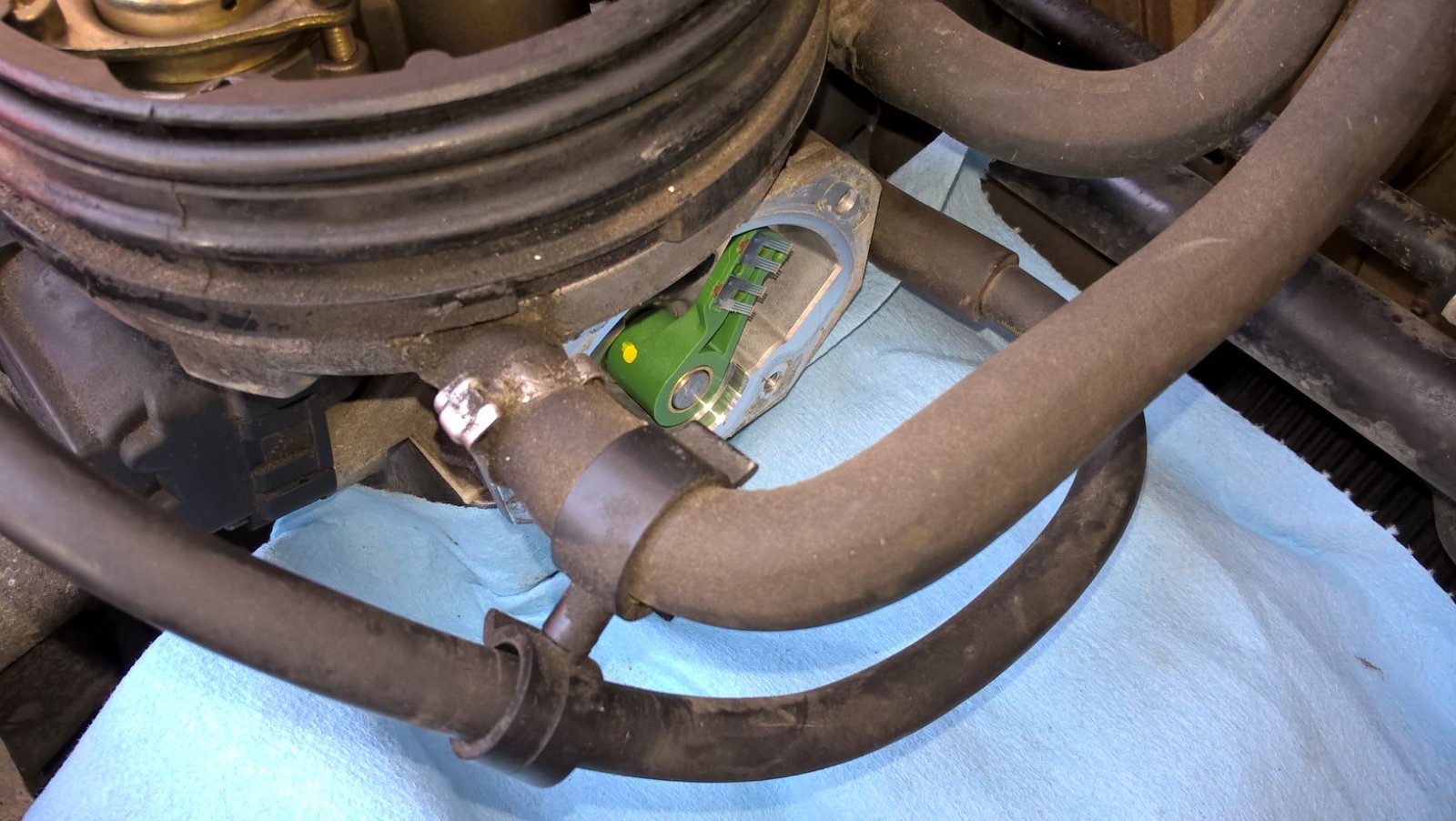

Luckily the four screws did not put up a fight and the pot came off without issue...
Own Work
Own Work
Before I started I used the ELIT to note the butterfly angle and set the new pot to the same figure...
Result is that she now seems to be OK on two road tests and ELIT monitoring...
She also appears to be running smoother and better too :D
