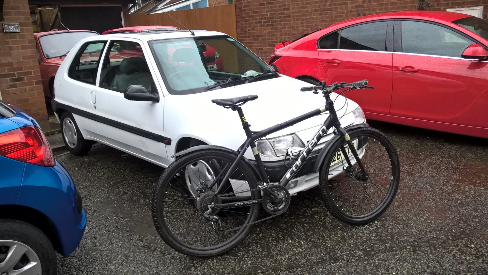

I went out for a long trail ride on my hybrid bike today and as a result she ended up rather dirty...
I had to wash her so whilst I was at it I gave Sally the Saxo a wash too as she was equally mucky. She was covered in that horrible greasy traffic film...
She scrubs up really well and looks a real treat now :D

Just as I'd finished washing her the heavens absolutely opened and tipped a monsoon-like hail of sleety rain all over her, my bike and me :twisted:
It did a great job of rinsing her off :)

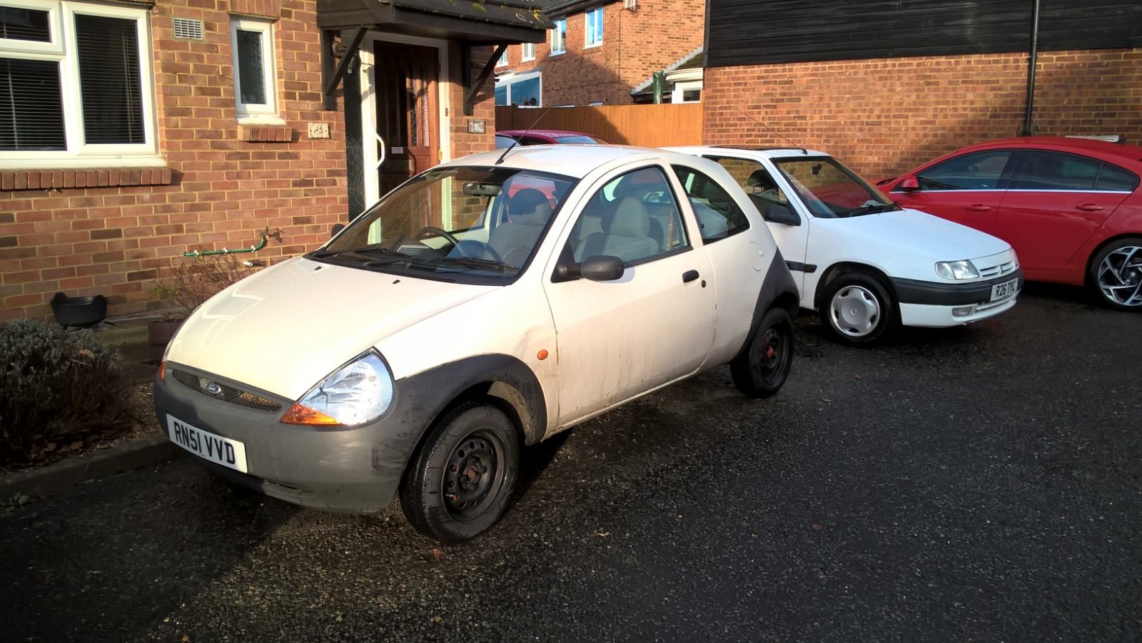

The 207 is now sold and this has appeared in its place :lol:
Own Work
Own Work
Not sure of its ultimate fate just yet...
Watch this space ;)

Michel
Re: Citrojim's Skoda, Saxo and Bike Tales
Unread post by Michel »
Have you noticed the name badge on the back yet Jim?
Posts: 55138
x 8417
Michel wrote: 01 Jan 2018, 15:09 Have you noticed the name badge on the back yet Jim?
Yes, I have :lol: It made me howl :)
It really is a hoot Mike.. It drives like a demented go-kart :o
