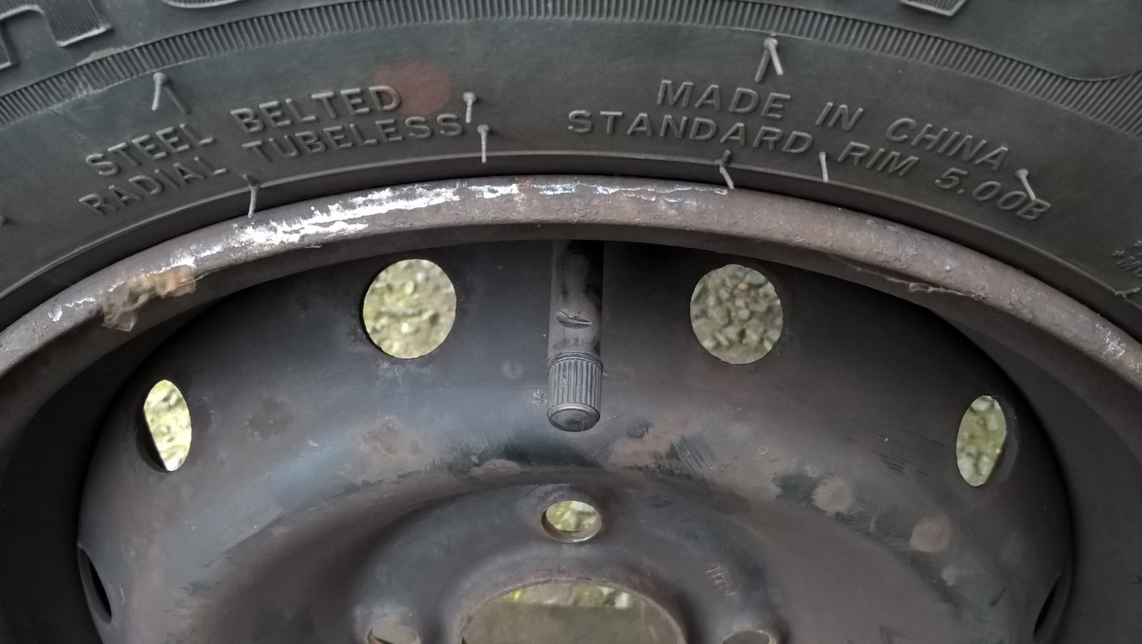

I gave Sally a good check-over for her MoT in January...
I found absolutely nothing that might cause an MoT fail... All looks good but I did find a wear/chafe mark on one of the front wheel tyre valves...
I have a feeling it was caused by the wheel trim being incorrectly fitted so that the hoop in the annular wire did not properly loop around the valve...
When fitted properly the wire is a long way from the valve...
I'll have a new valve fitted in the next few days...

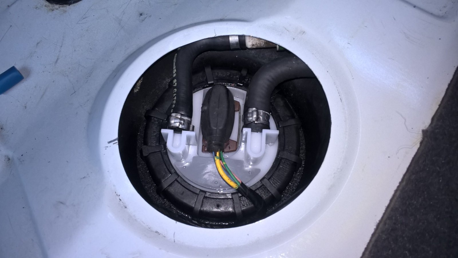

In my continuing hunt for the cause of the poor running shortly after a half-hot start which clears with a switch off and on of the ignition, I swapped the fuel pump...
It's quite a straightforward job but it is made a little hard by the access hole under the back seat only just being big enough... I did the job and then realised I'd not recovered the rubber tank seal from the old pump and fitted it to the new one so I had to do the job almost all over again
I also dropped one of the pipe clips in the tank and had to dip my hand in and fish it out
Needless to say, it's not fixed the issue
But... Watching ELIT live data I note that when the fault is present the mixture goes very weak - signified by the oxygen sensor signal being static at around 0.1V... The ECU makes no attempt to richen it up.
However, switching off and immediately restarting restores normal operation and mixture regulation then works normally and the oxygen sensor signal nicely swings between 0.9V and 0.1V...
Given the mixture went so weak when the fault was apparent made the pump a good suspect but at least that's another suspect off the list...
The ECU still throws an intermittent throttle pot fault when the fault occurs - but why when the engine is started from half-hot and not stone-cold?

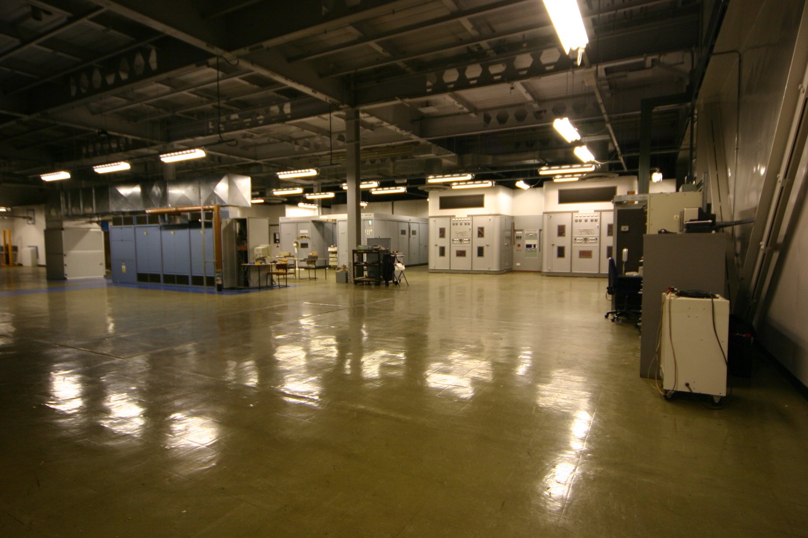

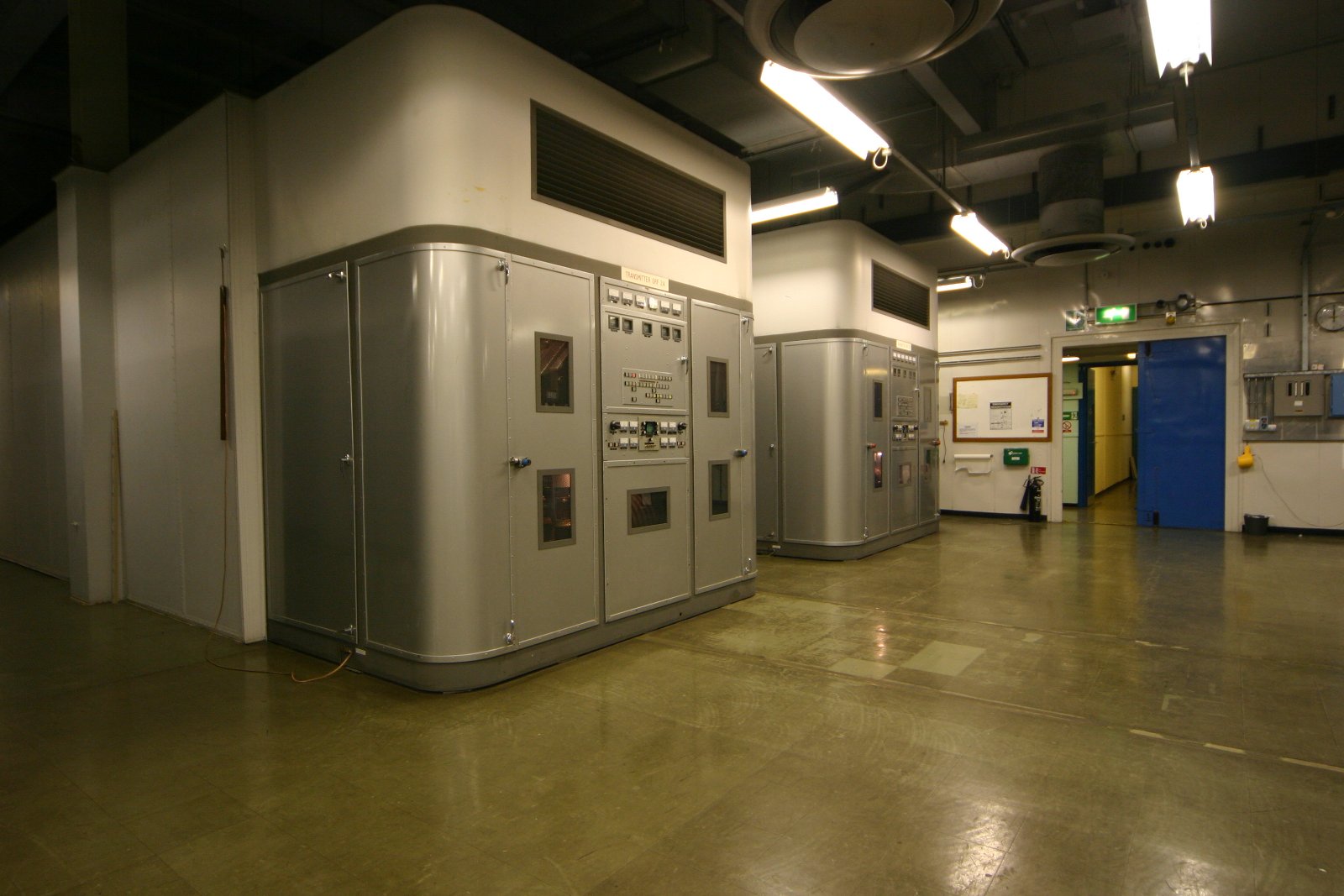

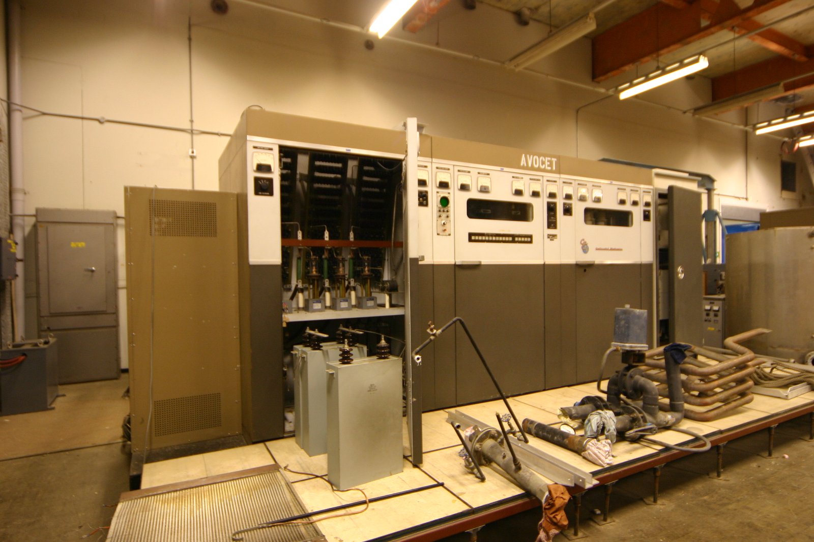

I know I've posted them before - but I believe these are part of them oldy-worldy World Service transmitters at Orford before they were removed

I know I've posted them before - but I believe these are part of them oldy-worldy World Service transmitters at Orford before they were removed![]()
I believe they may be the old Docherty 250Kw rigs Bobins... Two could be paralleled to make 500Kw when required
Now those are proper transmitters... Some difference to the 10Kw Caroline are currently running!

What part do you reckon these played in the Orford site, Jim ? They don't mean much to me !
And a slightly larger view of the hall....

bobins wrote: 24 Dec 2017, 17:50 What part do you reckon these played in the Orford site, Jim ? They don't mean much to me !
I'm not 100% sure but the Avocet has some jolly hairy capacitors in it and to me it looks like it may power distribution/control equipment. The multitude of meters along the top of it strongly suggests that...
It's not a transmitter as there's not great big thick feeder coming out of the top of it...
If not for power control it might be, going on the fact it has a little oscilloscope on the front, a high-level AM modulator for the transmitters...
I will do a bit of research and see what i can dig up...
