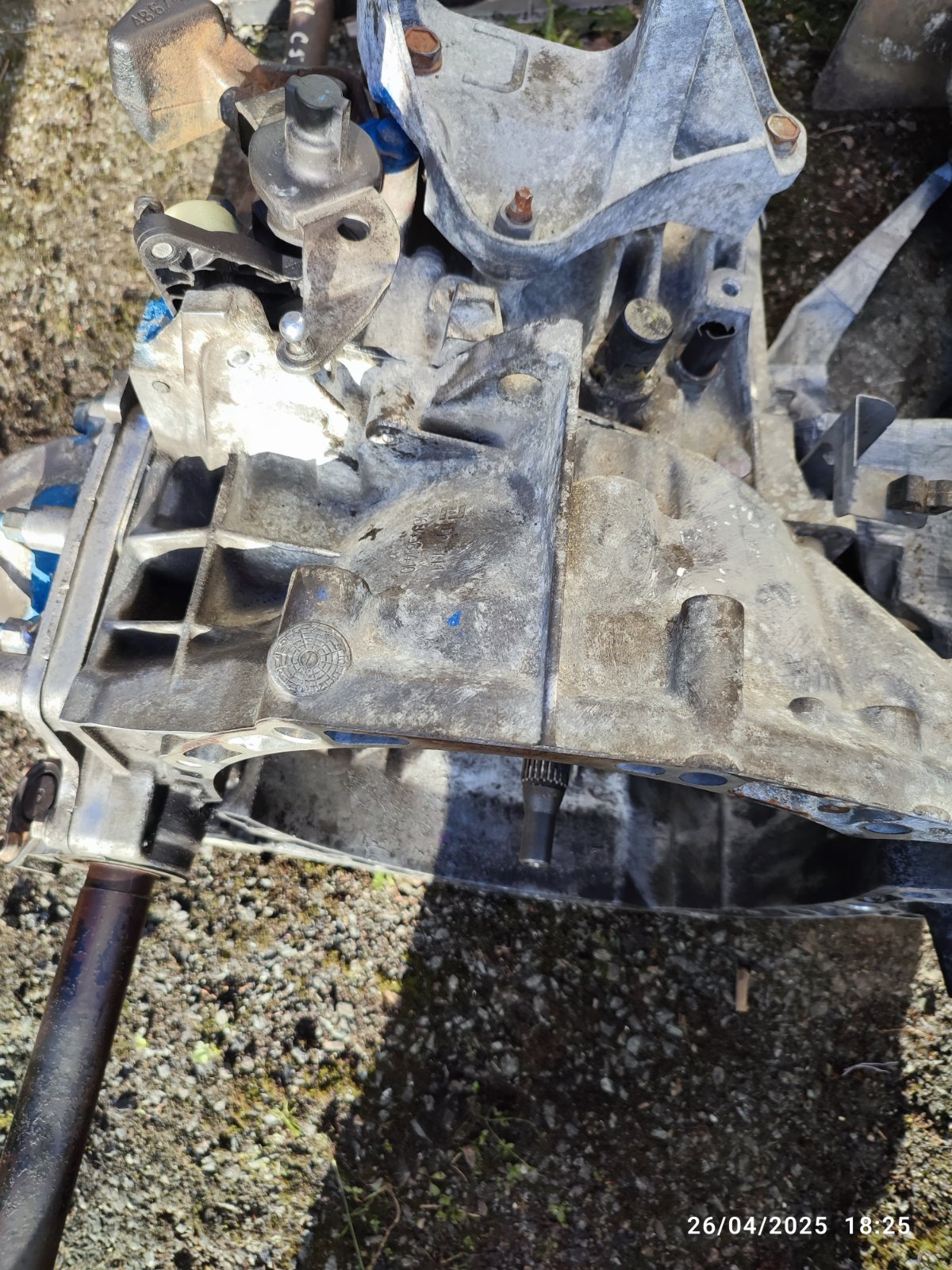

I got the call to go pick up the gearbox so went and got it and a lh Drive shaft. It's a 2013 gearbox with 153000 km so happy days. Silky smooth as far as I can make out. I can't find anything obvious wrong with it so without stripping it I can't say it's bad which tells me it must be good? I'm not taking it apart to find out. I'm going to pull the engine and gearbox on Monday evening hopefully. I cleaned up the gearbox see pictures. It was filthy so I wasn't putting it in the car like that. I didn't take before pics just after. Still not perfect but a million times better than it was. My house is surrounded by big leylandiis which I hate with a passion which cause moss to grow all over my tarmac as you can see in the pictures. I got a quote to cut them down. €30000 I was quoted and that was them leaving the waste. Bain of my existence.

Completely agree on the Leylandii Darren... Hateful thigs and little more than triffids...
Gearbox looks good :D

Your showing your age now Jim🤣🤣 with triffids. They were terrifying to me as a child. Hilarious when I look at them now.absoloutly despise leylandiis, they get out of control so fast. They still haven't banned planting them here, they grow from 14 to 30 feet in 5 or six years. I was sick for the best part of a decade so couldn't get to them.i'm all good now but half of them are out of control now. The gear box looks pretty good so I'll get to it this week, weather is supposed to be ok for the rest of the week. Couldn't work on it last night. SWMBO is after coming down with a dose so on dinner duty.

Gearbox looks good and good luck. Leylandi are real pain remember cutting them down in an other property. What a difference with daylight in the house once done.
