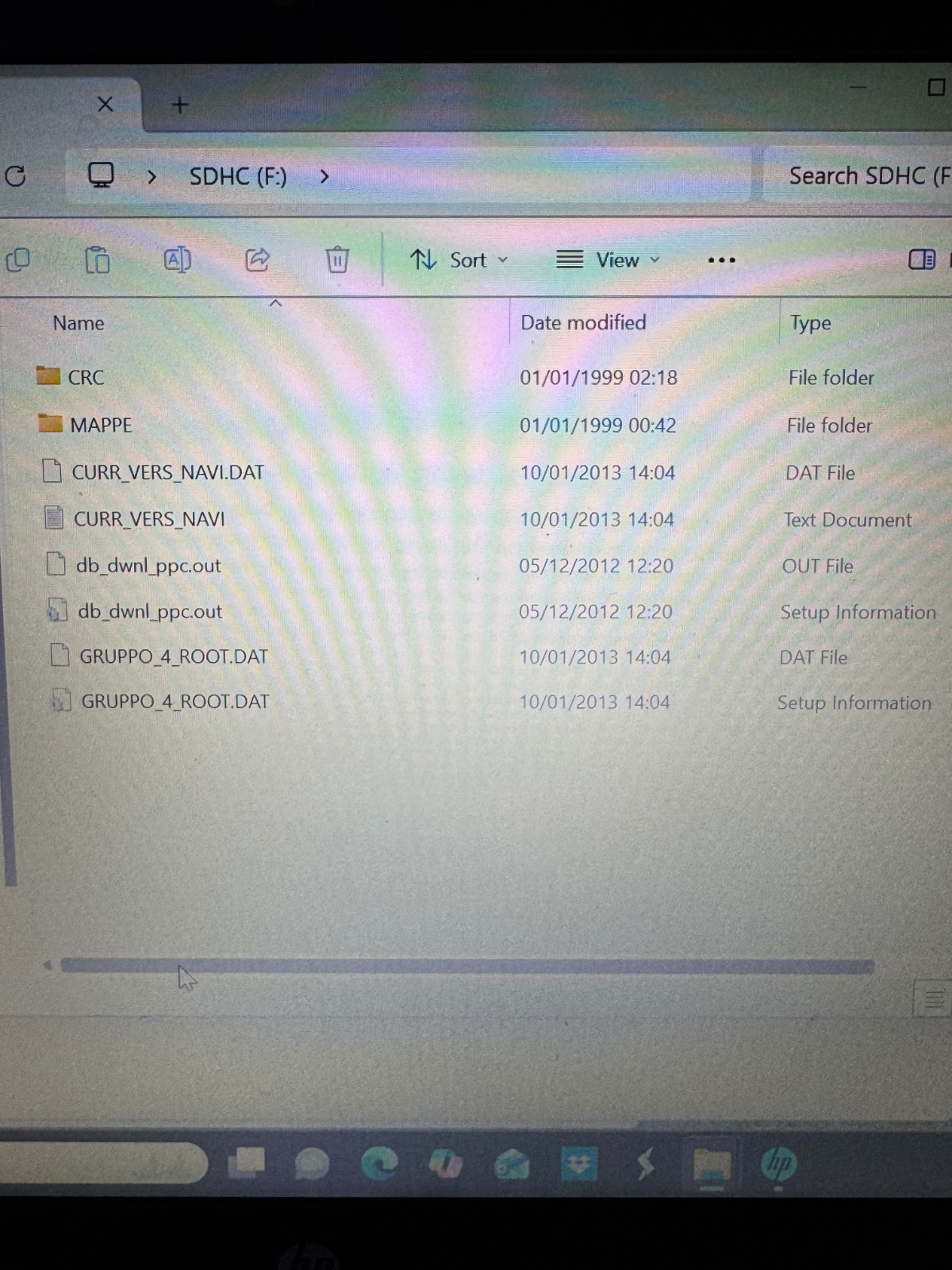

Do you still have the microSD? If so, it might be worth plugging into a PC and taking a screenshot of the file structure?Yas247 wrote: 23 Jan 2026, 14:25 I couldn’t back up as the micro sd was already corrupted and the 5008 doesn’t have a usb (unless it’s well hidden).

I’ll try asking the stealership to download the configuration file for my vehicle from the Stellantis servers as paul suggested, but it’s difficult to try and explain to the receptionist who answer the call.

Yes I still have it didn’t think it was possible to get anything from itRhothgar wrote: 23 Jan 2026, 14:26Do you still have the microSD? If so, it might be worth plugging into a PC and taking a screenshot of the file structure?Yas247 wrote: 23 Jan 2026, 14:25 I couldn’t back up as the micro sd was already corrupted and the 5008 doesn’t have a usb (unless it’s well hidden).

Well! If you can post a screenshot of the contents that might help someone to make an assessment. Having no moving parts, makes me think a low-level read could be done with perhaps something like EaseUS Data Recovery free version. Just a guess though.Yas247 wrote: 23 Jan 2026, 14:32Yes I still have it didn’t think it was possible to get anything from itRhothgar wrote: 23 Jan 2026, 14:26Do you still have the microSD? If so, it might be worth plugging into a PC and taking a screenshot of the file structure?Yas247 wrote: 23 Jan 2026, 14:25 I couldn’t back up as the micro sd was already corrupted and the 5008 doesn’t have a usb (unless it’s well hidden).

Sorry not had a chance to do this till today here’s what’s on the previous card, is they likely a chance I could copy the relevant in on the newer one?Rhothgar wrote: 23 Jan 2026, 14:55Well! If you can post a screenshot of the contents that might help someone to make an assessment. Having no moving parts, makes me think a low-level read could be done with perhaps something like EaseUS Data Recovery free version. Just a guess though.
Thanks in advance
