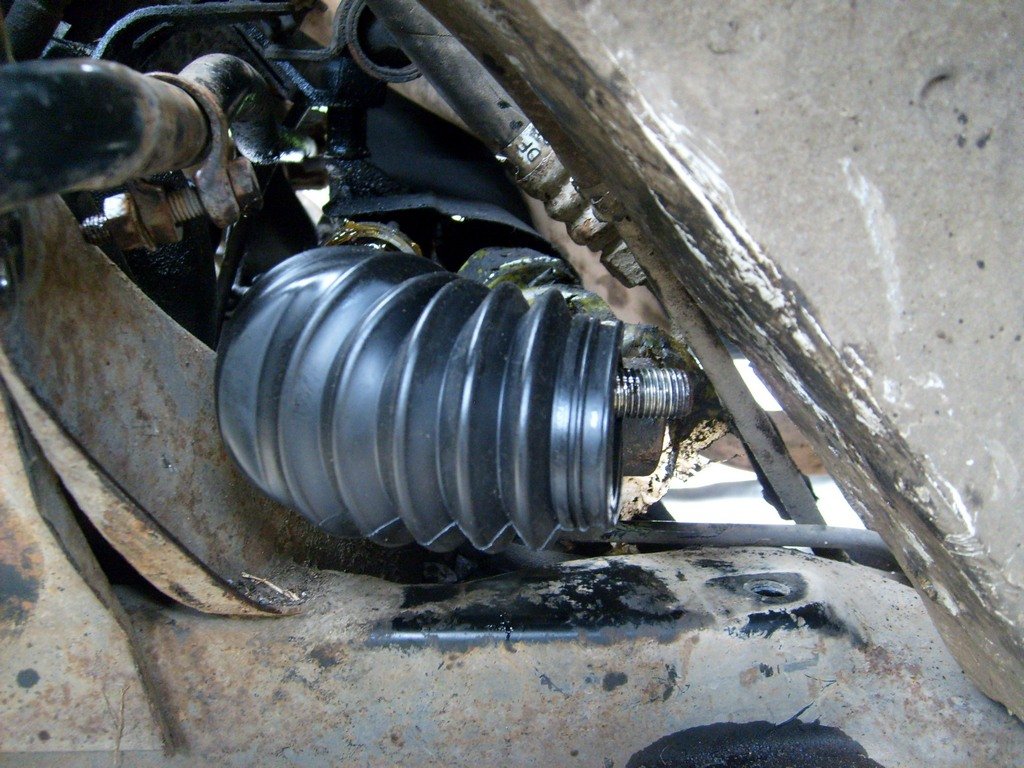

ekjdm14 wrote: 24 Feb 2018, 18:43 .... [Steering Rack Gaiter] there's got to be a better way than just covering the threads on the ram stud and trying to work the thing over that and the inner ball joint, have I missed something and the stud comes off with the track rod or is the cone idea along the right lines?
You were along the right lines, but there is a 'better way' , an Orangina bottle, see my previous post here*. Possibly a bit late for this partic job, but of relevance for anyone else attempting it.

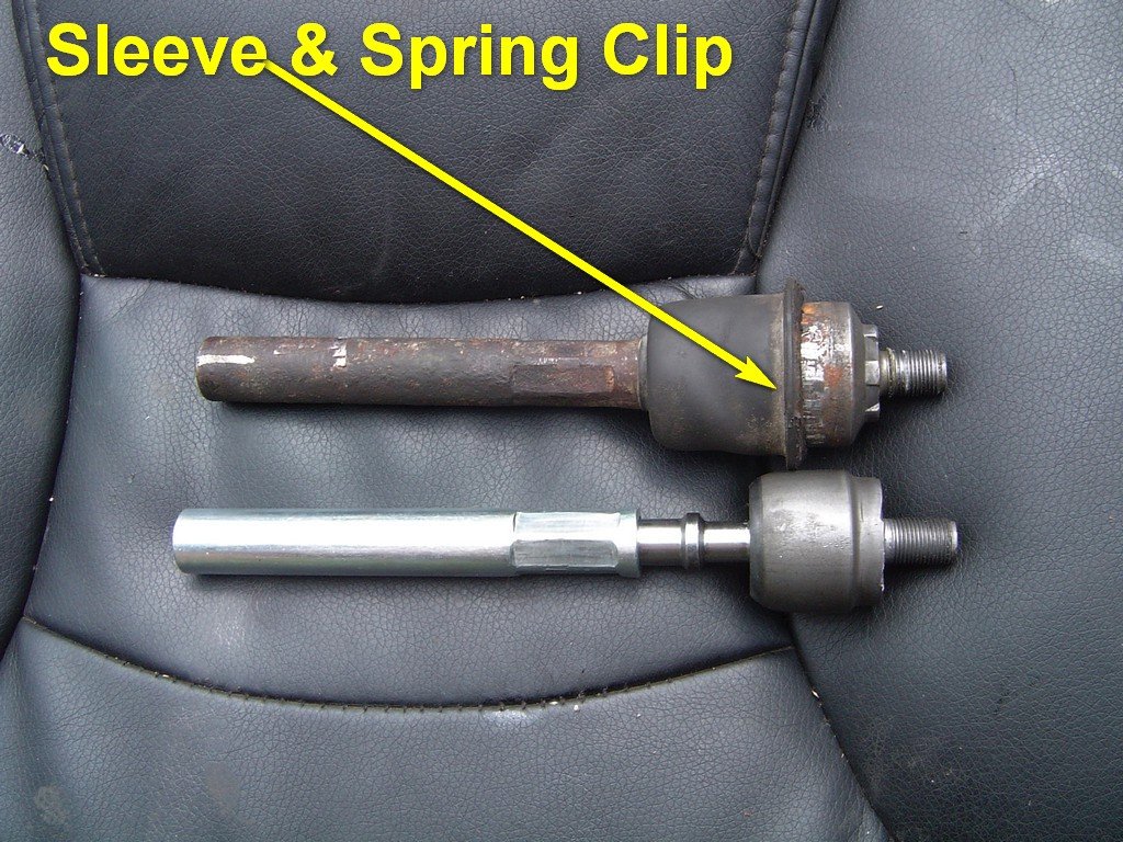

if they've got any tips on how to get the spring wire back in, to hold the rubber sleeve on (of the Inner Tie Rod), I'll be all ears :)
...that's a very interesting point you make about it, unlike most Gaiters, not containing Grease re MOT fail or not, btw.

Looks like it'd be a lot easier a job with the tie rod removed, maybe that's where I was going wrong. Then again, not sure how to go about removing said tie rod & don't fancy disturbing the sleeve on the inner joint either. Will let you know what happens at the garage.
