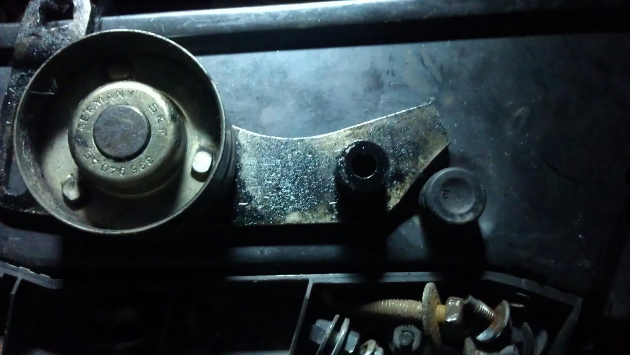

Giving up on getting the auto tensioner inner race out of the aux cradle, I sprayed it liberally with plus gas and moved on to removing the cam belt.
Lying on my back I looked up, expecting to see the spring loaded cup pushing against the end of the tensioner, except I didn't see either.
Not the springloaded cup, nor the end of the tensioner on which it should be pushing!
Goodness knows what's happened in the past, but the end of the tensioner has been hacked off!
Taking the two nuts off it's pivot stud actually extracted the stud!
So I've got to track down the numbers for the cup and spring, and I'll be checking with GSF to see if their full cam belt kit is cheaper than the belt and tensioners seperate (I'm sure last time I bought one getting them seperate worked out cheaper).
Thank goodness the tensioner didn't work loose while I was driving her!
