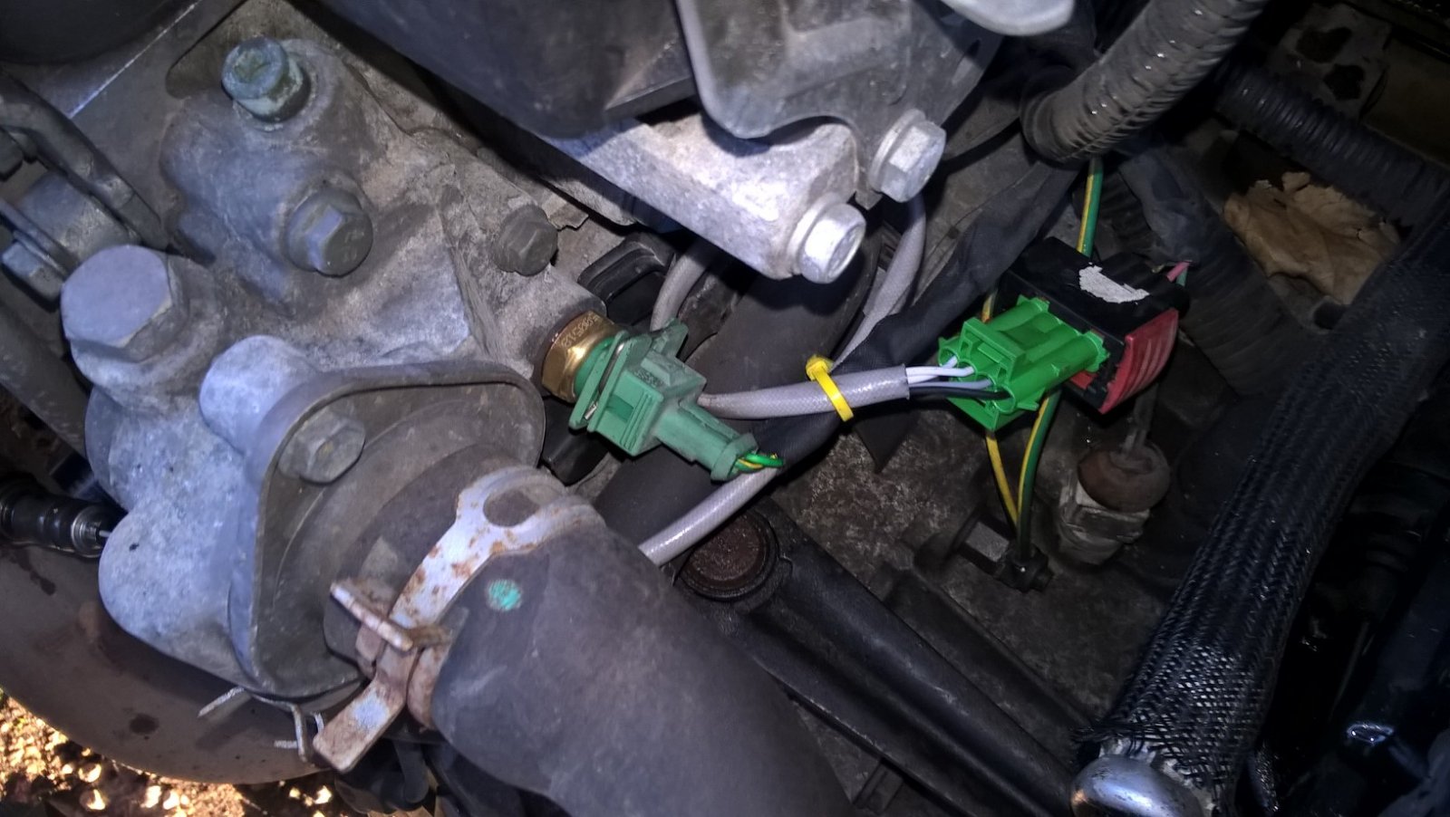

First up was some more work on Sally the Saxo. Sadly, changing her oxygen sensor has not solved her half-hot running issues so the first job I did today was to swap the coolant temperature sensor...
Own Work
Own Work
This has not fixed the problem either but I did catch it happen whilst the ELIT was connected... Nothing looked abnormal when she started running roughly and the only ELIT clue was the raising of an intermittent oxygen sensor fault... Despite the oxygen sensor being brand new...
Switching off briefly and restarting restores normal running and as said, this problem only manifests itself when restarting when the engine is half-hot... A start and run from stone cold does not provoke it and the engine will run perfectly for ever...
It's got me scratching my head... I will crack it ;)

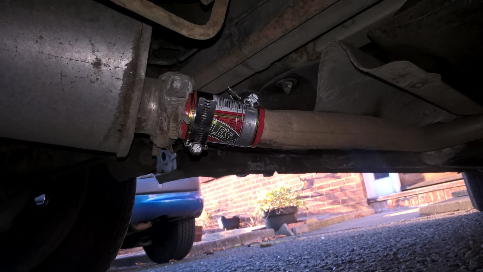

Then I did a bodge on her exhaust. The pipe has cleanly split just about an inch before the back box...
So, until the MOT comes up and I have a new system fitted I did this :)
Own Work
Own Work
The repair material is from a Black Treacle tin... Who said sugar was bad for you :lol:

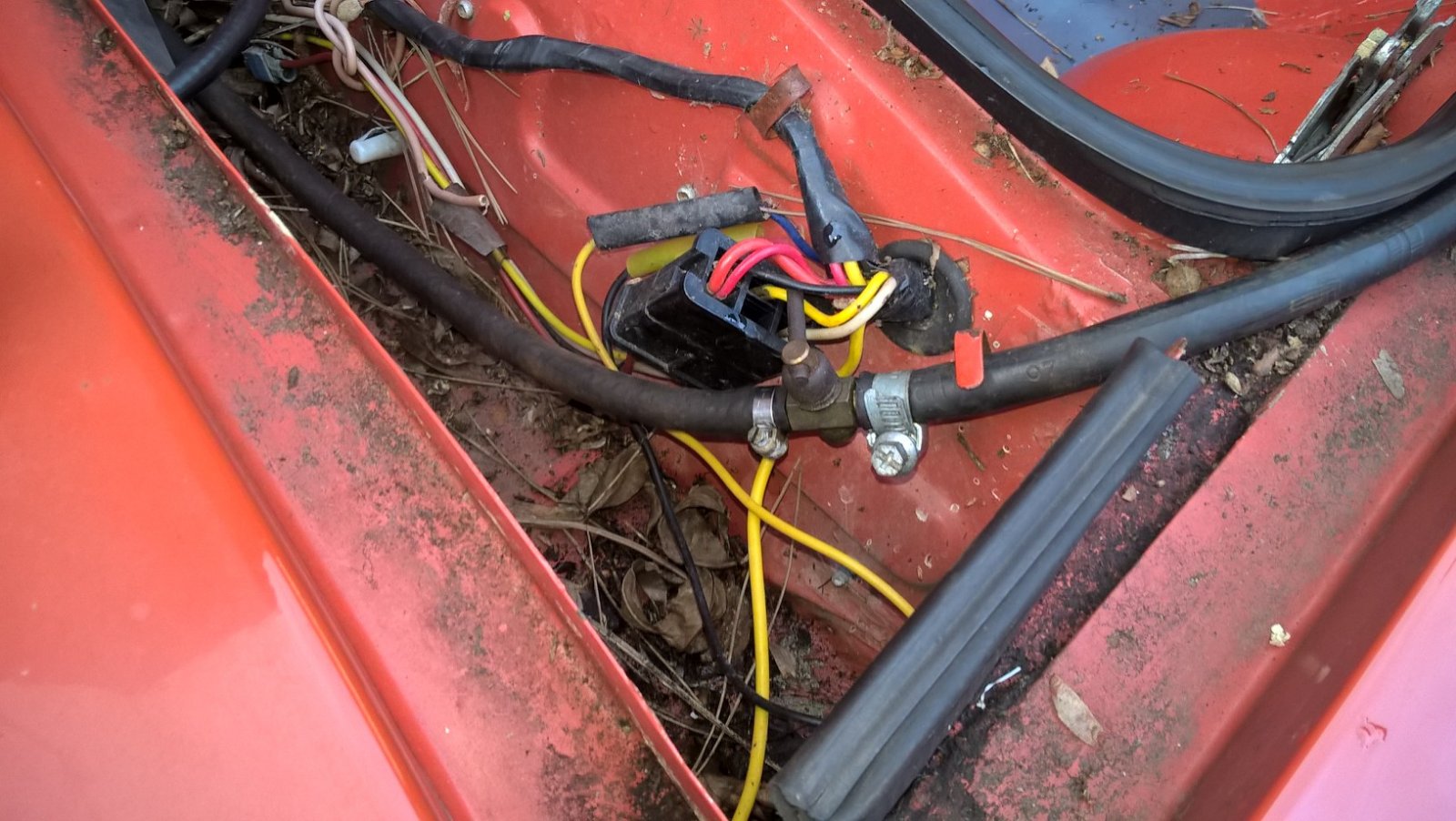

Then I played a little with the Skoda and her cooling system... As Zel has said in the past, her temperature gauge takes quite a lot of excursions between quite hot and fairly cool when under way. Zel has already changed the thermostat...
The Skoda has her rad in the front and is linked to the engine by two large metal pipes that run the length of the car. They in themselves act as a radiator!!! The total cooling system capacity is some 11 litres - that's a lot of coolant for a little 1200cc engine to warm up!
The 'official' bleeding process is exceedingly complex but today I bled it like I'd bleed an XUD engine and determined that coolant is definitely circulating to the rad and back but due to those long pipes and the rad itself being efficient, it takes ages to heat up and get any warm water coming back at all... Eventually I got some warm water back and therefore happy there is a circulation happening...
I bled about a litre of coolant out through the bleed valve near the rad... I really must take a photo of the bleed valve... It's a proper brass tap in a small hose that runs from the top of the rad to I'm not quite sure where just yet!!!
Bad light then stopped play so tomorrow I'll take her out for a decent run and see how the cooling system is behaving...

That bodge will probably pass the MOT - as long as it's not leaking and is secure, it's a pass!

For info Jim, the hose to the one side runs to the upper part of the radiator, other side goes to the top of the heater matrix. I've seen people before replace the single bleed tap with two separate ones which saves having to clamp off hoses and such.
I'd definitely look to modify the thermostat in there to incorporate a bypass hole in it, as I reckon some of the temperature tennis the gauge is currently showing is due to the stat being slow to "see" the temperature change as there's nothing to allow flow over it. The coolant temperature sender for the gauge however is in one of the main water galleries in the head, whereas the thermostat is essentially in a blind alley when closed.
Another common mod (I think there's a guy who even does it for folks at a set cost) is to add a low coolant alarm to the expansion tank. The coolant temperature sender is quite high up in the head, and as such if you have a catastrophic coolant loss, it can show an artificially low temperature for a time until the head gets *really* hot.
The heater supply and return hoses are hidden in the central tunnel in the floor by the way, along with the choke, throttle and handbrake cables and gear linkage. More in there than in most cars!
I had the heater getting properly hot when I was testing the car in a static manner (it's not burning toast hot, but decently warm at least), but as you say the radiator has quite a lot of cooling capacity for a little 1.2 motor...and it takes quite a while for the whole system to reach equilibrium.
Regarding the Saxo, one thing worth checking is whether the O2 sensor heater supply is present and correct. If not that could cause some odd issues.
Also if you haven't yet, clean the throttle butterfly and surrounding area - it should be clean enough to eat your dinner off. Usually is on TBi cars like this though as it's continually washed by the petrol mist.

Coil has already been swapped with no improvement Richard. Coil is shared with the TCT engine so I had a good spare on the shelf...
Zelandeth wrote: 24 Nov 2017, 20:02
Two things I've not done yet Zel... Although looking to the top of the TB it looks quite spotless... I will check again and go a bit deeper...
Good thinking on the Oxygen Sensor heater... I keep overlooking that simple check :oops: I will this afternoon...
Thanks ever so for all the Skoda cooling tips Zel... Yes, on that basis the 'stat definitely needs a bleed hole and at the moment it seems the 'stat is opening and closing like a gulping fish - with no flow past it when closed that behaviour makes complete sense...

Home again and I checked Sally's oxygen sensor is receiving 12v heating voltage... I was hopeful initially as I spotted the heating voltage goes via a 5A fuse... That was OK and a good healthy 12v is reaching the sensor...
Another thing to tick off...

This is the bleed tap for the cooling system...

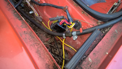

A job on the list is to clear the vegetation from the boot surrounds and bulkhead!
The paintwork is a bit dull and spotty. I think as a result of the disastrous application of Traffic Film Remover Zel spoke of...

After that I took her out for a decent run and whilst initially the temperature gauge bounced from 60 to 100 degrees and back again quickly and regularly after about 6 miles it all settled down and the gauge remained nailed at just below 80 and just into the green section for the rest of the trip :D
It remained nailed to 80 degrees even when I really gave the engine some beans along the A422 and took her up to over 60mph!
It'll be interesting to see how she behaves from cold on the next run out...
The heater started to put out some serious warmth too, once the temperature gauge got stable ;) So much so that I had to turn it down...
So, it looks like the cooling system is OK and more importantly, that the engine and cylinder head is OK... If it was going to overheat I'd have thought it would during a good 15 mile drive at reasonable pace...

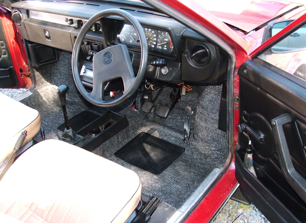

I love the Skoda dash...
Own Work
Own Work
I especially love the green bands on the temperature gauge and tacho!
