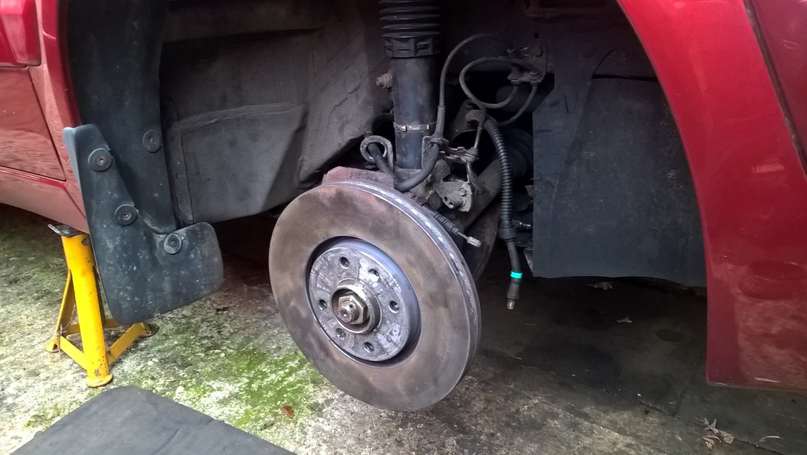

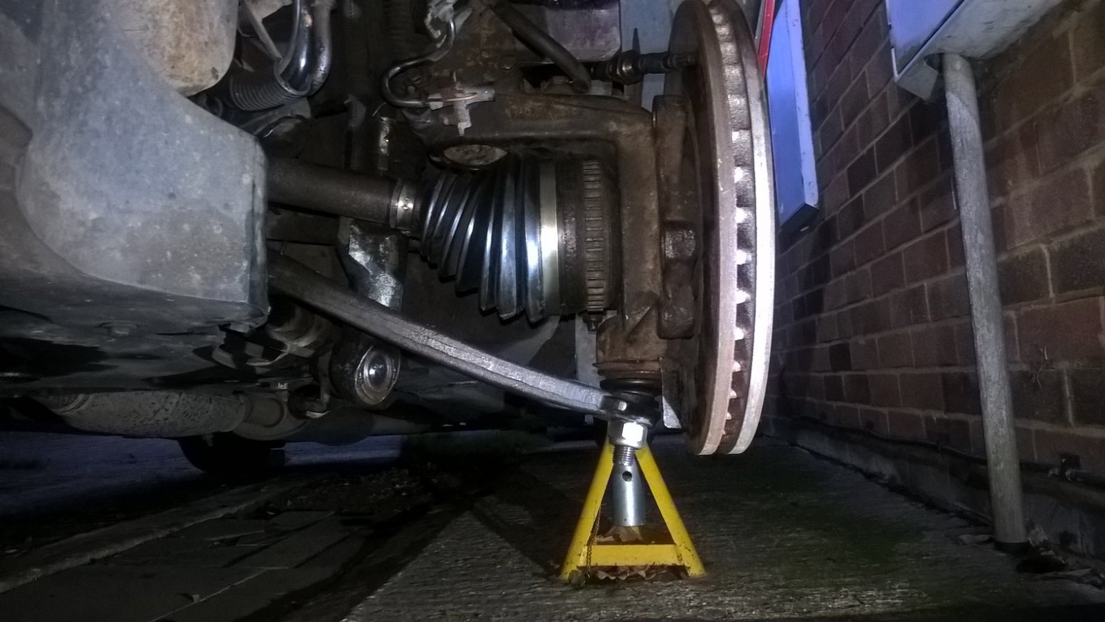

I thought I'd start with the most difficult side and I'm glad I did. After installing the rebooted driveshaft and hub I found the driveshaft was just a mite too long to allow the hub lower swivel joint to pop back into the wishbone
I'd made a schoolboy error
When I knocked the outer CV joint back on the shaft I didn't knock it far enough onto the very tight splines and hence it ended up too long...
Out it all came again and back in the big vice... I measured it and set about knocking the outer joint on further... I got at least another inch
Then it all reassembled sweetly...
This is as far as I got before bad light stopped play
The disc is the beginning of the big brake conversion...
She'll soon be on her wheels now... Weather permitting

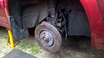

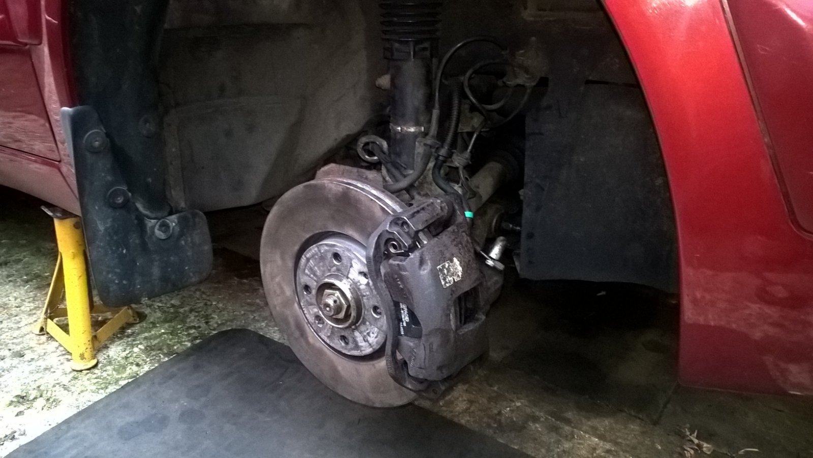

I cracked on a bit, the RH suspension has been rebuilt and replaced on the Activa...
The big calipers have been overhauled and fitted...
Brakes bled and handbrake set up...
Hub nuts torqued up and she's now back on her wheels
She's all ready for her MoT and transfer to her new owner...
Delighted with what I've achieved thsse past two afternoons...
I've enjoyed it too

The big brake conversion on the RH side...

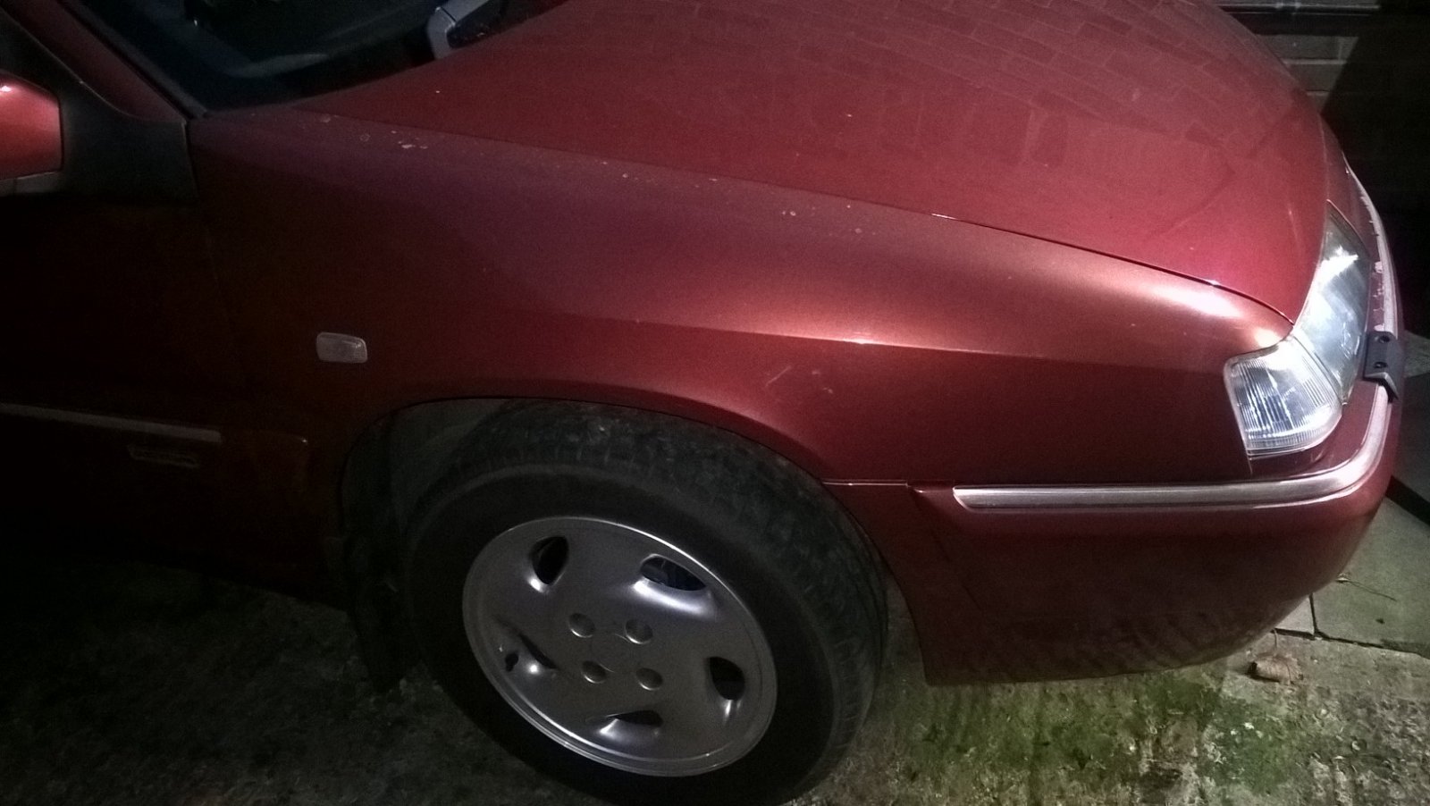

Darkness fell before I finished but here she is on her wheels
