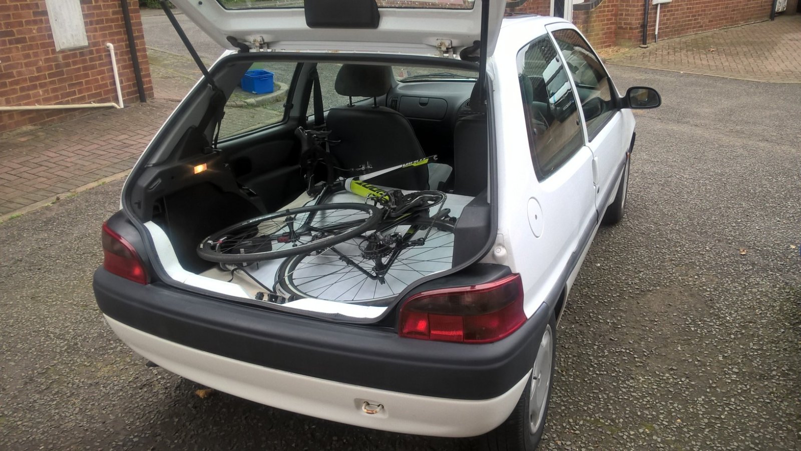

Meet Sally the Saxovan complete with cargo
The back seats are out and a layer of foam and a topping of a cheap windscreen protector sheet from Lidl has made a tolerable cargo bay whilst I get the ply-lining sorted out. Sally will do her first proper duty as bike transporter when we ride the Wiggle Hawker Hurricane sportive on Saturday

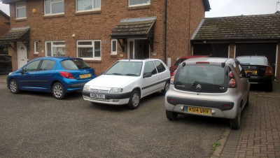

Robyn came over to see me and we got this picture of most of the family together, the French contingent at least! Sian's Pixo is missing...

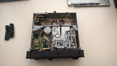

I did have a little play with the Saxo wireless. I successfully removed it with the help of this fine forum
An initial inspection showed nothing obviously wrong. I did find that it works for a few moments from stone-cold and then takes off into slow oscillation (what we in the trade used to call 'motor-boating' back in the day).
I noticed that the power amplifier IC was running very, very hot and if I put my finger on the circuit-board pins in the vicinity the motor-boating would stop and normal operation would resume for a few moments as the IC got hotter and hotter...
I diagnose a duff power amplifier IC... They are cheaply available on eBay and one will be on order shortly...
The wireless itself is a good one and is a re-badged Grundig.
It's well-made too
Definitely worth repairing.
