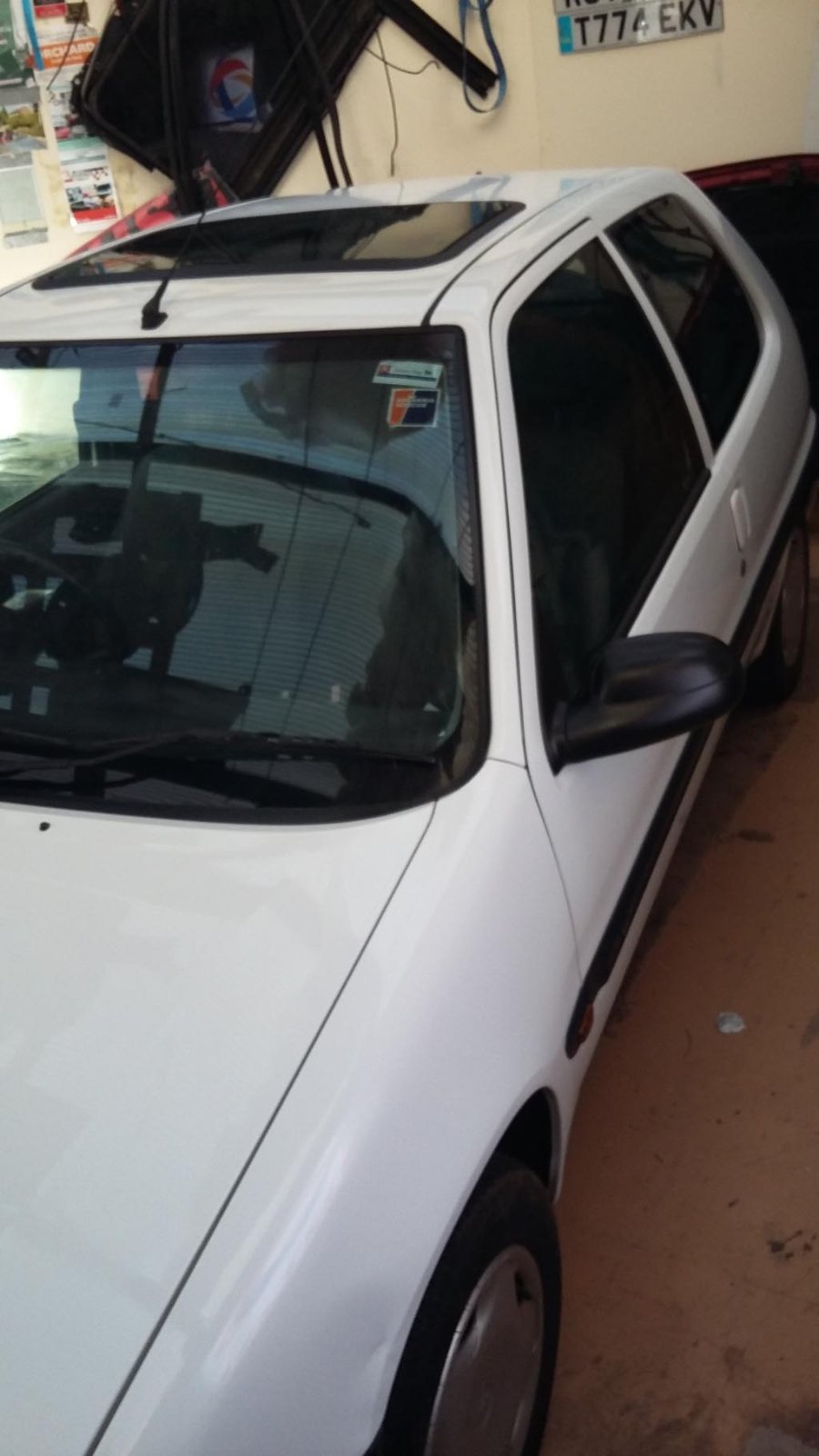

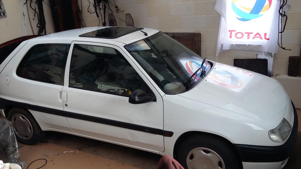

I am calling the outside DONE now.....

That looks spectacular Alasdair :D You have done a wonderful job there!!!
So pleased to see she has a sunroof too 8-)
I'm good to come down on Saturday if that's OK with you ;) My cunning plan worked out with a friend needing to travel to a place not so far from you :)

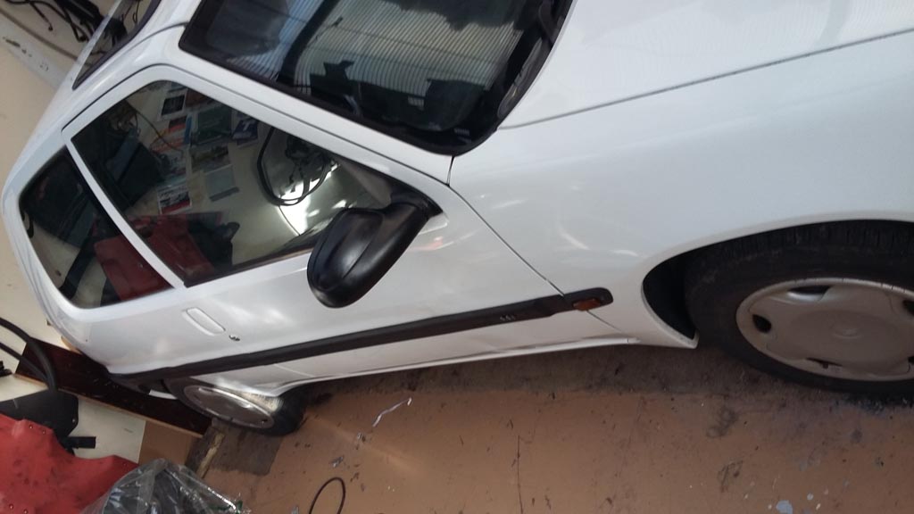

I even painted the windscreen Wiper arms :)....ocd strike !

Stickyfinger wrote: 16 Oct 2017, 17:48 I even painted the windscreen Wiper arms :)....ocd strike !
Alasdair I'm in awe 8-) :-D
I know that on Saturday I'm really going to see one very immaculate little Saxo :)
