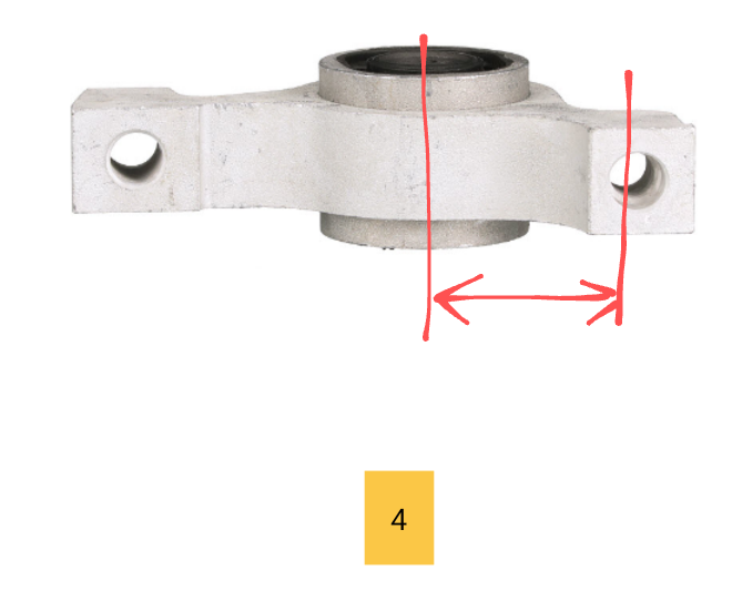

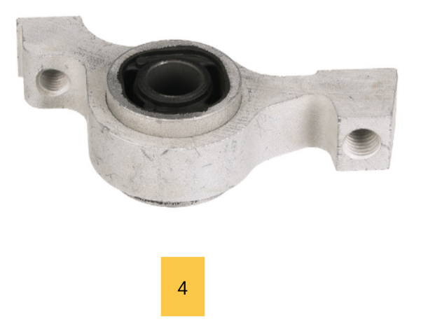

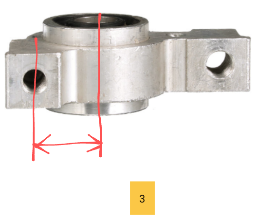

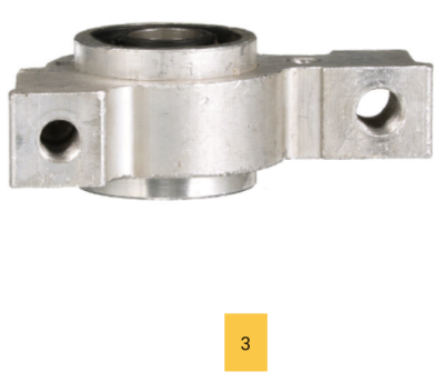

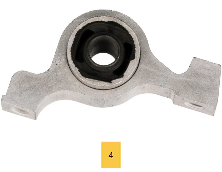

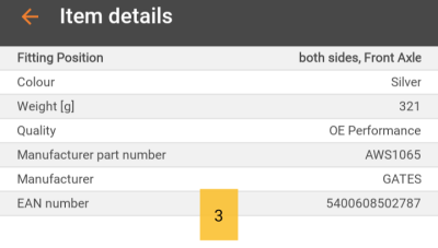

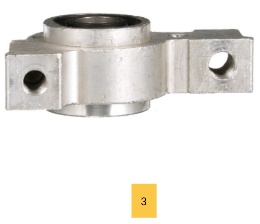

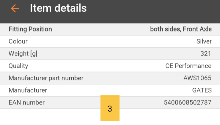

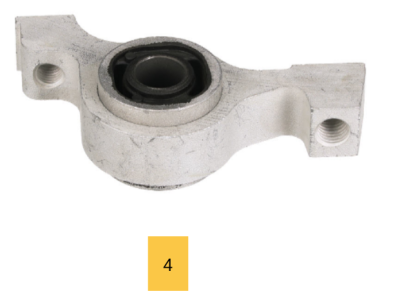

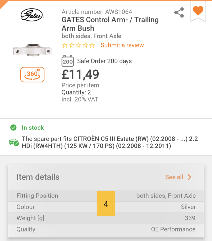

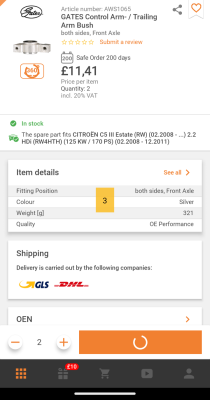

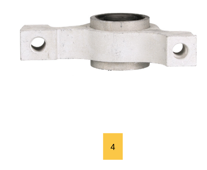

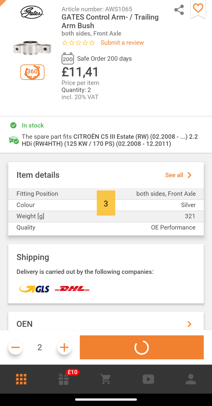

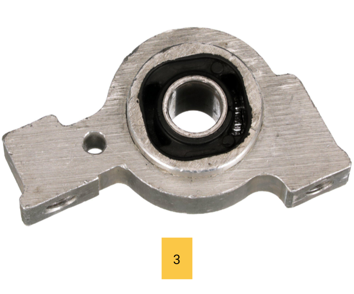

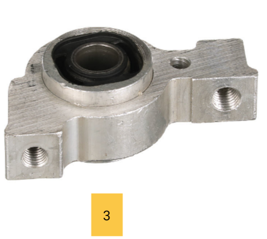

I know what you mean Jim but seems to be two types and all follow a similar design, all the spindly versions look about the same!
EG here are some Gates branded versions of the same thing: And here's the Gates branded other type:

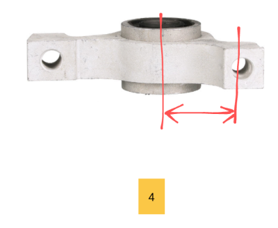

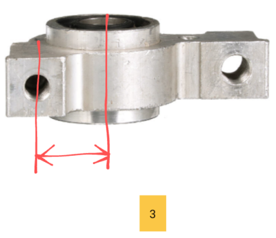

I think between these two there is a difference in the horizontal measurement between centerline of the threaded hole and center line of bush.
I'm sure Up N Down talked about a vertical difference as I'm sure he knocked up some spacers which obviously wouldn't change anything in the horizontal!

4 (spindly) bigger than 3 (chunky)
The above 2 threaded holes both being the nearest one in each case. Not sure about the other one to be honest

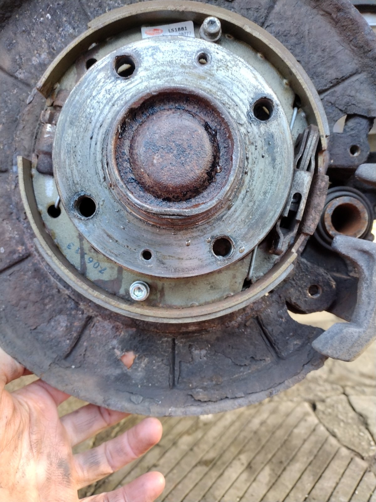

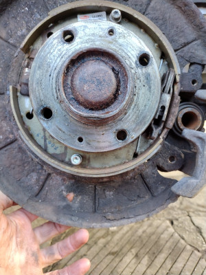

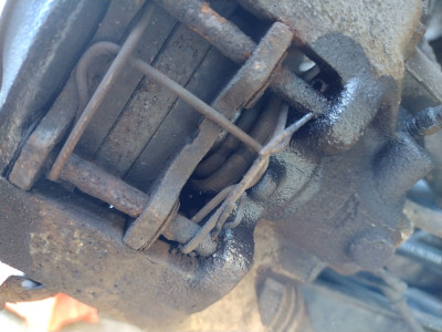

Anyway that car is not the focus of today, instead it's on with the coupe.

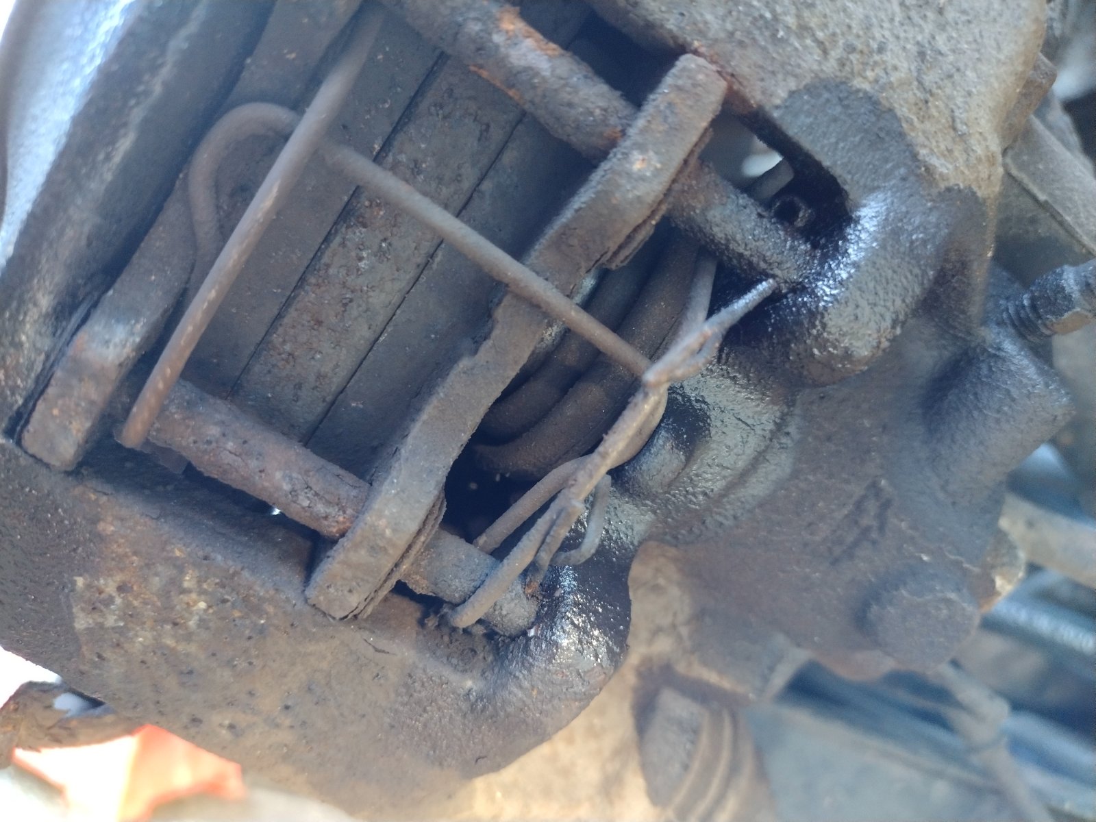

Rear left caliper very crusty and definitely did not want to let go of the outer pad suggesting sliders seized solid. Disk retaining screws didn't put up a fight and the handbrake shoes seem to be cooperative too

You lucky devilMattBLancs wrote: 19 Dec 2023, 11:32 Rear left caliper very crusty and definitely did not want to let go of the outer pad suggesting sliders seized solid. Disk retaining screws didn't put up a fight and the handbrake shoes seem to be cooperative too

Used up all my good luck, it'll be all down hill from here on in!c16rkc wrote: 19 Dec 2023, 11:33You lucky devilMattBLancs wrote: 19 Dec 2023, 11:32 Rear left caliper very crusty and definitely did not want to let go of the outer pad suggesting sliders seized solid. Disk retaining screws didn't put up a fight and the handbrake shoes seem to be cooperative too![]()

Pleasant surprise, handbrake mech looks near new!
Disk dust backing shield looking more like 21 years old (hence buying new)

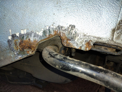

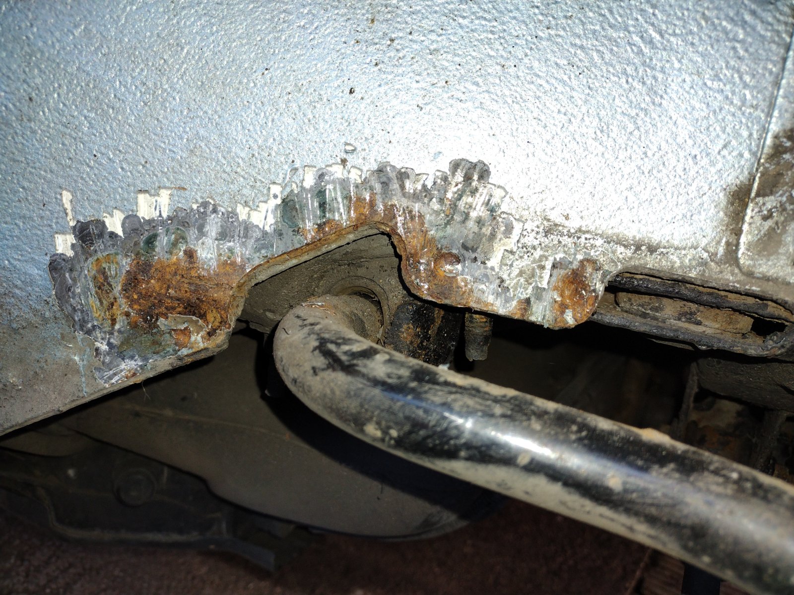

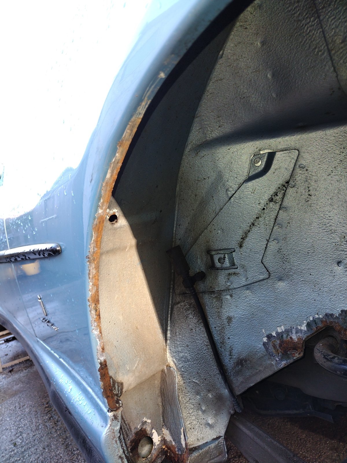

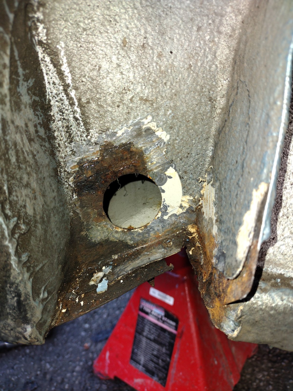

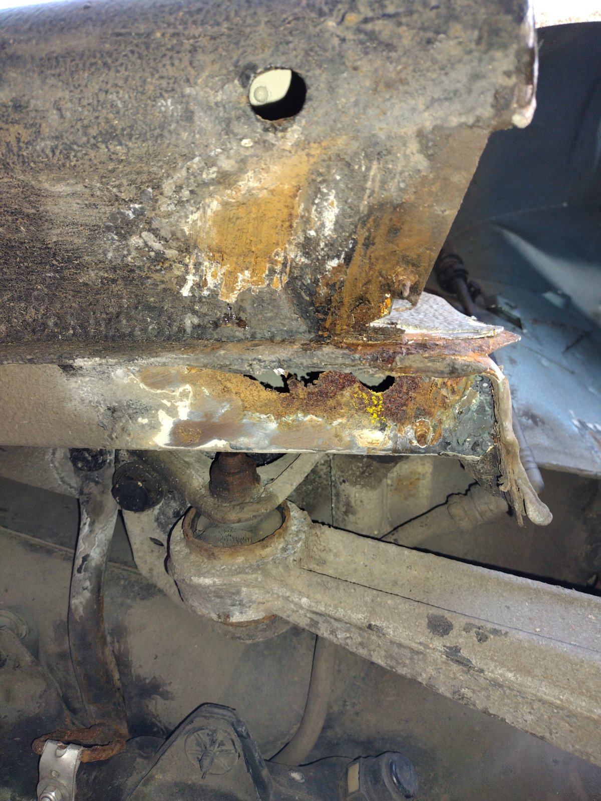

So, a bit of a look at the rust
View from in the wheel arch End of the sill, viewed from below Speaking of wheel arch, this bubbling paint had to be scraped off. Needed to understand how bad it was.

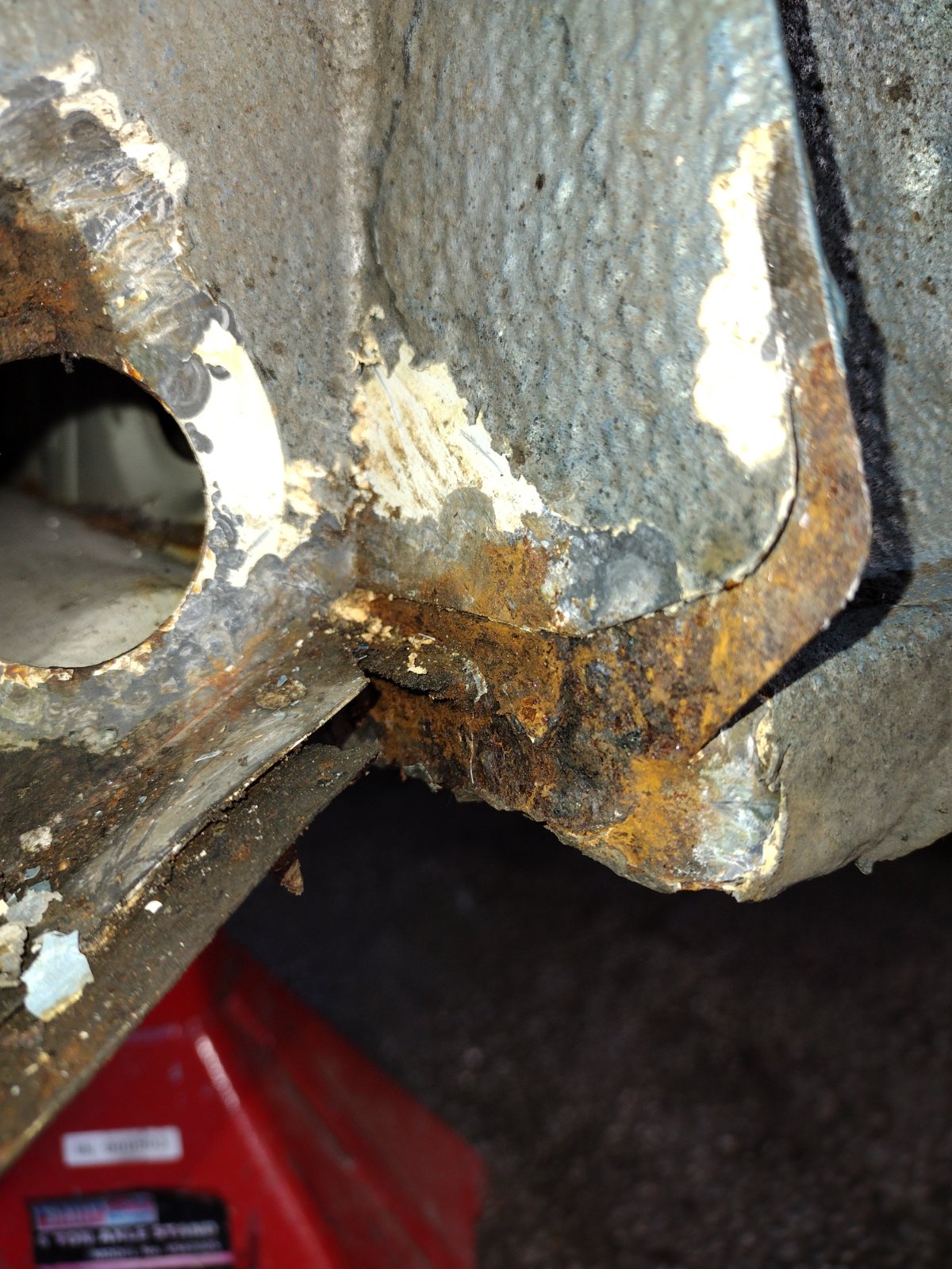

A random scratch deep through the underseal halfway up the inner arch has initiated some rust, just a touch. No idea how that got damaged as hidden behind the plastic liner.
I gave the old caliper bleed nipple a simultaneous tap tap tap with a hammer and applied a little torque with a open-ended 7 millimeter spanner. Much to my surprise it did unscrew rather than shear off.
Brake hose Union seems much less cooperative and is on the verge of rounding even with 11 millimeter crows foot.
Think I need to source a bunch of new fittings before attacking that with the big mole grips.

The edge of the arch doesn't look too bad what can be seen currently has only been revealed by hand with the end of a flat screwdriver. Treatment for that and the bit near the anti-roll bar planned as follows:
Clean up with power file to good metal,
Treat with phosphoric acid,
(Wipe down with water to neutralize, then dry)
Brush apply Zinc-182 to "all the small things"
- Spoiler: show
