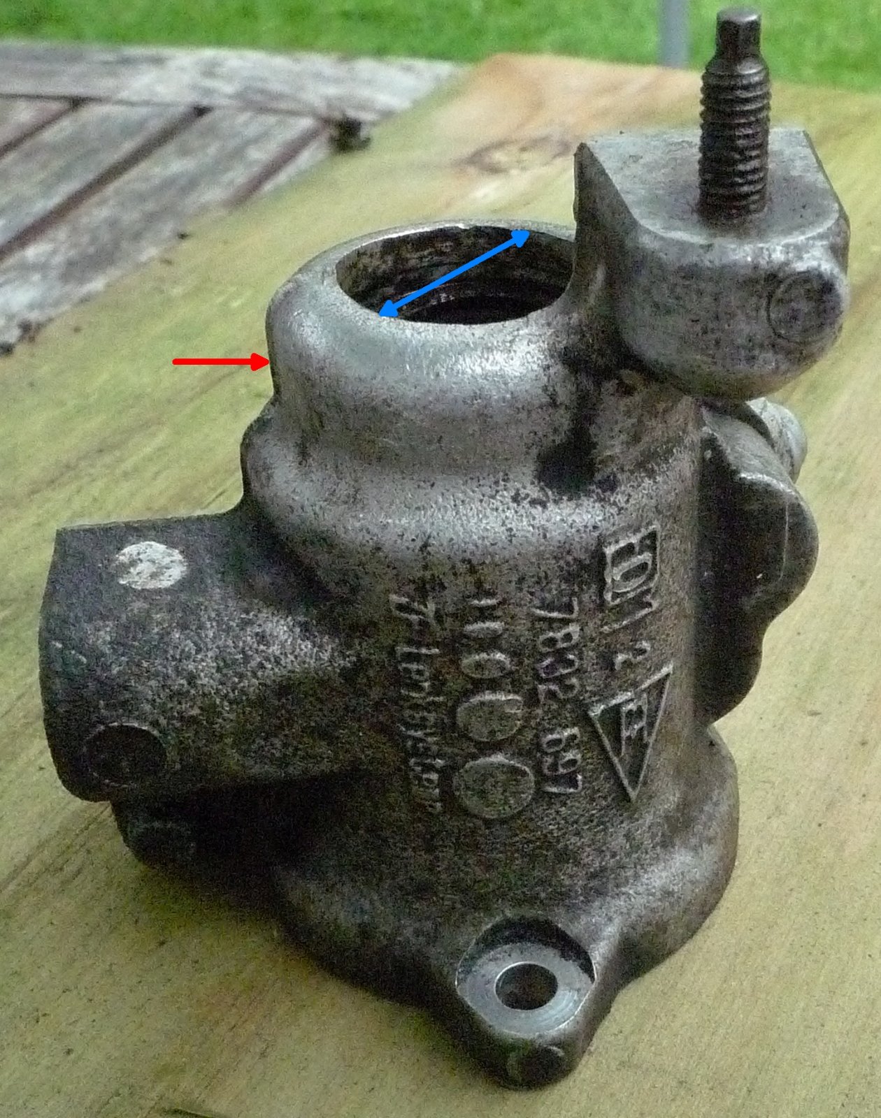

bobins wrote: 14 Jun 2018, 17:29 The diameter at the red arrow is 40mm. The internal diameter where the dust seal sits (blue arrow) is a good old fashioned inch.
Hi lads,
Stupid question does the bolt on the lump serve any real purpose or do I need to be careful of it.? What I mean is it a locating pin for the rack. I know it has been discussed to death but I am making sure I am not Missing anything in my planning.
This may help as well for anyone else who is going on this endeavor.
Darren

darbuck wrote: 10 Mar 2023, 20:01
Hi lads,
No stupid questions in my book. Am sure I have read something that did say why the redundant lump / stud is there (will have to have a dig as can't recall the answer!) But my understanding is it's not on our models - that sets me wondering if the C6 uses same rack as I know there's an extra layer of suspension magic on those (variable orifice valve, gives variable damping I think, can't recall the name of it) - if is common rack to C5 and C6 that could explain it.
I've also read of someone who machined it off on the lathe (the whole alloy lump, not just the steel stud) and am sure of another who used a CV stretch boot to fit over the lump left as is.
Definitely not a silly question, can't "over plan" if you ask me and the more we know the higher the chance of success! :)

Thanks Matt I plan to remove the lump and fit a silicone gaiter when complete I think cutting it off is the way to go. I am concerned about lining up the shaft but I should be able to mark the tooth to the valve block before fully separating it. Rust will spread so rust remedy and chemical bonded sleeve is my plan for the exposed section. I have the luxury of another car for the moment but I need to get it on the road or it will be divorce courts I think 😜
I think the C6 rack is completely different if memory serves me right plus the C6 are rarer than x7's here.
A bit of a unicorn.
I am hoping to develop a permanent fix. I think we will need to consider finding a method to sleeve the exposed section of shaft as inevitably the boot will fail.
As how to do this is another question paint is not a great solution to me given the propensity for rust I don't mind reverse engineering but like you I didn't expect so much of it on one car.

Redundant lump: Agree it's in the way and a gaiter/ boot/ etc is much more likely to get a good seal with the housing taken back to a round cylinder. There's a lovely picture of one that was chopped off then made round in the lathe, think that would be the gold standard.
Having thought about that, if going to the trouble of getting it mounted in the lathe (4 jaw or face plate I'd think given shape of the bit which interfaces with the rack) I'd consider machining in some grooves etc to give something to properly clip the boot onto.
