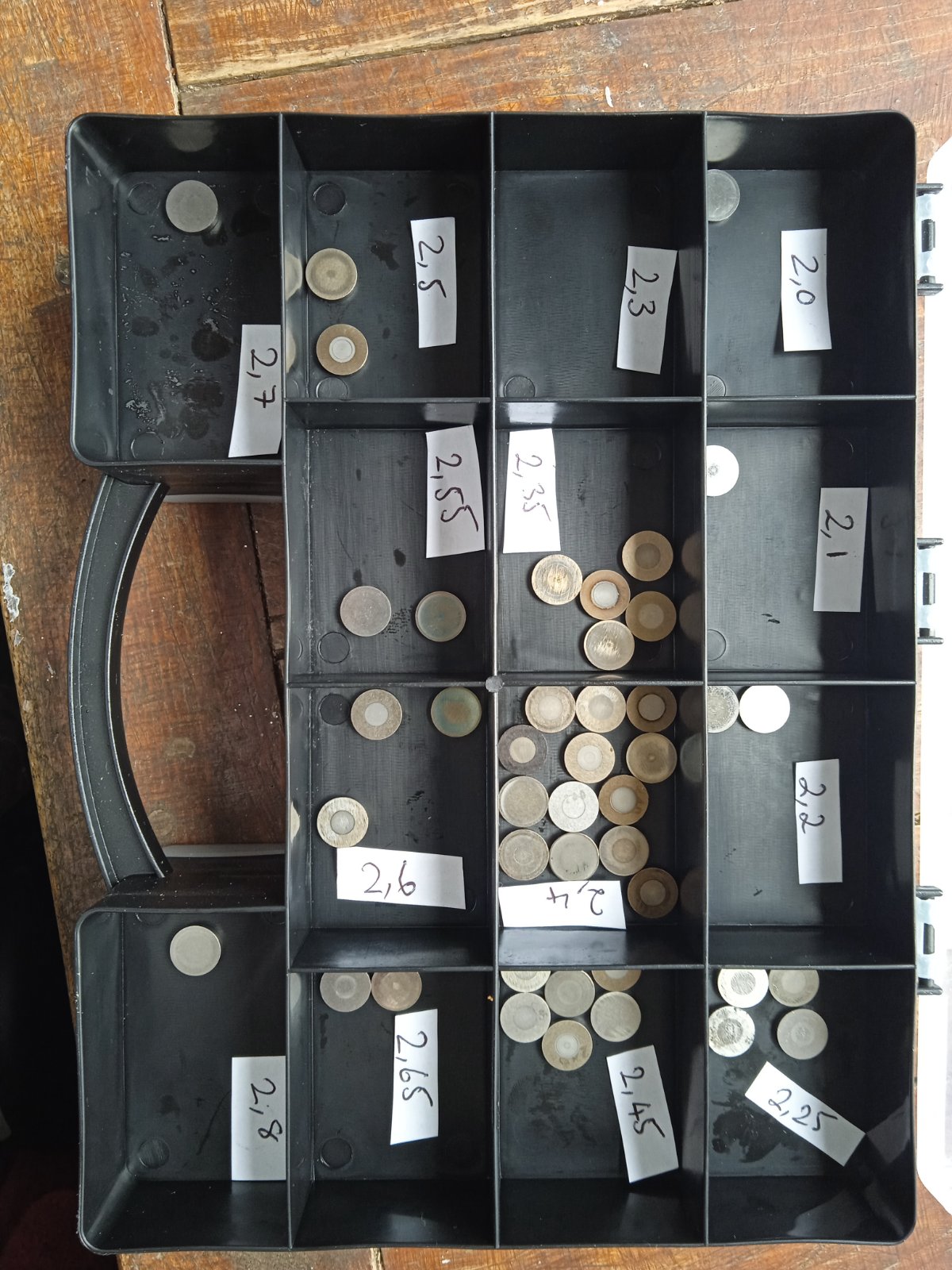

Im on the home stretch. Lapped in new valves on the new head, bought a 13mm shim set and set all the valve clearances. A long night I will member.

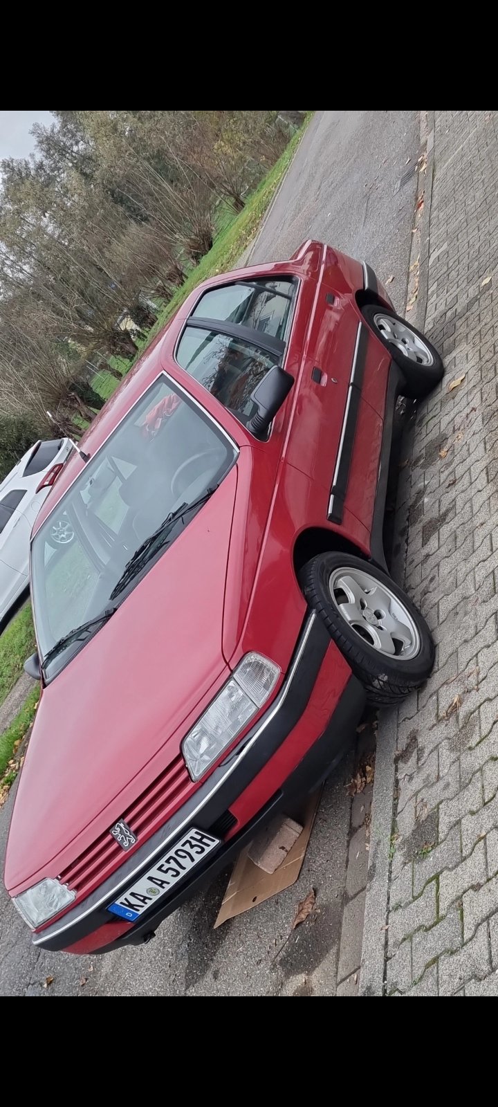

Right, finisched it up and took it for a drive.
Drives great, amazing to drive it again.
Really love the New rims, if anyone noticed the cardboard underneath, I still got to replace the valve cover breather hose.
