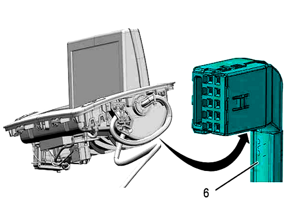

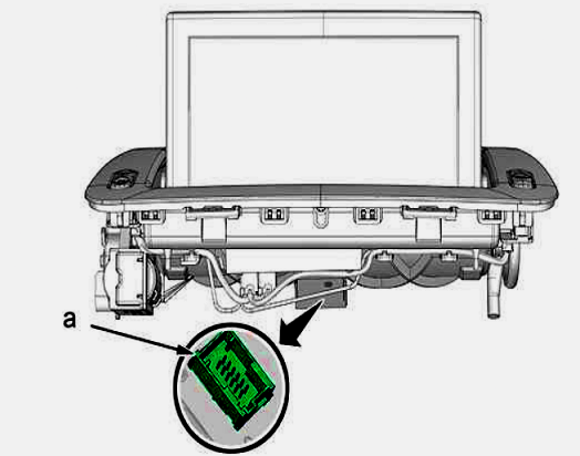

Re: NG4 oh no it's not well.
The first connection is the main 12 way connection to the unit and the second is the LVDS connection.
If these are all in place then either you have a faulty NG4 or it has not been configured correctly for your specific vehicle options - parking assistance, equaliser amplifier, services module etc. etc. All these options should be checked in the BSI to ensure they are all set correctly as when the previous owner put that bloody android unit in, he may of changed some of the configured options and mucked it up to get the android unit working.
Now that you're reinstating an original unit, there may be some settings that need reverting back.
The only way to do this is to get Diagbox on it and check through all the BSI option pages. If you can do this with clear screenshots and upload them her to the forum in order, page by page, I may be able to check if there is anything incorrect that needs changing.
