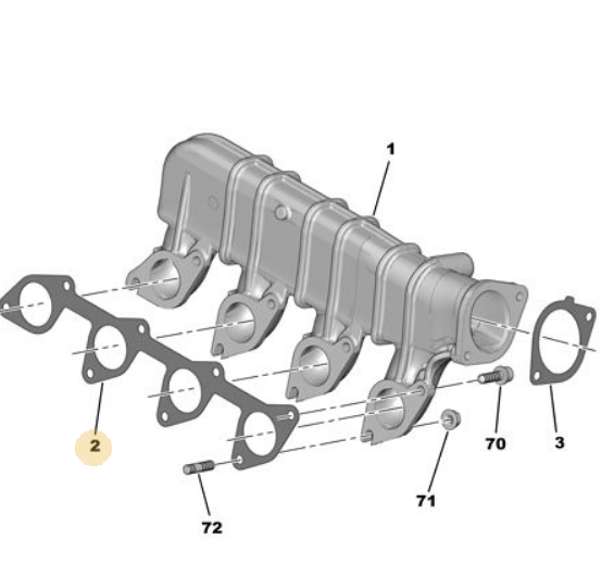

Another question before the weekend, is it a big job to remove the intake manifold on the RHY engine?
Anything to look out for during dismantling or reassembly (if I opt for doing that?) - I don't believe it has been removed since initial installation.

Re: Xsara II 2.0 HDI 90 Fuelling Issues
You'll need new seals (2) below: Part 0348N4 (Diam 40) and for (3), part 0348N6 (Diam 50, 6x62 EP 0.5)
The Air intake is no longer sold by PSA though for reference.

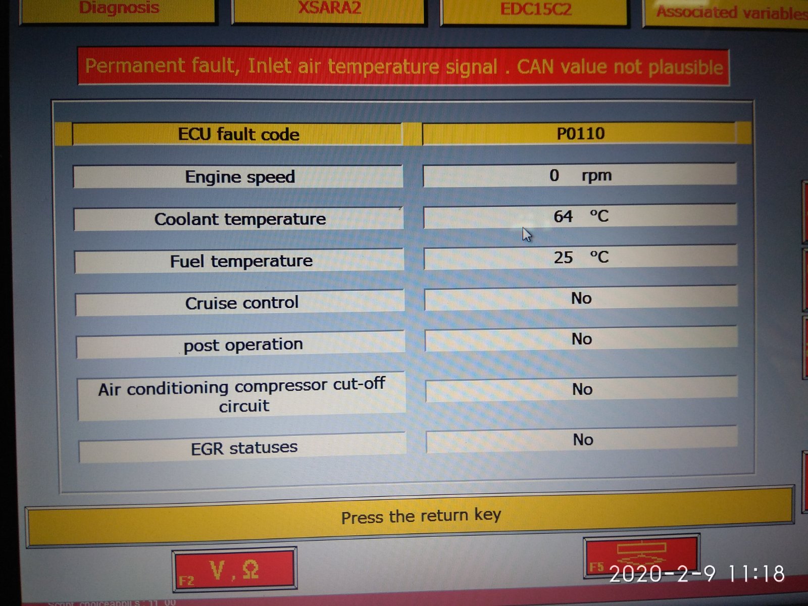

Egr has been removed and cleaned. Performance at idle is much better. MAF was recently changed (in last few months).
However P0110 remains and I don't know what to do about it. Any suggestions?
My understanding is that this may affect the fueling as it might be using default values instead of actual values.
It seems it is not happy with the data sent by the MAF. Did you fit a genuine one or an aftermarket one? The original MAF is part: 19208Q. They are not cheap, but the cheaper ones vary significantly in quality and longevity...

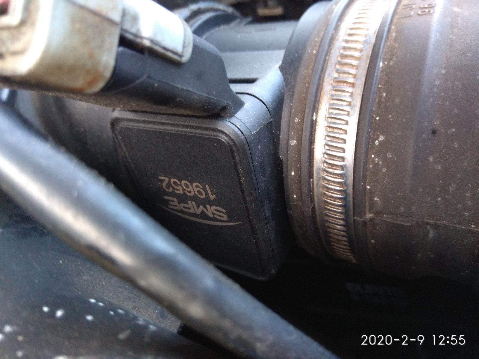

Non OEM (SMPE 19652).
It was what can up on motor factors site for the reg.
I'll take it off later and see if I can get the full part number.
