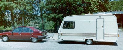

Our '89 19RD was 'non-sporting', and a lot more relaxing to drive than the other one in the family, our son's BX19GTi. Lovely though the latter was - metallic green with green velour upholstery, black dash and green-tint windows - the ride quality was never so nice: much firmer, and less roll. (Knowing what I do today, that could have been tweaked, along with all the appalling earthing points!)
Non-turbo, she would fly along, and corner as if on railway lines, returning 44mpg on average. Took us all over Europe and the UK, with a good deal of towing. Photo above was following the Duero valley, near the Spain-Portugal border, in 1996. Two-and-a-half years later, we bought the 2.5 XM.
I think a non-sporty S2 BX is an under-rated thing, especially the diesel, with a ride-quality and cabin quite outstanding in terms of airiness, space and comfort. And to think (at the time) they were regarded as "complex"!
