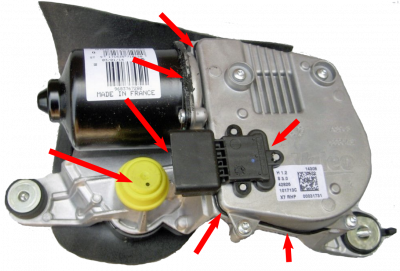

I don't think it would be the windscreen. The crack would have to be significant enough to allow water in and then it would also have to get into the wiper motor / ECU too - which it already has to be waterproof as it is exposed to far more rain.
This is a passenger side motor (new) and the arm goes into the socket covered by the yellow cap. I've marked some areas that look to be vulnerable - but I think in the summer I will be re-visiting both mine to coat them in marine grease as I don't fancy another failure!

Thanks Marc
Had planned to look at it tomorrow, but some family issues have cropped up that require my immediate attention, so not looking likely now.
When I have it in my hand, I'll be better placed to have an opinion, but I think you've pretty much nailed it, based on your pic.
The most vulnerable place SHOULD be the spindle, which has to change direction all the time and never does a complete revolution. That's very hard on seals of any description. Much easier to seal a shaft that turns one way only!
It's not easy to tell, from the picture, but it would be sensible, given this engineering difficulty, to have a drain hole below the spindle and to mount the electrics as far as possible ABOVE the spindle seal, so gravity would be your ally.
I suspect neither is the case here.
More on this, maybe, after I've had a chance to look at one in the flesh.
Personally, I'm rather hoping whoever changed it earlier this year didn't plug the black connector in, very well.
Time will tell, I guess
