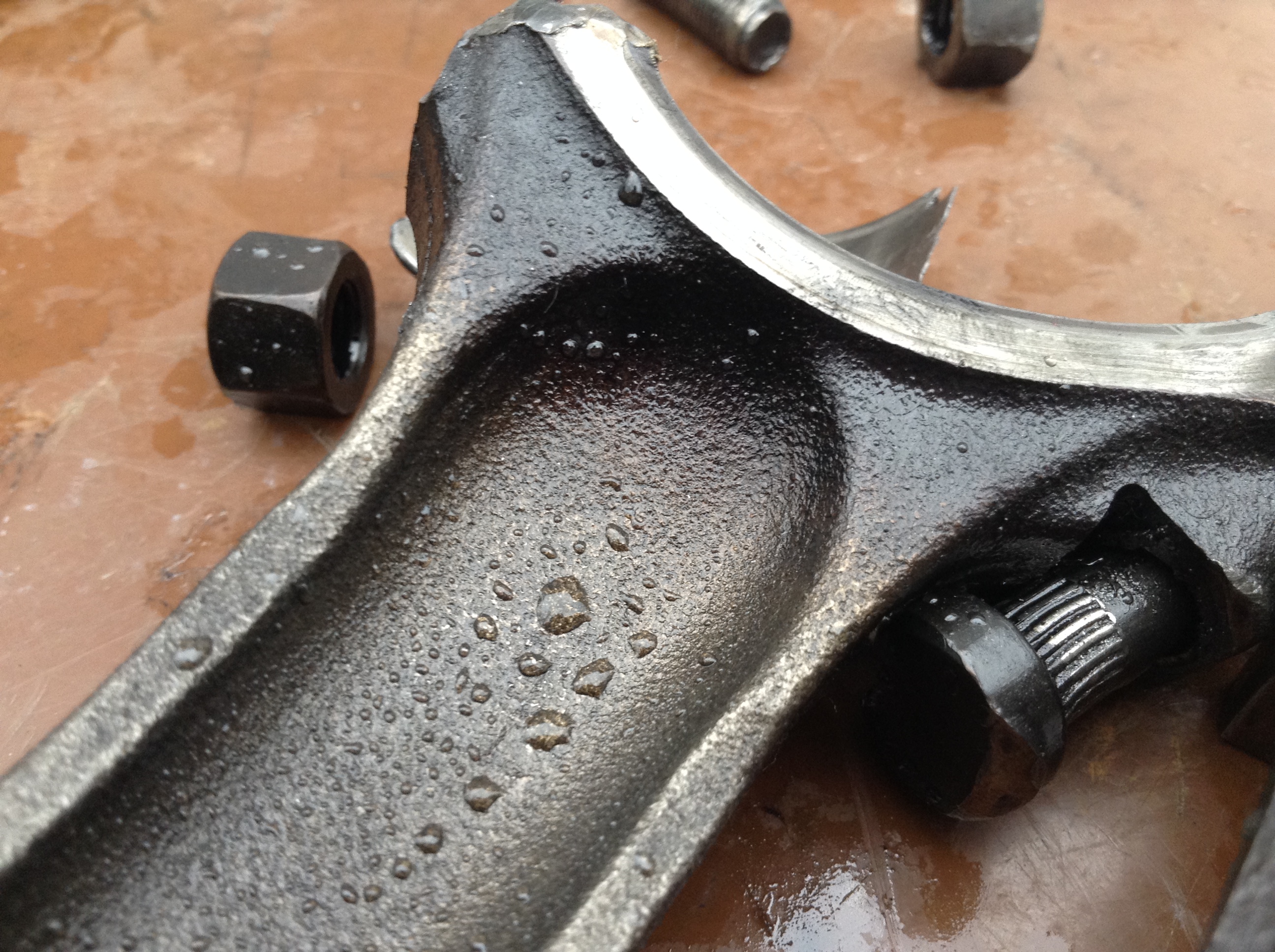

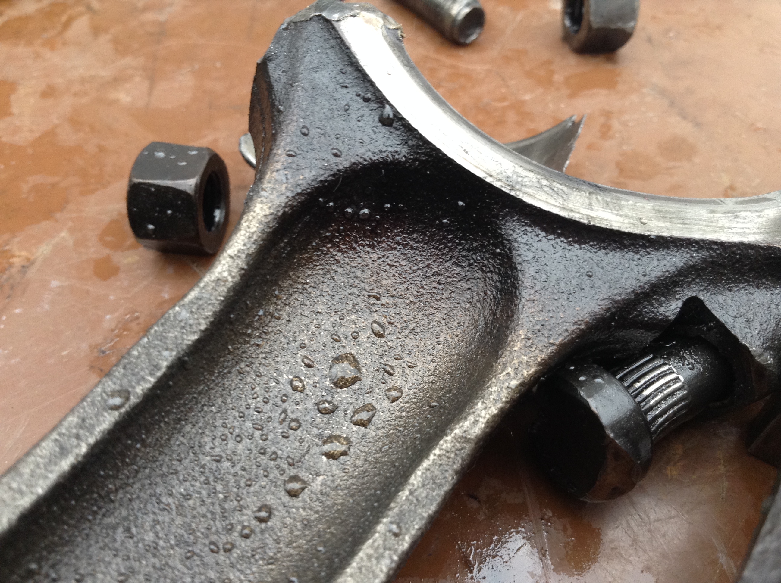

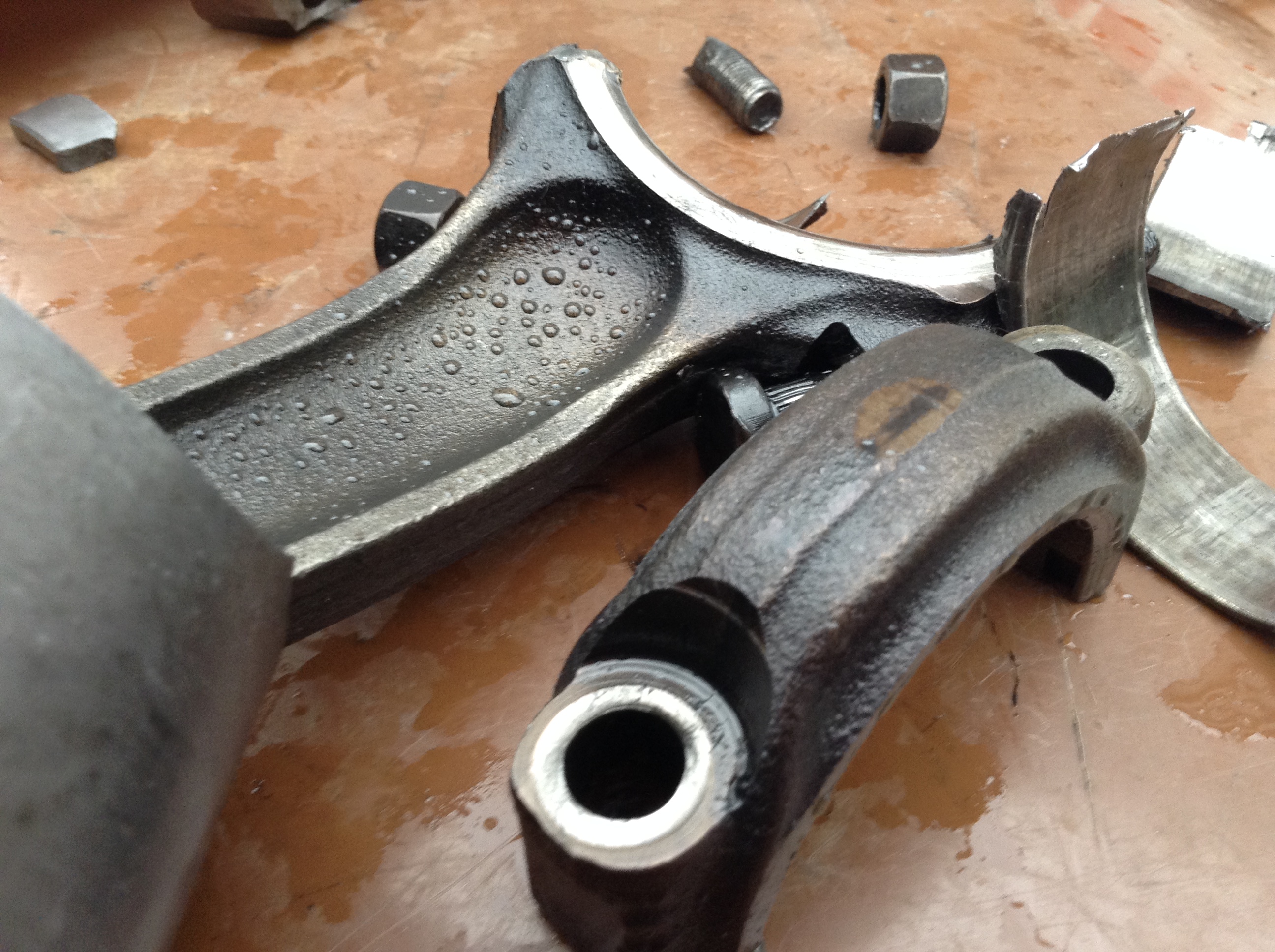

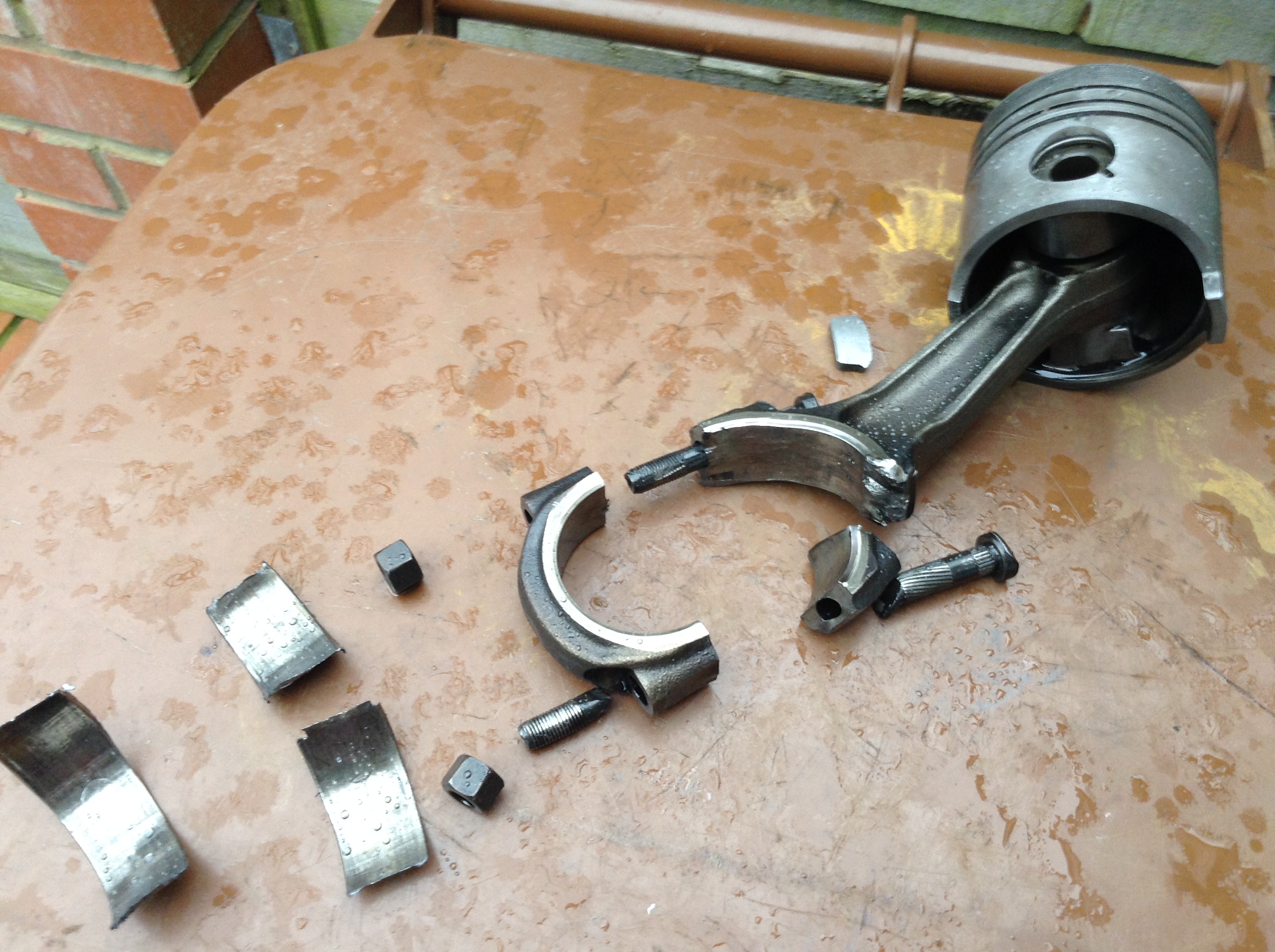

Finished removing the sump just minutes ago, it's a mess in there... Crank journal is damaged so time for a replacement is the verdict barring miracles.
Not sure how it could've died quietly though given the fact the big end cap has come loose before escaping from the rod (one stud is sheared, one intact, BOTH nuts undone and sat in the sump). The only way I know for a correctly torqued bearing cap to unscrew itself is if the big end had been knocking like a rattle gun for some time prior to death.
Any other suggestions how it could have managed to loosen the nuts I'd love to hear them, as I'm honestly stumped how it could have happened otherwise. I'll post photos up when I get a moment, domestic duties call for now (only the washing up sadly, nothing more exciting lol!)

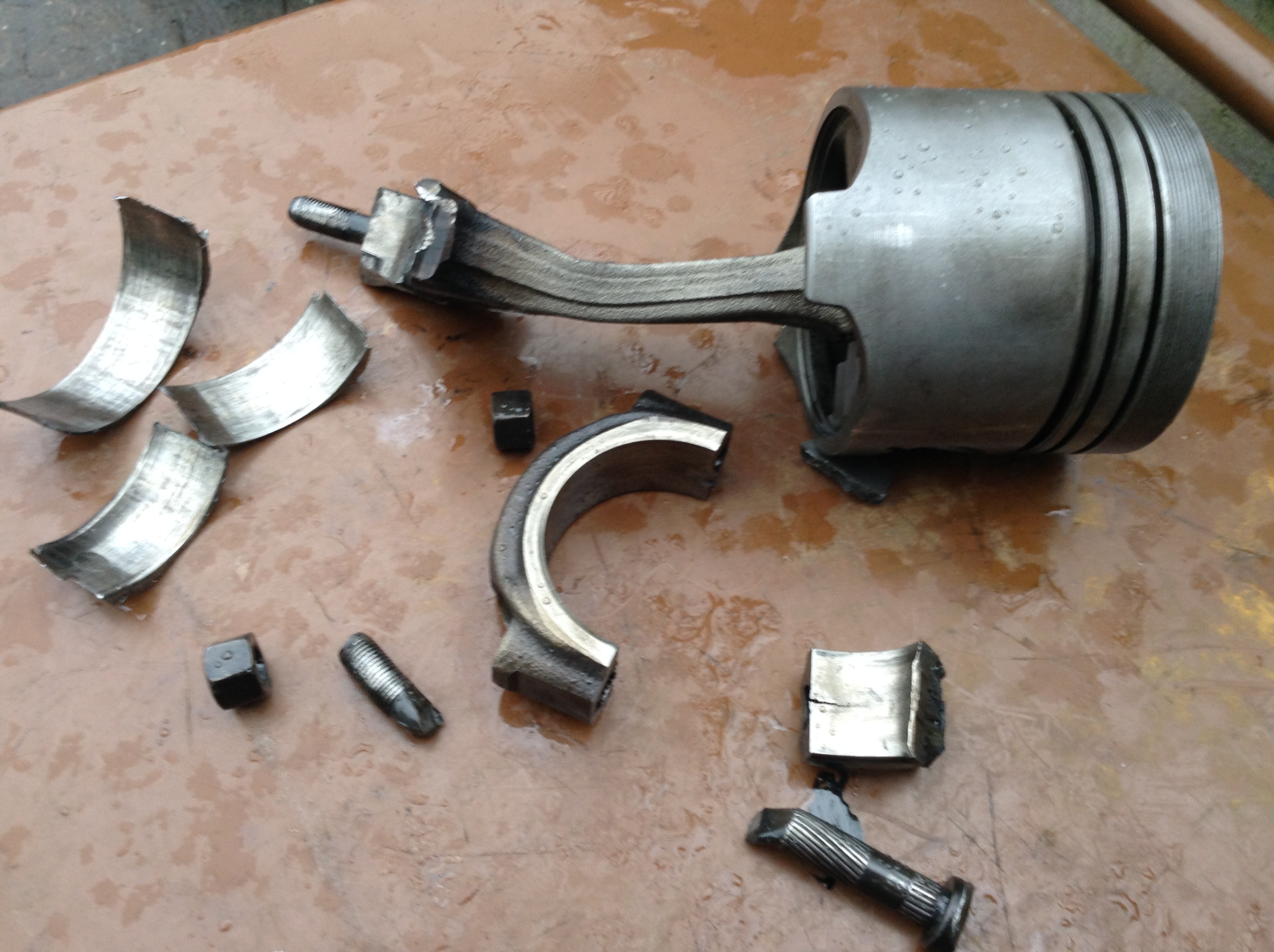

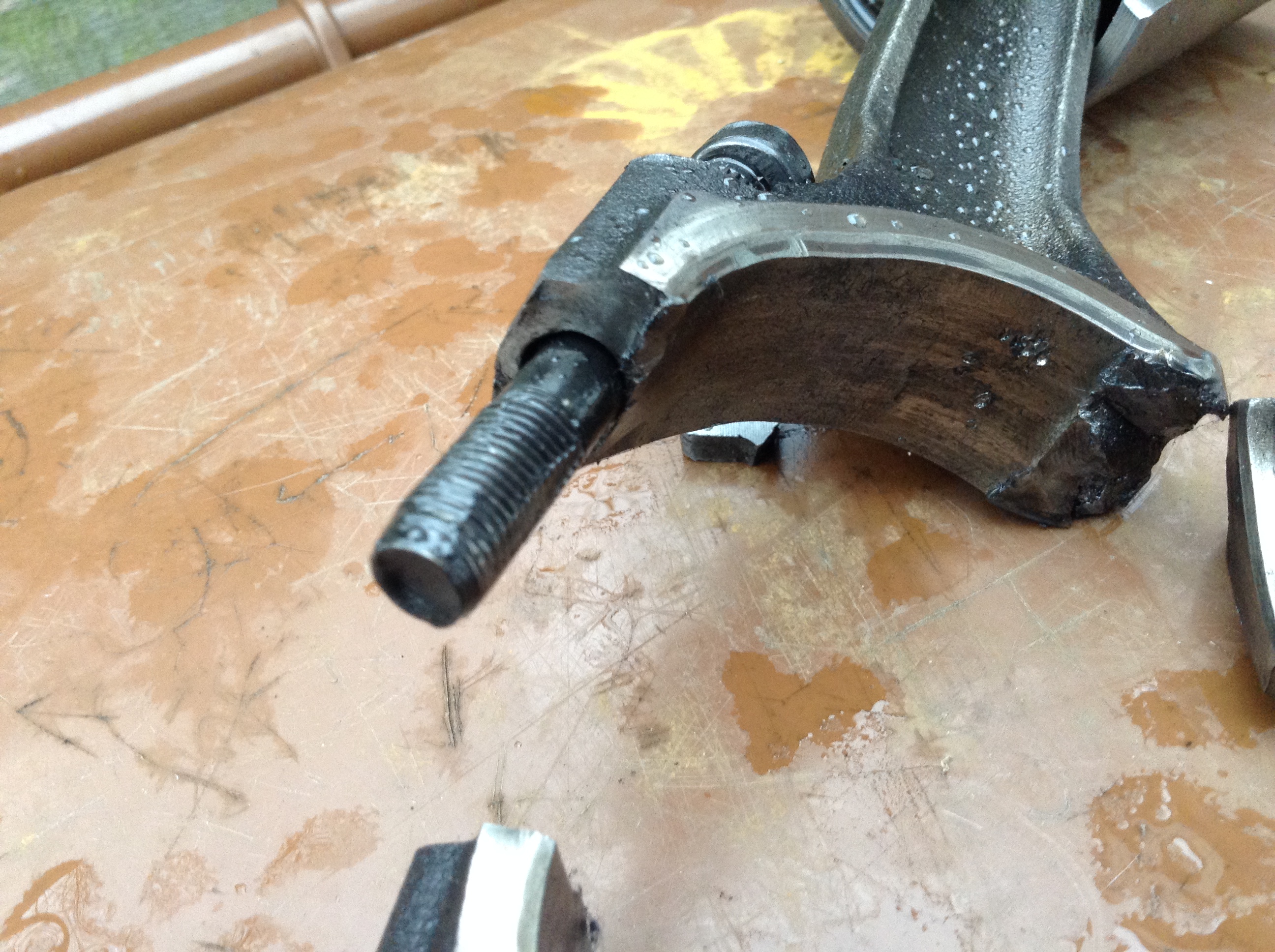

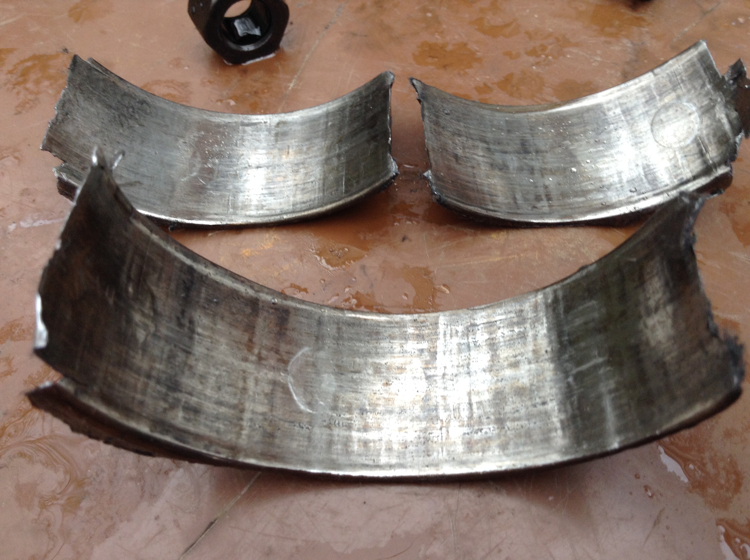

Re: Black Xantia NA Diesel auto... Sump off, crank damaged, time for a new engine...
Unread post by ekjdm14 »

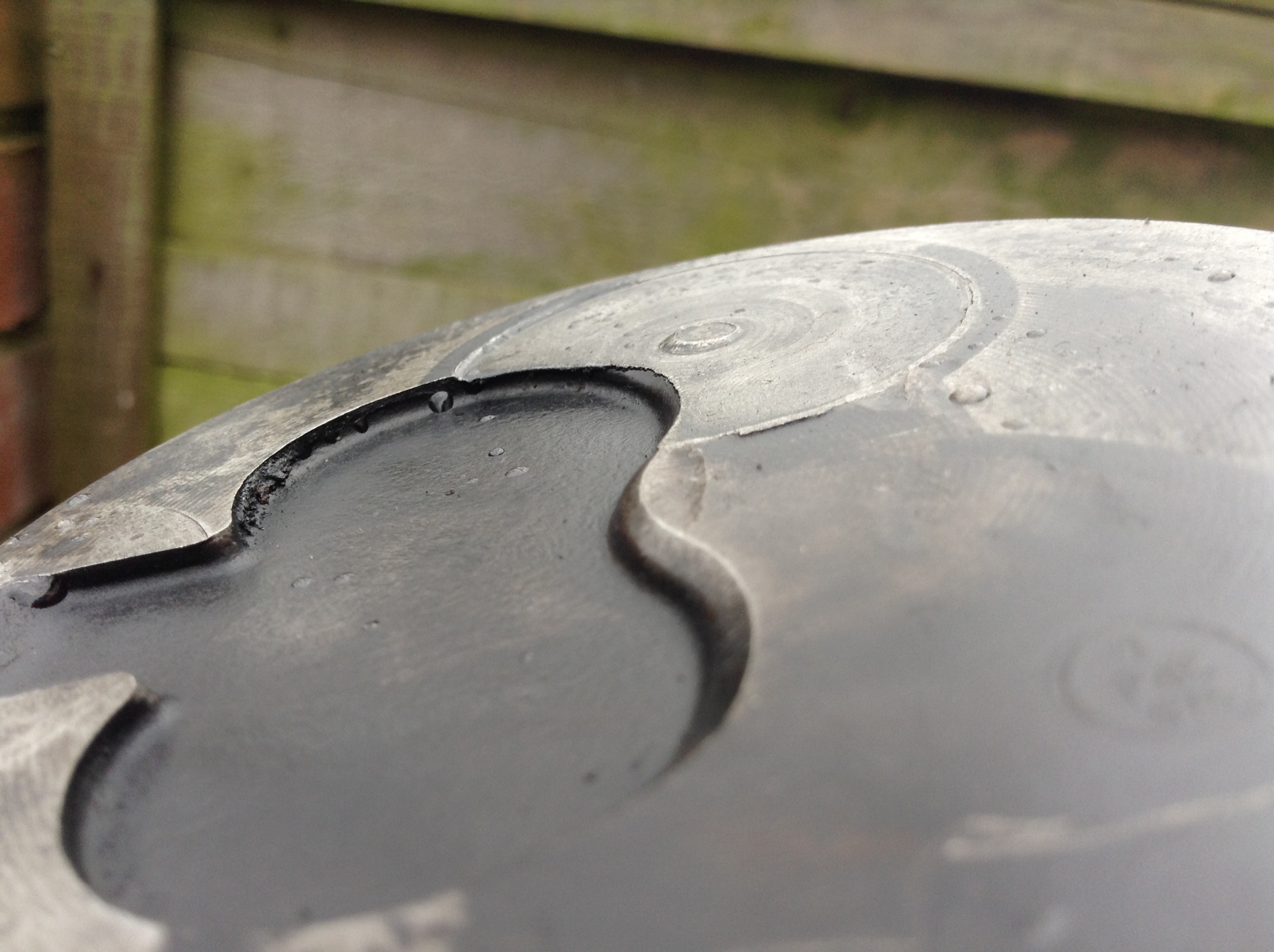

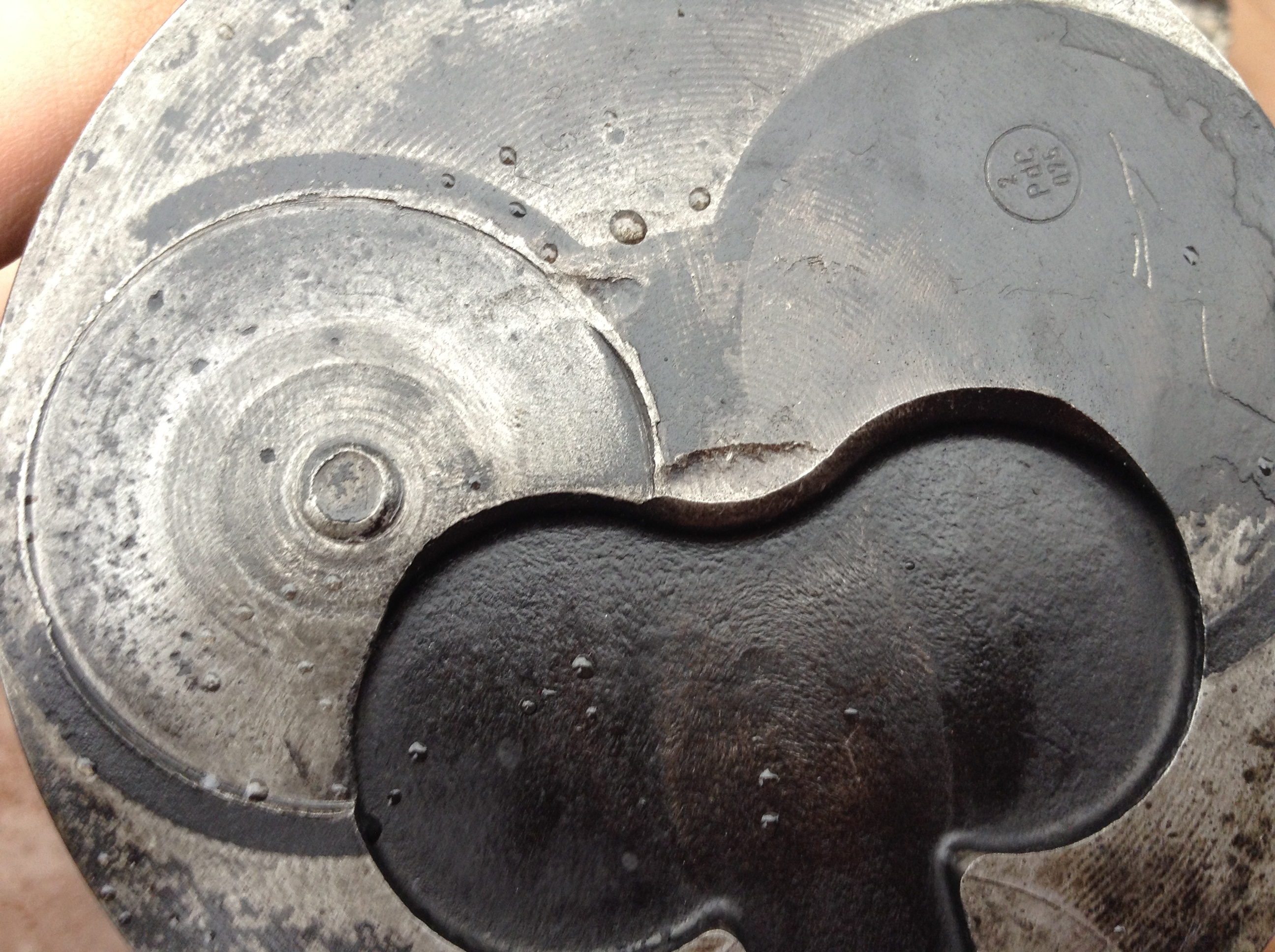

Time for some sickening pictures... In the two close up shots of the big end, I think it looks like it's got rather warm. I suppose there's a possibility that the scored cam bearings caused low oil pressure and #1 big end was the first to suffer, the other 3 feel OK but I might pop the caps off for a look at the shells at some point. One thing is beyond doubt though. Le moteur est mort. Very, very mort!

Re: Black Xantia NA Diesel auto... Sump off, photos, carnage.
Unread post by RichardW »
That's impressively buggered!!
Unread post by yannbeam »
Most of the conrod failures I've experienced with the race engines are due to the bolts stretching. But thats usually at silly RPM. I dought a 1.9D would rev that high ? Looking at those pics I would have thought that would have gone with a bang!
Unread post by Stewart(oily) »
Impressive carnage! The TD I replaced would not allow the piston to come out of the bore, and the rod had punched through the block back and front, a mystery to be sure.
yannbeam wrote:Most of the conrod failures I've experienced with the race engines are due to the bolts stretching. But thats usually at silly RPM. I dought a 1.9D would rev that high ? Looking at those pics I would have thought that would have gone with a bang!
I did wonder if it had managed to over rev somehow, as that would tend to explain the imprints of the inlet valves on the pistons too if it bounced the valves (or even stretched the rods/bolts). Being an auto though a fluffed shift at speed seems unlikely, and the general condition of the rest of the engine would tend to rule out a runaway. I guess that leaves the pump potentially being tweaked with and allowing it to eat itself at MoT time, but I would imagine that to be less likely on a non-turbo...
Something strange going on for sure, maybe we shall never get to the bottom of the actual cause of failure. Suffice to say, the engine is pretty well scrap. The rest of the car however does warrant a replacement as it's in really nice shape, strut tops are great (plenty good enough to clean up and rustproof certainly) bodywork is pretty much straight with just a couple of small rust spots on the bonnet and the left jamb is bubbly and paintwork is decent enough too. Inside there's the stuck but leak free sunroof, column cases are a little loose as are the stalks and drivers height adjustment is loose. Otherwise though, I can't fault it at all and know it'll come up nicely.
Gosh, as Richards says! It is indeed impressively buggered :lol:
Wonder if it suffered a runaway at some point in its life and this is a delayed failure? Nuts would come loose after the big end broke as there's nothing then to keep them tight...
My take may be that it was either a spun shell causing oil starvation to that big end or a blockage in the oil drilling to that big end - it could even have been a bit of swarf from when the crank was manufactured...
One thing for sure, it as not the rod that gave way.
