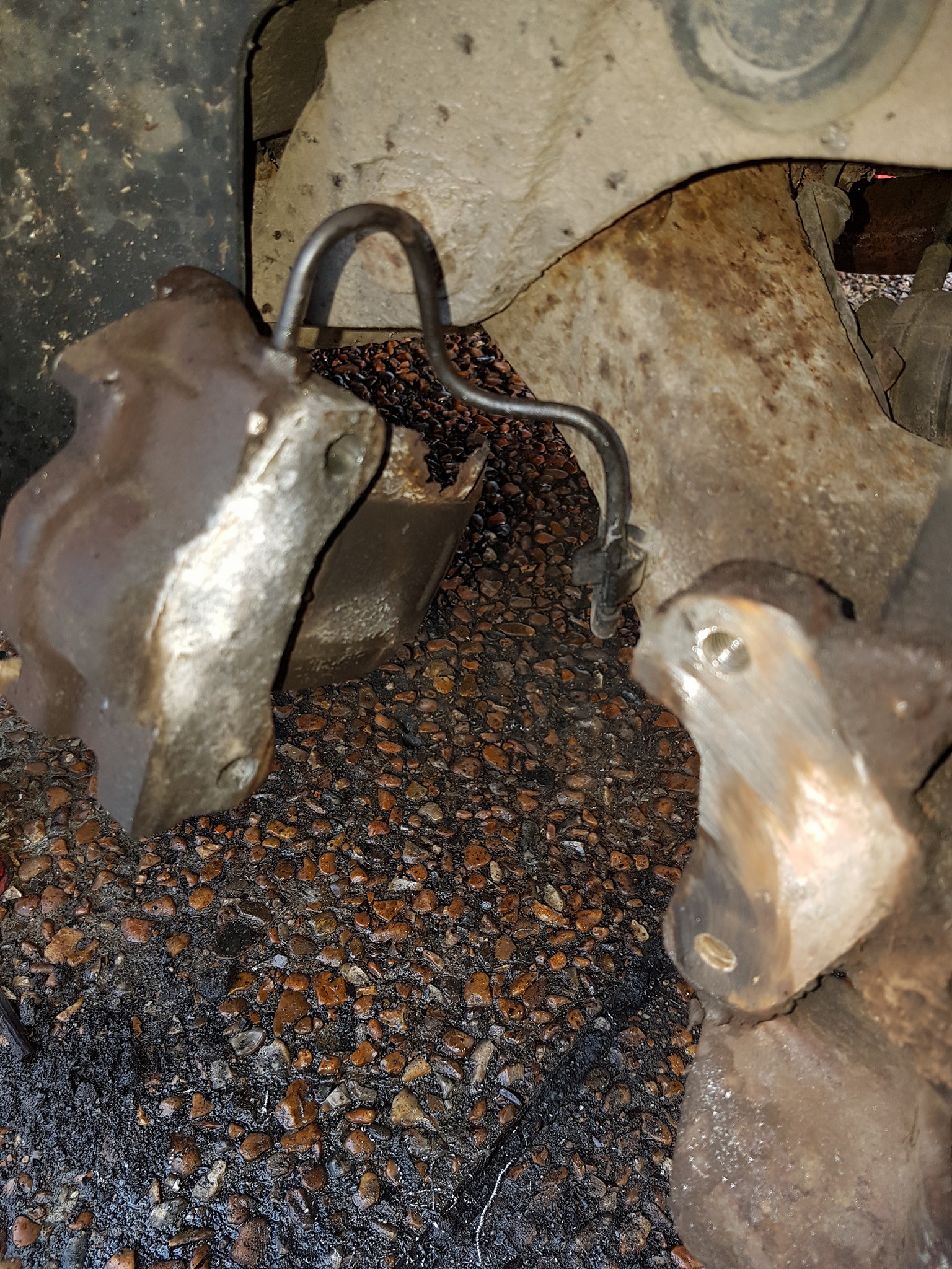

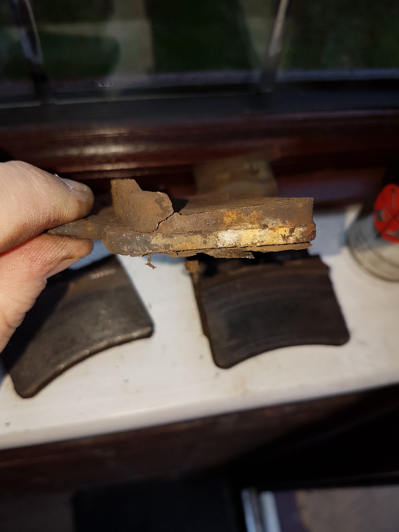

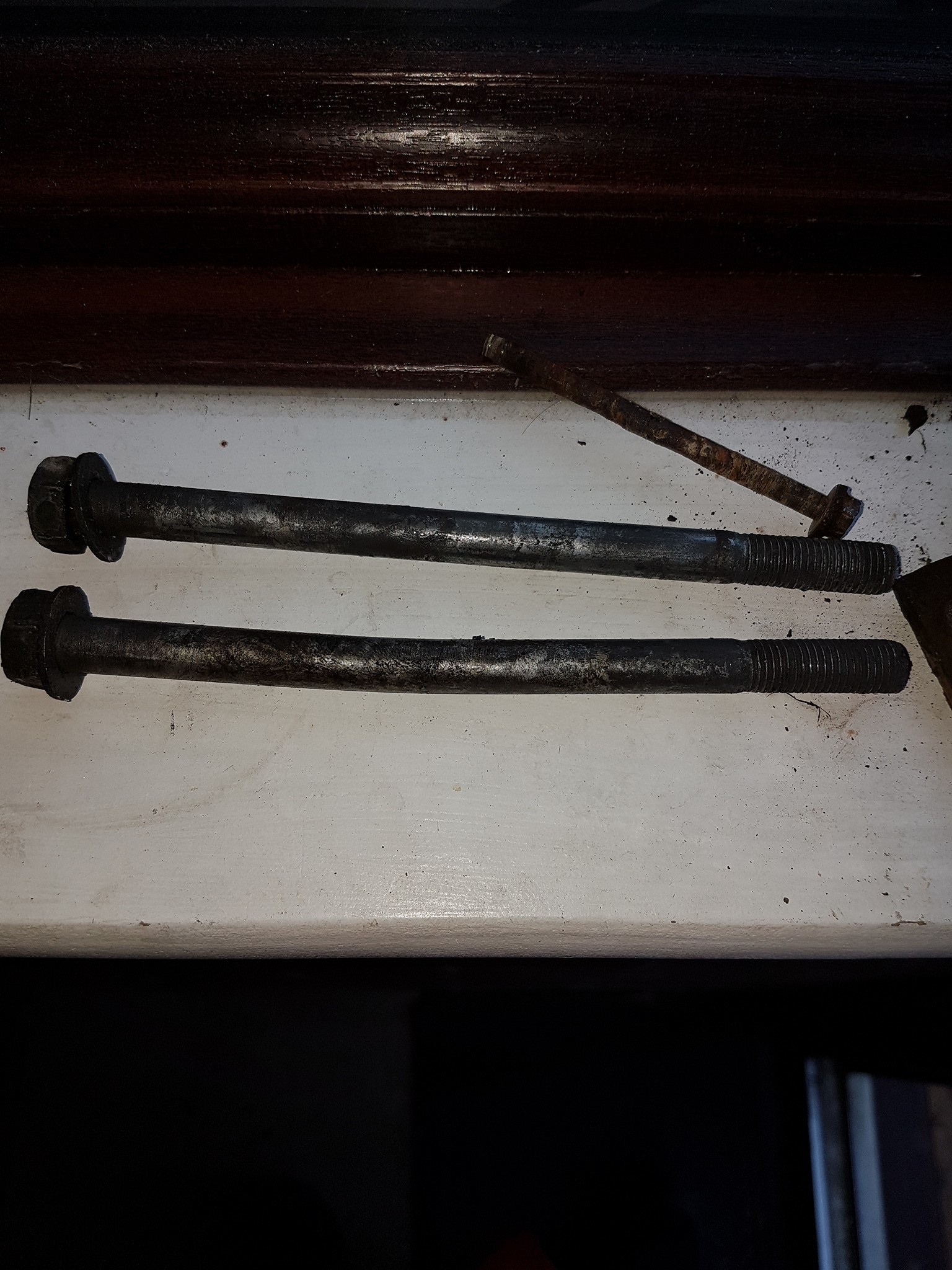

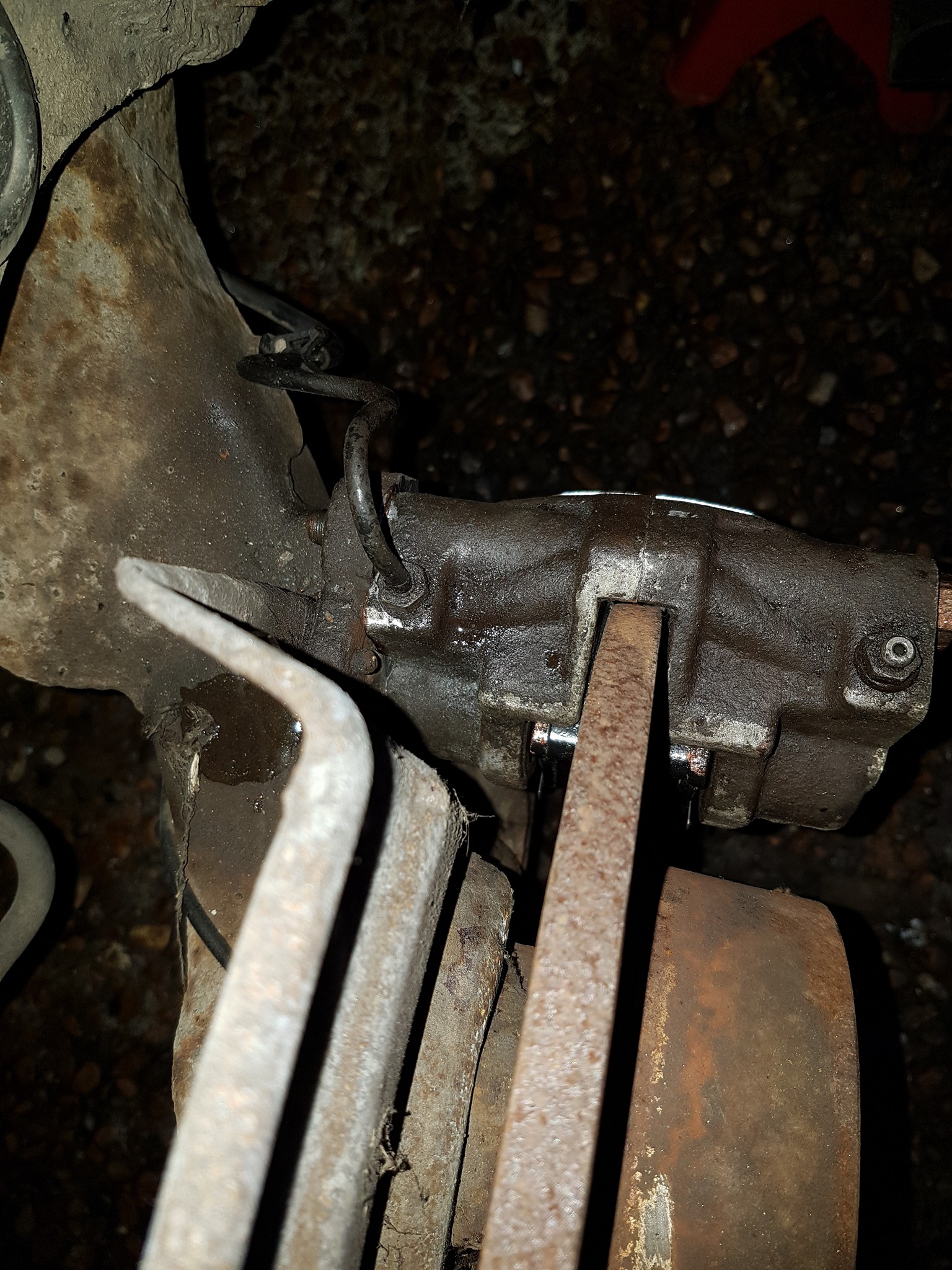

as promised - enjoy my rear brakes!
lip on edge of calliper

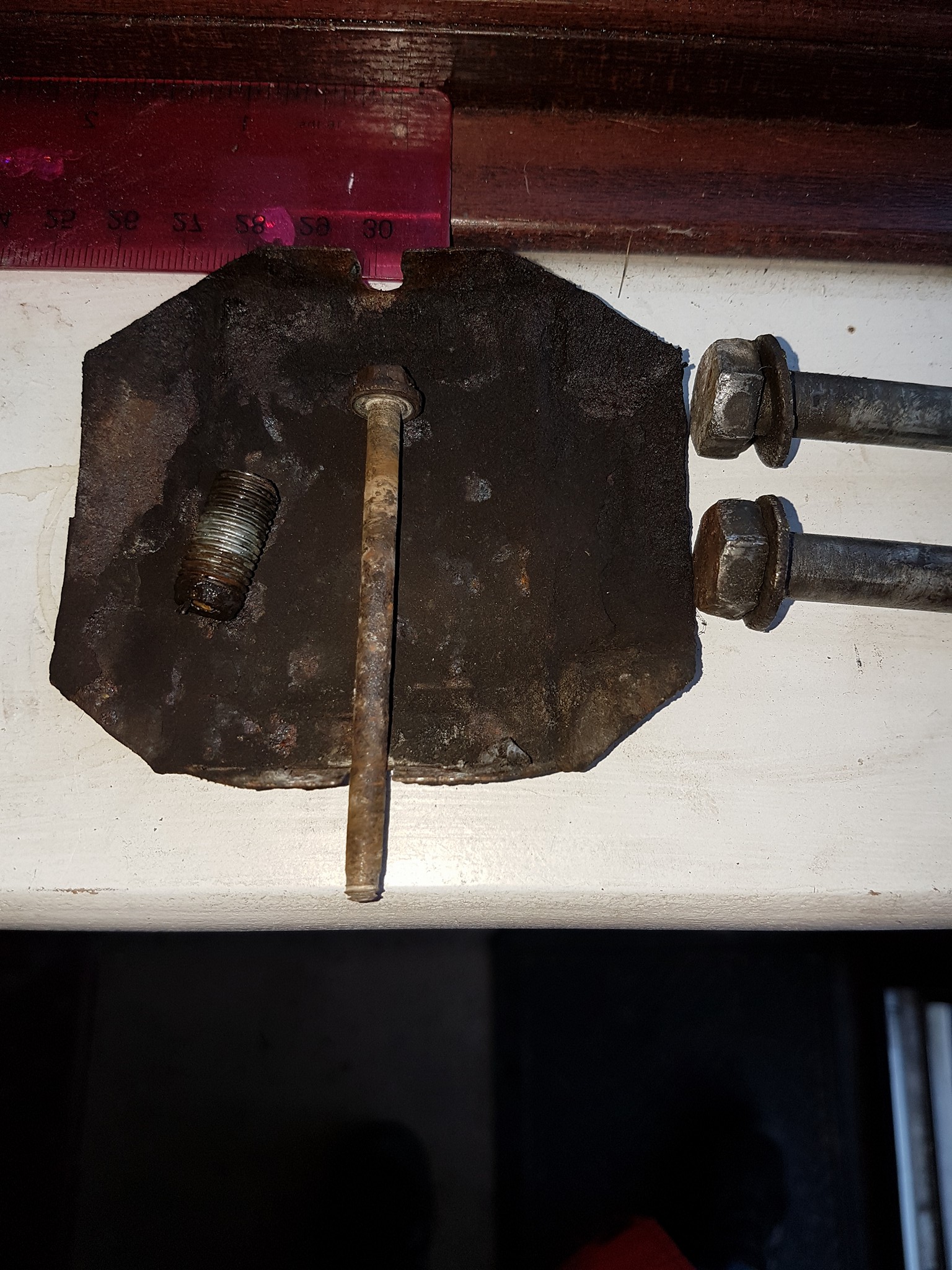

snapped bolt and cover

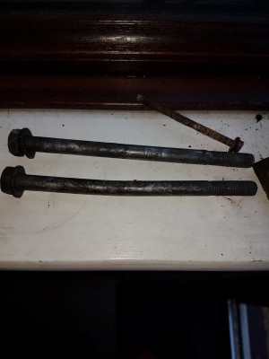

bent bolt
bent bolt
corroded calliper
corroded calliper

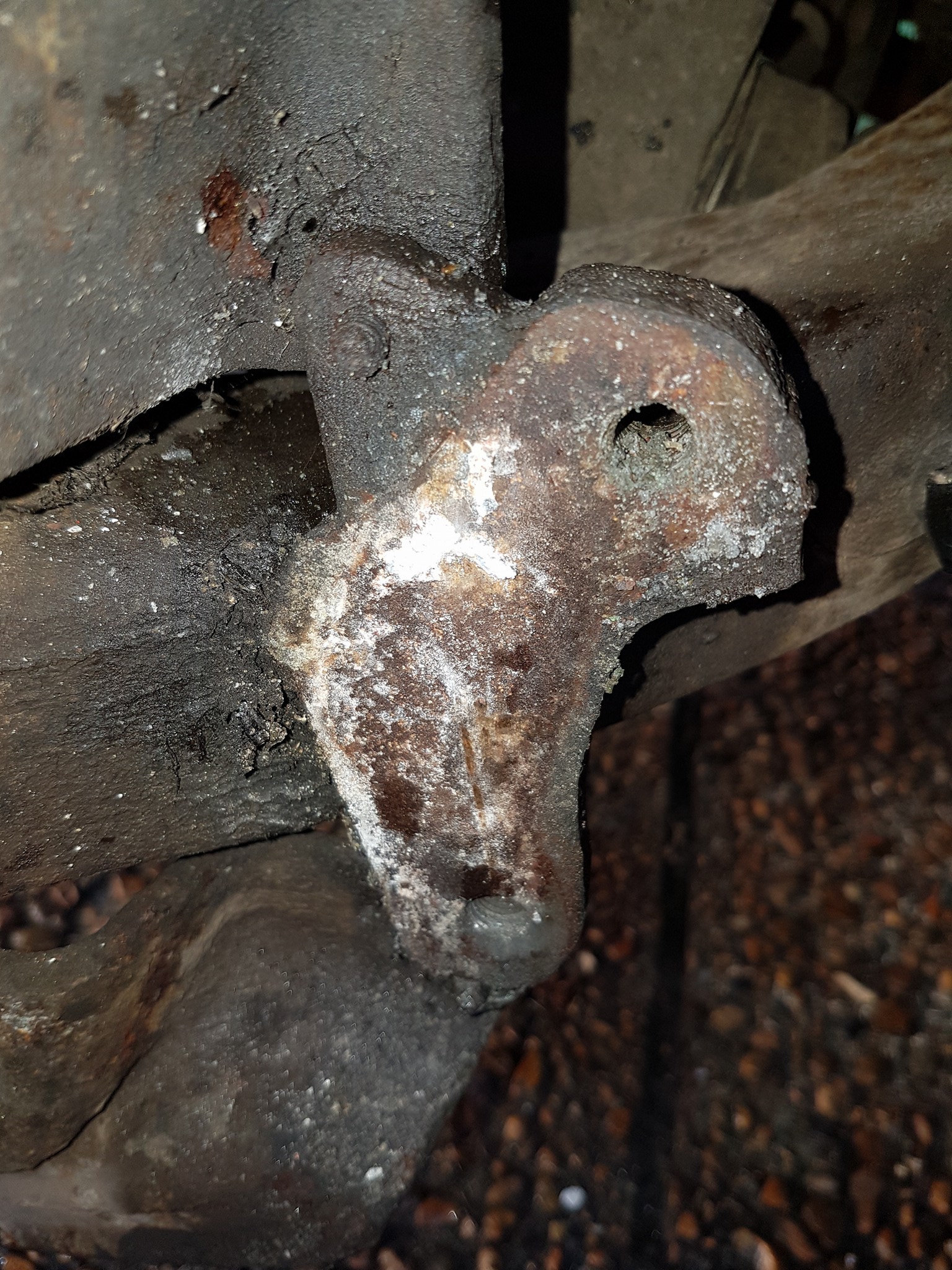

corroded mount
corroded mount

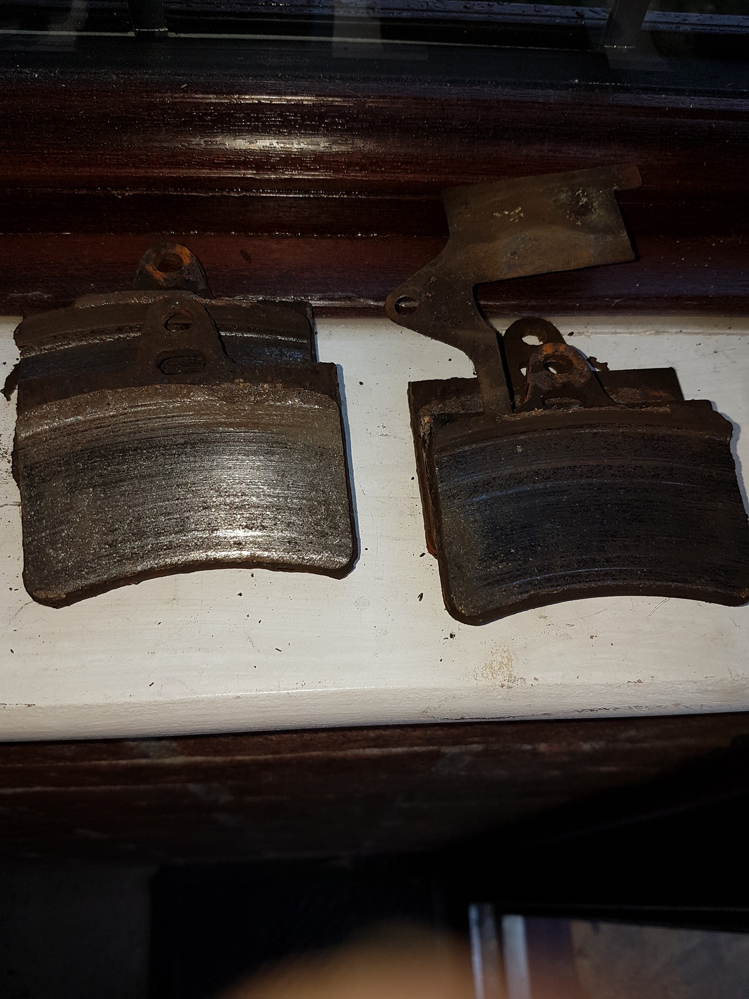

have these ever been changed?
quality pads
quality pads

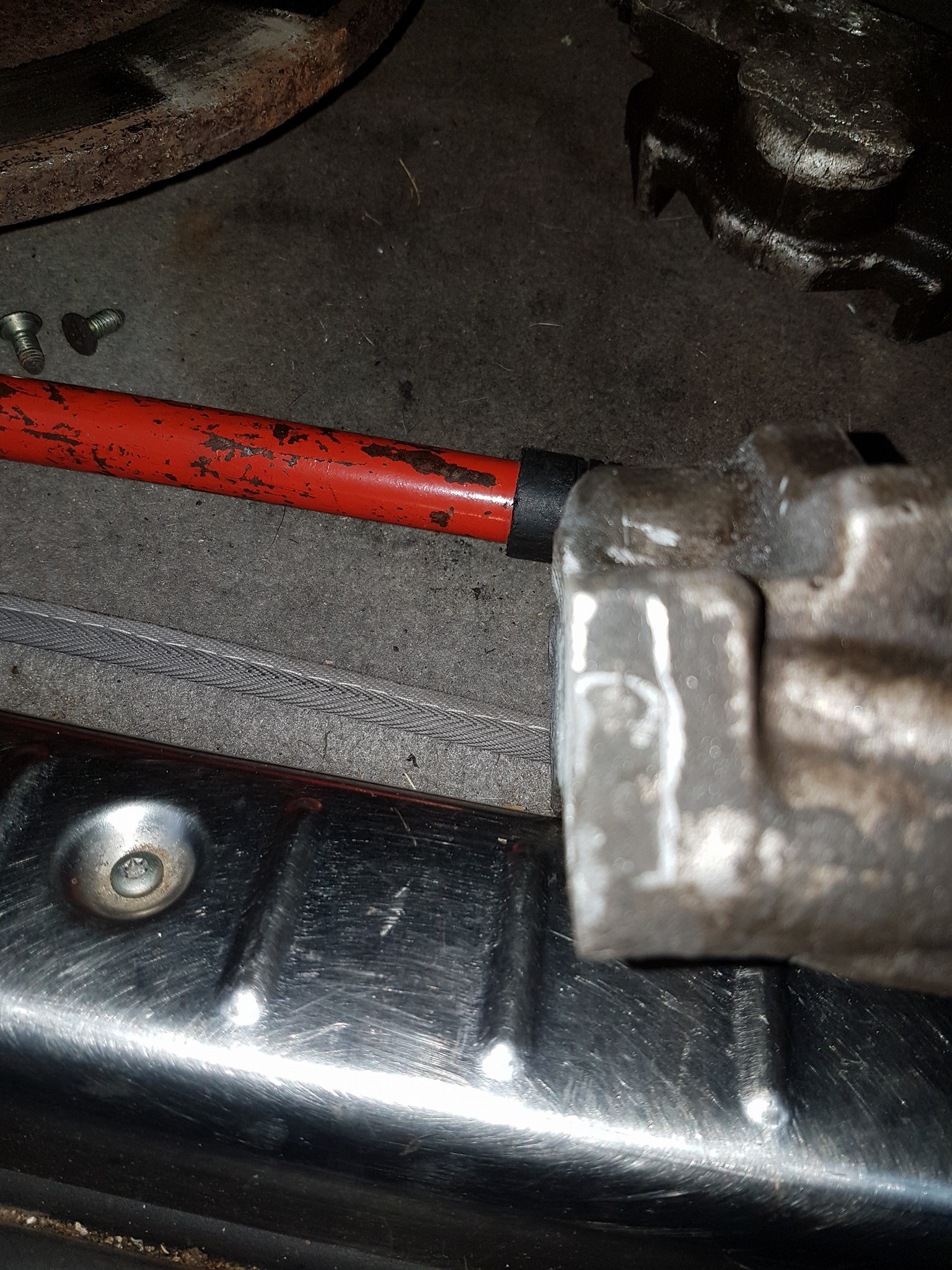

all sorted for £14 (bolts) and a set of pads (and a case of beer for a friend!
