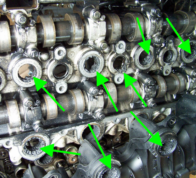

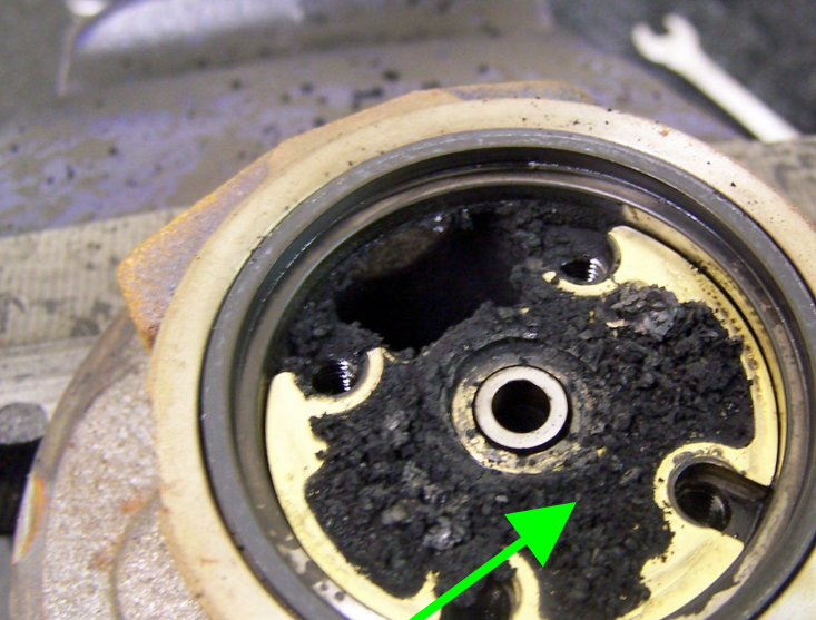

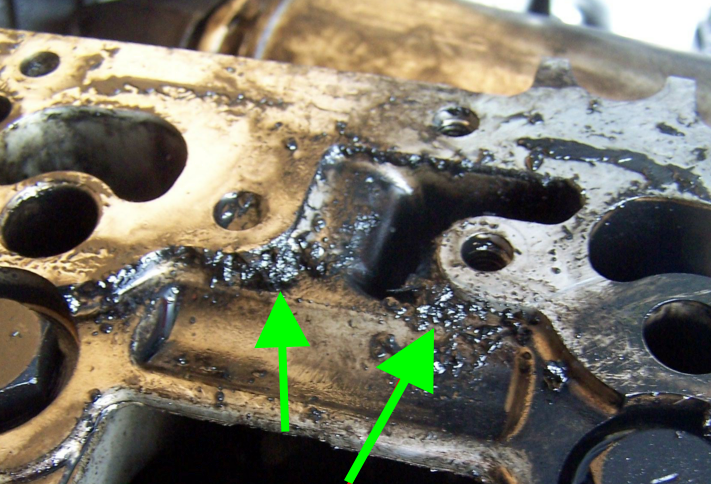

But as it has been mentioned and the OP has also posted on the injector torque settings on another thread, it is worth talking about the 'bits'.
So how do the bits end up there in the first place -
The issue is carbon build up and the main cause of this is carbon forming around the injectors. The copper washers can then fail and once this happens the sleeve oil seals are ruined by the carbon build up. Once carbon gets into the engine oil - it starts forming a thick sludge and gets stuck to and blocks the oil channels and other parts, so it's a sure thing that the turbo is next. If the turbo still has the filter in the banjo bolt, then this will hasten oil starvation and adios turbo. If it has been removed, the oil will get through, but will just prolong the failure as the bearings get damaged over time.
Click the images to zoom
Engine / Injector Ports:
Heat will quickly turn this sludge to carbon.
These are large carbon particles found in the sumpSolid carbon deposits in the Turbo Core and Thrust Bearing

I think it is quite relevant to be honest. When you think that even the smallest particles that you can see in the middle picture are enough to knacker the turbo and score the cylinders it's all useful info - making sure the injectors are tightened to the correct torques and regular oil changes.
Of course, the earlier on the enhanced maintenance is undertaken in the vehicle's life, the less chance of the damage occurring in the first place. :)
