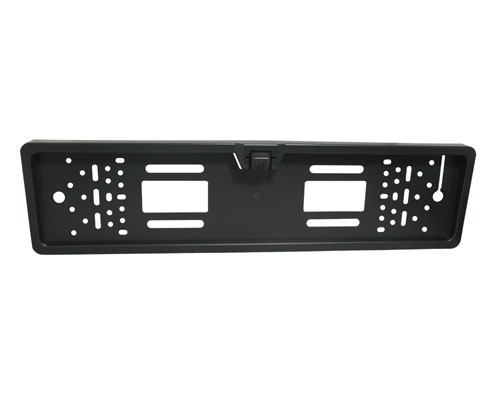

OT regarding license plates, as perfectly show like this side by side on the photos ... in the UK you can have the plates drilled and bolted directly to the bumper, without the outer plate shell?

without the outer plate shell ??....what is that ?

All car's imported from Germany seem to have these. In Finland you can just bolt on directly. Don't know if this is compulsory in some countries.

Many are stuck on with adhesive pads so that if they are pulled off they are damaged, this prevents theft of the plates. It seems like a common practice to use these types of pads and has the advantage that a hole is not drilled preventing de-lamination

We can't do bolting here ... I mean, you can, but the police can pull you over and write you a fine for that ...
