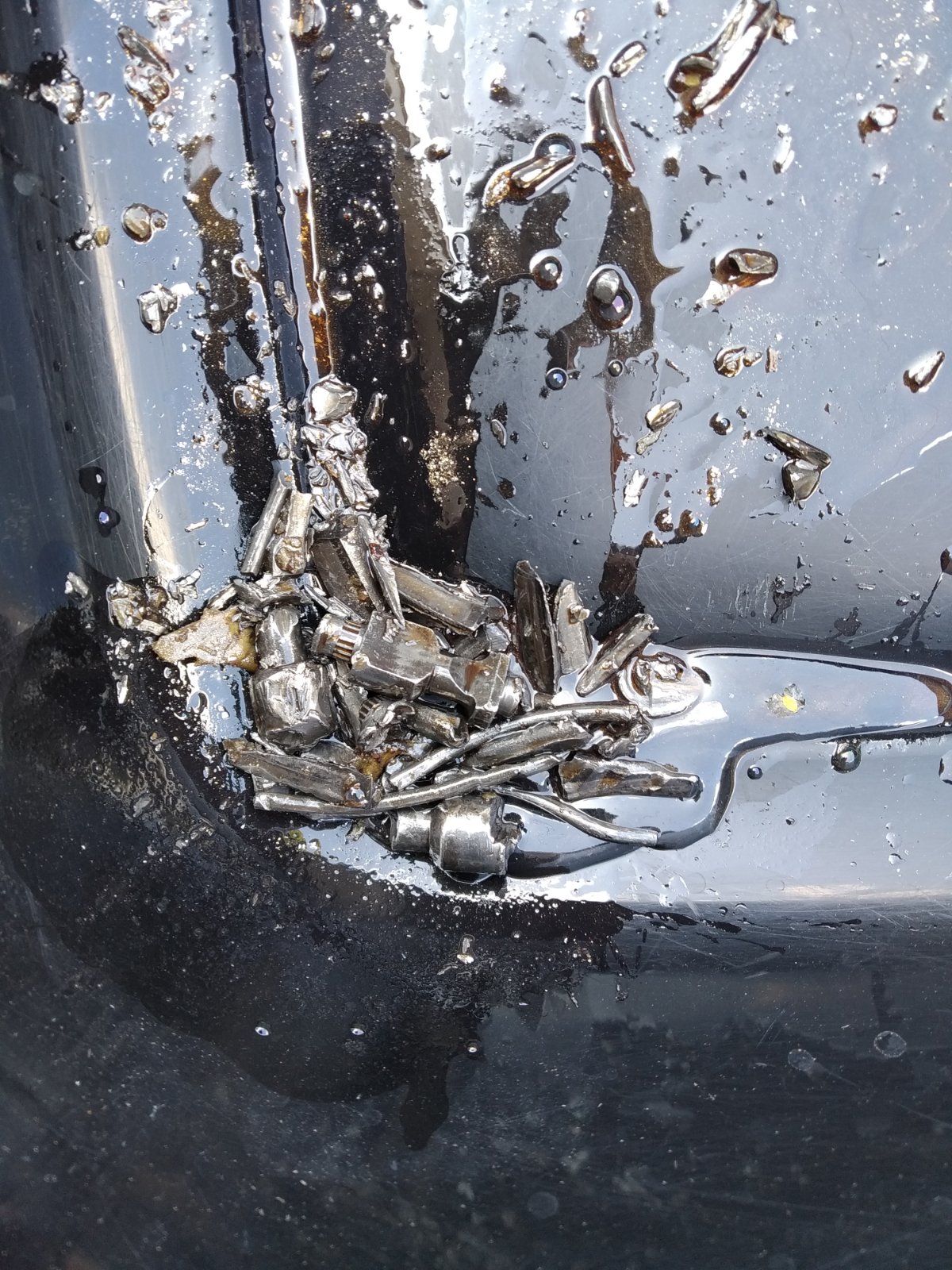

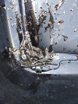

Hi gentlemen wondering if you can help me? I too have the same fifth gear problem I have followed instructions removed the end plate the lock looks intact. However all this stuff came out of the oil pan any ideas what it is please?

No idea what that was, but it almost certainly signals the gear box has had it! What car / engine are we talking about? Shouldn't be too hard to find a used box and fit it.

Looks like bits of the selectors. I'm afraid I have to concur with Richard.

Yes, the 'box is a basket case. Horrific damage.
As said, best to locate a good used one, maybe from a local firm that reconditions manual 'boxes, so that you'll have a warranty.

Seems that the box has all the right bits just not where they should be

Not necessarily in the right place.

Thank you, my car is a 2003 Citroen xsara picasso 2.0 Hdi, I don't drive much and rarely go into 5th gear so will just put it all back together minus all this metal. Probably be cheaper to replace the car than to replace the gearbox? Unless someone has any suggestions???

Given that 5th is outside the main box, and there is only a small oil transfer hole, it seems very unlikely those are bits of the 5th gear cluster - looks more like parts of the final drive to me. I'm very surprised the box is not howling like a banshee or otherwise complaining loudly, or failing to proceed at all! If the car is other wise in good condition then fitting a used box should only be £300 - £400 - plus a clutch if you think one is needed. Any car at this value is likely to be a total shed, so unless the car is knackered, I would consider sourcing a used box and getting it fitted.

Thanks guys, no sound whatsoever apart from a crunching sound if you try to go into 5th gear. The car is not worth much so not worth the hassle I drive only couple times a week. I will just buy a another car the sold girl has done 183,000 and has been used more by my family than me.
