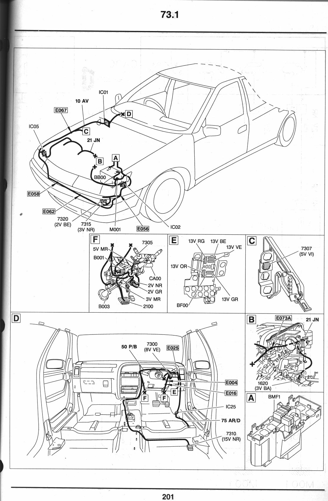

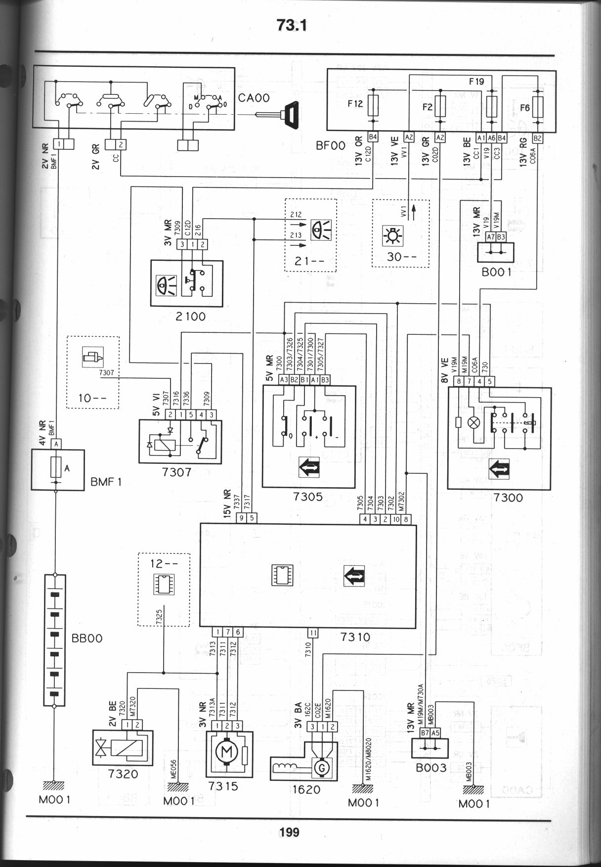

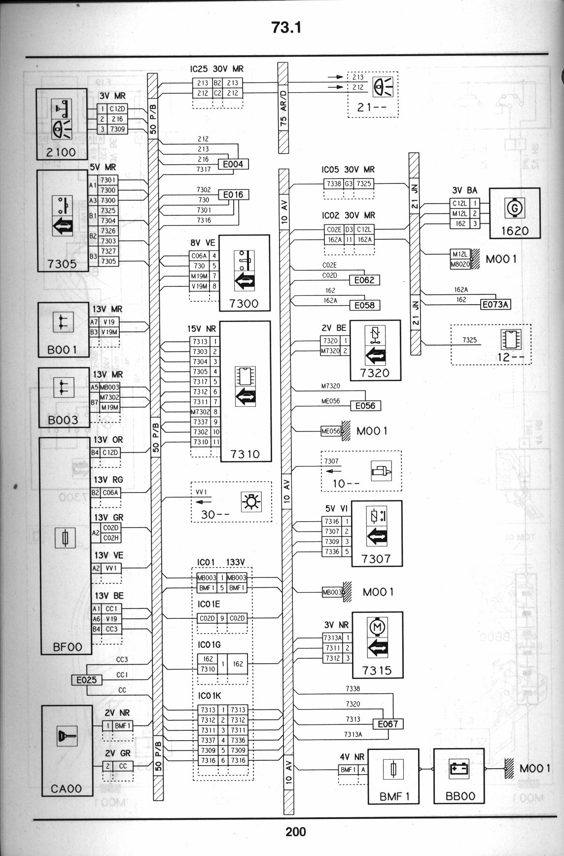

Wiring diagrams will be along in a bit
I will make some more comments later. I have baking and cooking to do now..

Simon, without further ado, here's the S1 cruise diagrams:
Circuit
Harnesses
Locations
