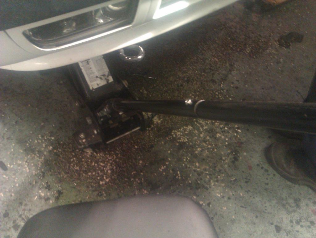

Fifteen hours.
This job is absolutely hateful, but it is also the worst job you can do on a Xantia. The second worst is welding and I've managed that one so it can only get easier from here, right?
We did, with the help of our engine brace thingy, get everything aligned. It was still an arse of a job so it was timely when my brother turned up and said "you just do this jiggle" which made the gearbox align with the engine and make it pretty smooth sailing. The clutch fork can be a nuisance but it went on first time and the actual changing of the clutch took about ten minutes.
It was actually surprising how easy the actual clutch change was considering how long it had taken us to get to this point. Six and a half hours to get to replacing the clutch and reseating the gearbox felt like it had taken a bit longer than it ought, but not daunting enough to make us worry about buttoning the rest up.
A hunt around the engine with all the bits off discovered a few possible oil leaks. The sump gasket seems to have been weeping for quite a long time. There's another leak up the back of the engine, one on the rocker cover gasket and another across the top on one of the pipes, but these are less clear so the plan is to get the engine steam cleaned or similar just so we can see where the oil is actually emerging to effectively be able to cure/lessen it.
To refit the gearbox the stud had to come out of the mount bracket. We needed to get it a bit warm to make this happen.
With everything connected, checked, the gearbox refilled with about 2ltrs of fresh correct oil and another 2ltrs of LHM in the reservoir we were ready to fire things up. Car started without complaint, no horrible smells or noises, LHM level going down nicely and just as we were about to tip another litre into the reservoir we got a terrific green waterfall out the bottom of the front bumper. Cat litter to the rescue and engine quickly turned off.
The front accumulator had been an absolute nightmare to refit anyway, the various brackets and fixings put up a fight for above an hour which was just stupid. The smaller pipe wouldn't line up and the larger one was now fountaining LHM out of the union. We suspect there's a missing seal for the larger - power steering? - pipe which means it can't hold the LHM in once any sort of pressure happens.
Utterly disheartened by it. The MoT is due on Tuesday and I'm not at all confident the car will be sorted in time now. We're talking to Citromatic on Monday to see what exactly is wrong. Worse case scenario is that we need a new pipe and a new accumulator and since I know that's the only sphere that hasn't yet been replaced it wouldn't be the worst thing to have to fit a new one.
Still, at least my brother remembered to bring up the clear side repeaters he got for me, which really tidy up the wings a lot.
Xantia is now in the bad books, it's been hogging space at the unit for 6 days now, which is four days too many.
