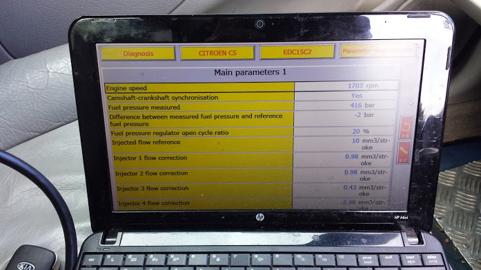

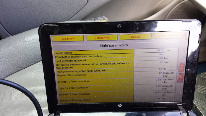

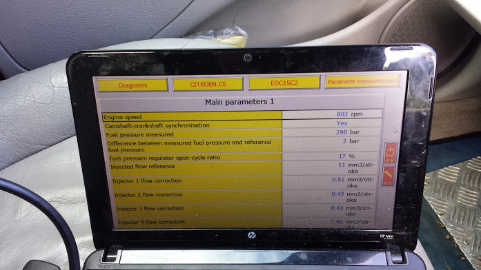

got car running instantly with a small spray of easy start.., ran nicely.,. see below., injector 4 was always -ve .. is that of interest.? injector 1 showed some odd numbers too..
jgra1
- (Donor 2021)
- Posts: 4625
- Joined: 27 Nov 2005, 19:07
- x 36
Re: HDi 2.0 8V wont start when cold
nothing interesting so far from the Lexia I am guessing chaps? (just wondered what the negative flow correction was on Injector 4? )

well that injector looks WAY out comparred to the others...perhaps its starvin the other clyninders of enough pressure to combust properly and espeacially cold the fueling needs to be spot on
