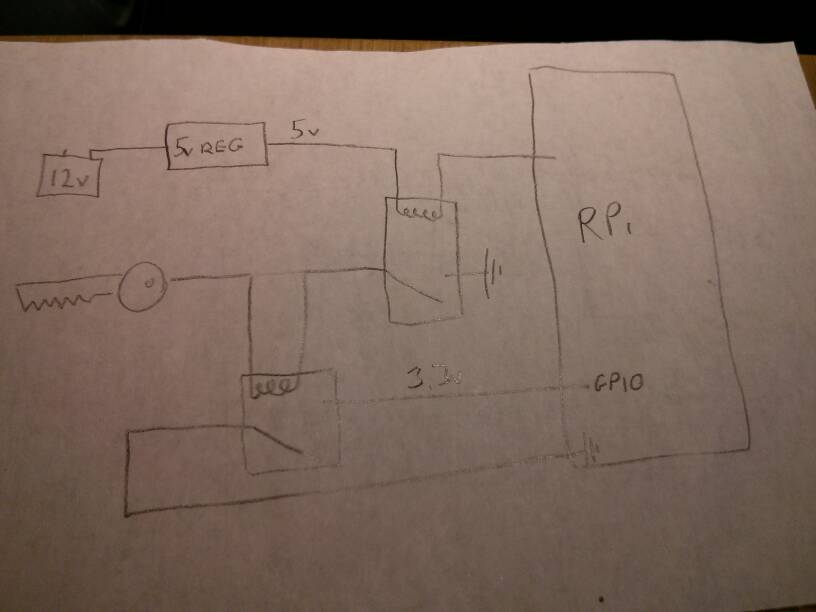

Here's a rough drawing of the power circuit, with relays drawn where the timer and transistors will actually go.
A 12v feed activates the 555 board which provides 5v to power the RPi.
It also closes the shutdown signal circuit running off one of the GPIO pins.
When the ignition is turned off, the GPIO detects a low state and starts a script which waits 10 seconds in case the GPIO reads high again, and if not then tells the RPi to shut down.
The 555 board will keep power going to the RPi for 30 seconds which should be enough time to safely cut the power.

Hit a snag with the 555 and the keeping of power running for 30 seconds after the ignition is off.
So I'm wondering if using a 2F or 3F capacitor would do the trick.
According to my maths, C=(t*I)/V, which would be (30*0.5)/7=2.14 (7V being the drop from 12 to 5 that the regulator uses to convert to 5V.
DIY sphere tool

12V capacitors of sufficient size are an obscene price and seem their target market is the Nova with a big speaker in the boot groups.
So that leaves capacitors in series which reduces the capacity.
To keep a constant discharge time and costs down I plan on using a 7810 voltage regulator to drop the 12-14V down to 10V and then have a line of 4 2.7V 25F capacitors giving a capacity of 6.25F. The drop from 10V to 7V (cut off voltage of the 7805) should be 34 seconds.
DIY sphere tool
Posts: 55119
x 8408
Re: Raspberry Pi anyone?
There's got to be a better way than mucking around with those big capacitors....
Let me have a think...
One way is another 555 time with the required time-constant set to keep the other one alive for long enough..
