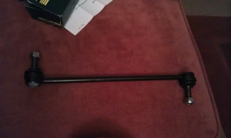

One droplink arrived today
Only £12

Simon, the only source of serviceable balljoints are otherwise wrecked rams that cannot be repaired. Sadly, most can be repaired so truly dead ones are rare. However, I've thought about this and if you look at my website you'll see the balljoint is threaded onto the top of the ram piston and the balljoint is not dis-similar to a beefy droplink end. I reckon it's quite possible to make a new balljoint using a droplink and cutting a suitable thread on the end of it.
I've not tried it but I see no reason why it should not work. You may need to visit a factor and look at a range of droplinks and see what might make a suitable donor.
