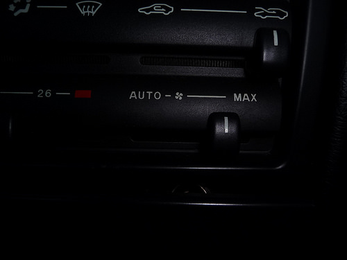

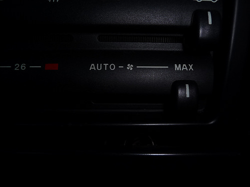

Re: XANTIA BLOWER WORKING INTERMITTENTLY
Thanks for the website. Probably will be little cheap from Ebay.de to fins something.. but anyway - the fan work, and work on all 3 + auto position how it should work. Just the airflow provided trough the front holes is much stronger compared to the flow that can go to the windshield when i select the required position. In short - i suspect that the flap which change that position do not close enough when i need more to described position. Thanks again Nigel.
