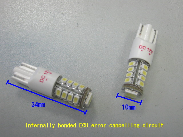

Pair of these arrived today
http://cgi.ebay.co.uk/ws/eBayISAPI.dll? ... 0568709488
They're great!
Interestingly they work either way around in the socket and are of a better build quality, but then we're talking £15 compared to £2-3.
These are them compared to the 9 LED ones.
Tried the 9 LED ones as the number plate illumination bulbs but they're too long for the diffusers to fit, so I'll stick with the 4 LED ones as they do the job perfectly.
So, although they're 3 times the cost of 501s from Halfrauds, they should last a heck of a lot longer, and they're brighter and whiter.
